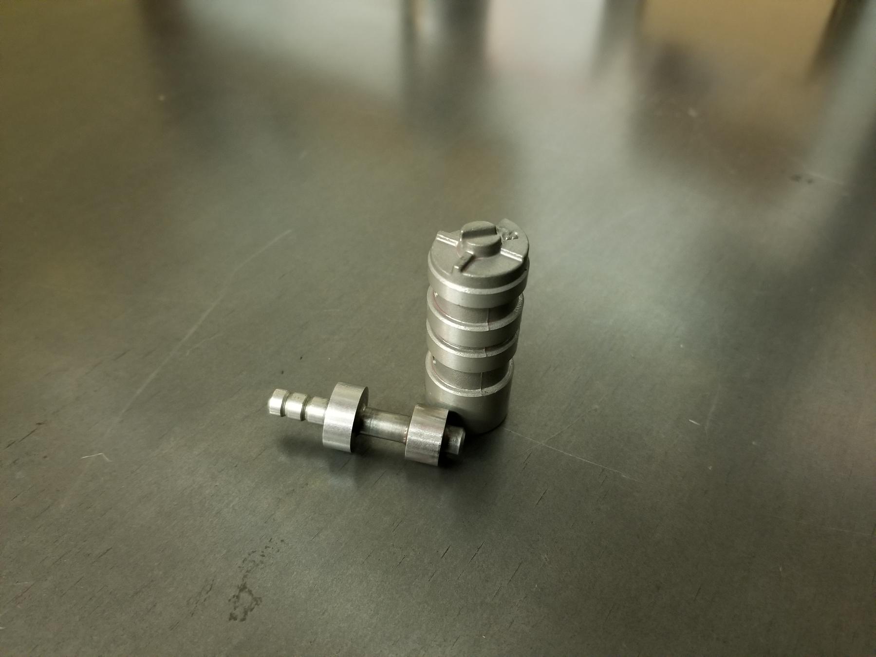

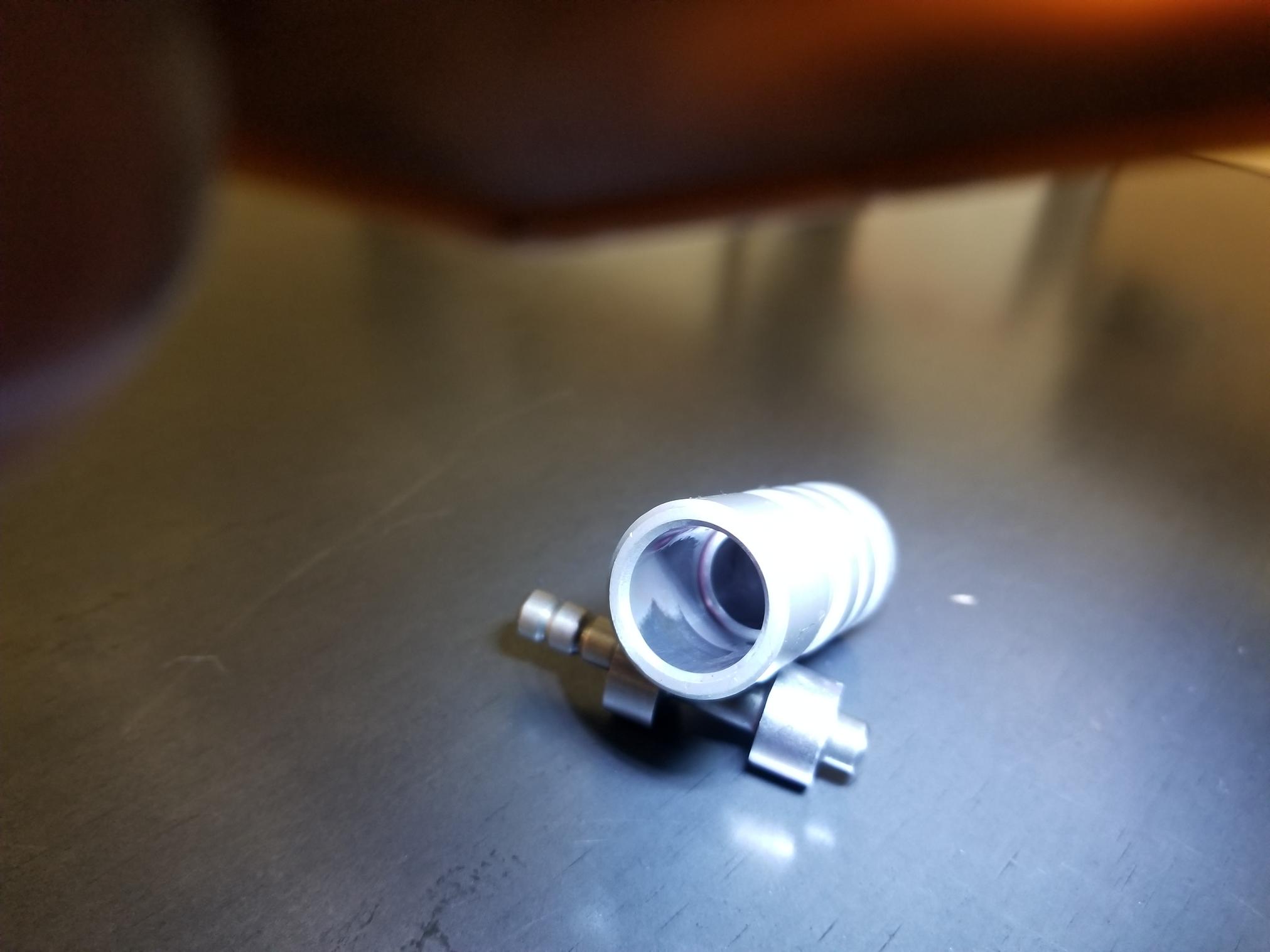

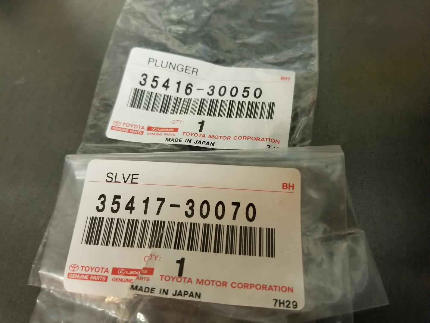

Sorry to bring this back from the dead but I wanted to thank you for doing this write-up, it was very helpful when I installed the reprogramming kit in my 98. I do have a bit of extra info though regarding the boost valve in the lower half of the valve body. After I installed my kit I was amazed at the difference it made. But I noticed that at times the transmission seemed to shift hard sometimes and stock-ish other times. Also the first to second gear change was very inconsistent, hard soft, really hard, normal ECT. I made a call to transgo, and was informed that it was because of inconsistent line pressure caused by an internally leaking boost valve. Unfortunately I had to take it all apart again and replace said valve. The boost valve regulates the line pressure for the whole unit. It is an aluminum sleeve with a steel piston so over time it will wear. Although my 4r has relatively low miles around 180k mine was worn. I finally had a chance to get it changed out and it made a huge difference. Now like the valve bodies there are several variations in design. Two different versions for the type 1 alone. So use your Vin to get the correct one from your dealer. Sonnax makes an upgraded unit but you will have to disassemble yours measure the piston size and order the appropriate kit. I guess what I'm getting at here is if your planning on installing this kit spend a few extra bucks and replace the boost valve.
Part numbers for my particular type 1 VB
Link to Sonnax
https://www.sonnax.com/parts/2745-boost-valve-kit
Thanks again for this write-up. I hope this information helps too.

I may need to do this to mine. In the last month I have noticed that the shifts have gotten a bit erratic. Not much but enough to notice. Thanks for the added info
Mine at time was all over the place at times, now it's super consistent. I have the same VB that you have. Those p/n should work for you. I can run out and measure the old piston is you'd like to try the Sonnax billet boost valve. Thanks again for your write-up. I'm glad I upgraded my transmission.
That would be awesome if you could grab those measurements. I would like to look into doing this soon
