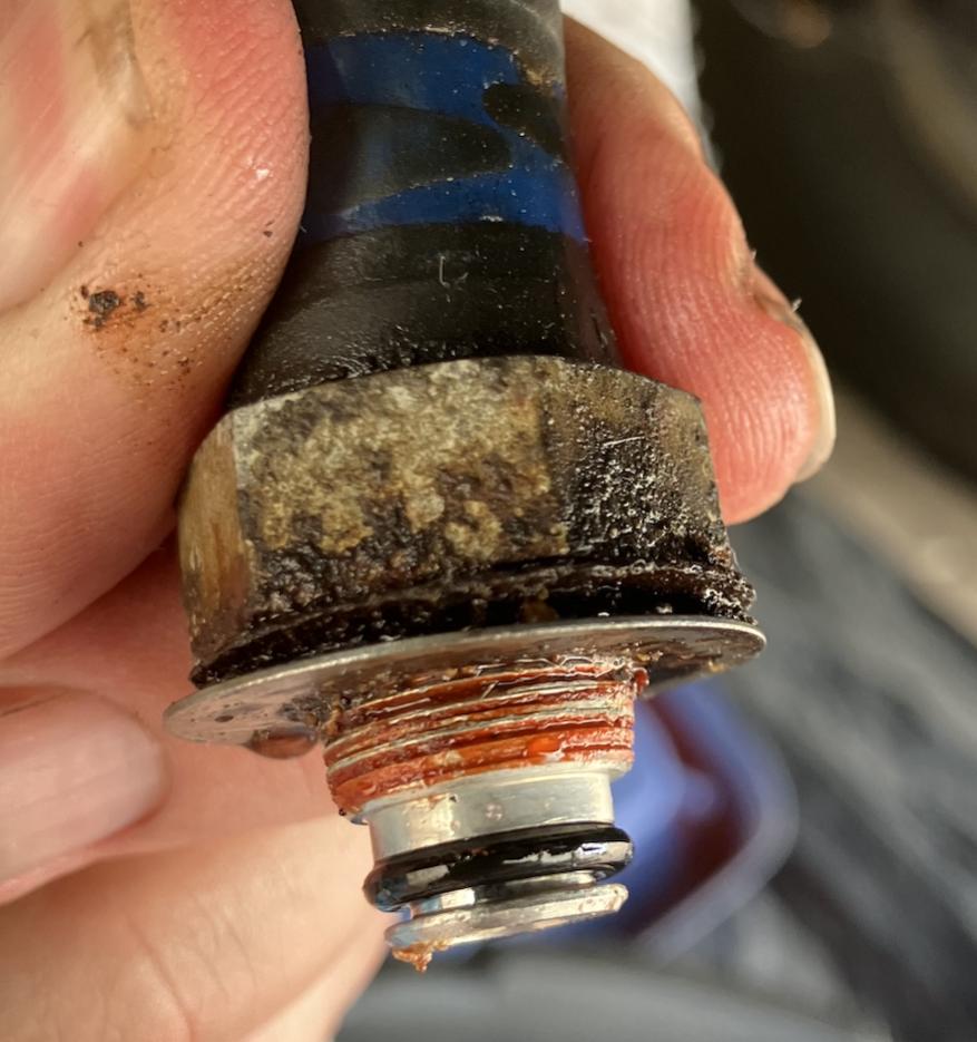

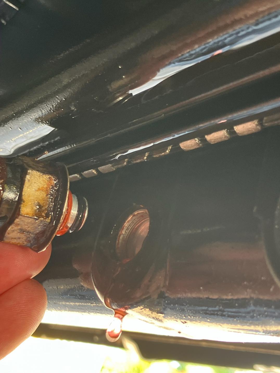

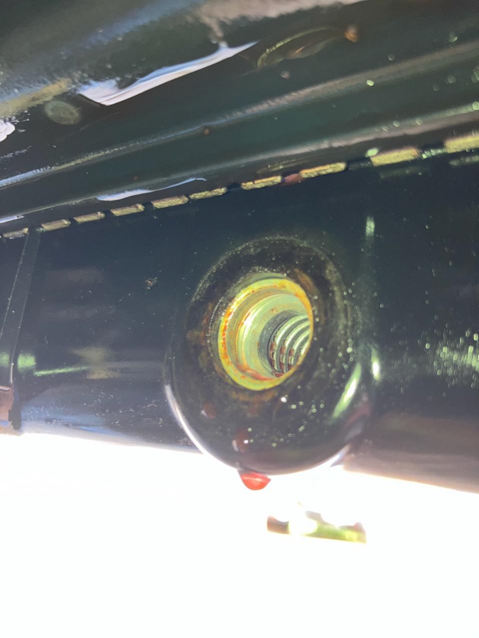

I have an 01 Ltd. The line from the transmission to the oil cooler in the radiator came off of the radiator. It looks like the threads in the radiator stripped. So I bought a new one.
Problem is I haven't been able to find a replacement hose, with the fitting.
I attached a few pics
Can anyone tell me where to find the hose, with the proper fittings?

If you have an 01 as specified you're probably in the wrong place. 4th gen was 03-09.
That said I think we can still help you. The hoses are almost universally just rubber hoses that slip on and get clamped in place somehow. The fitting you're looking for is normally a permanent part of the radiator that somehow has pulled straight out of the rad in your case.
Get some pliers on the metal bit at the end of that hose, grab the hose firmly and twist them in opposite directions till you work the old busted fitting out of your transmission line. Install new rad, stick new or old hose onto the barb, and top off fluids as needed.
