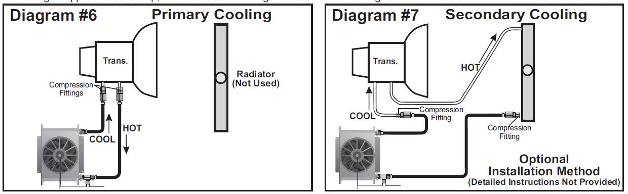

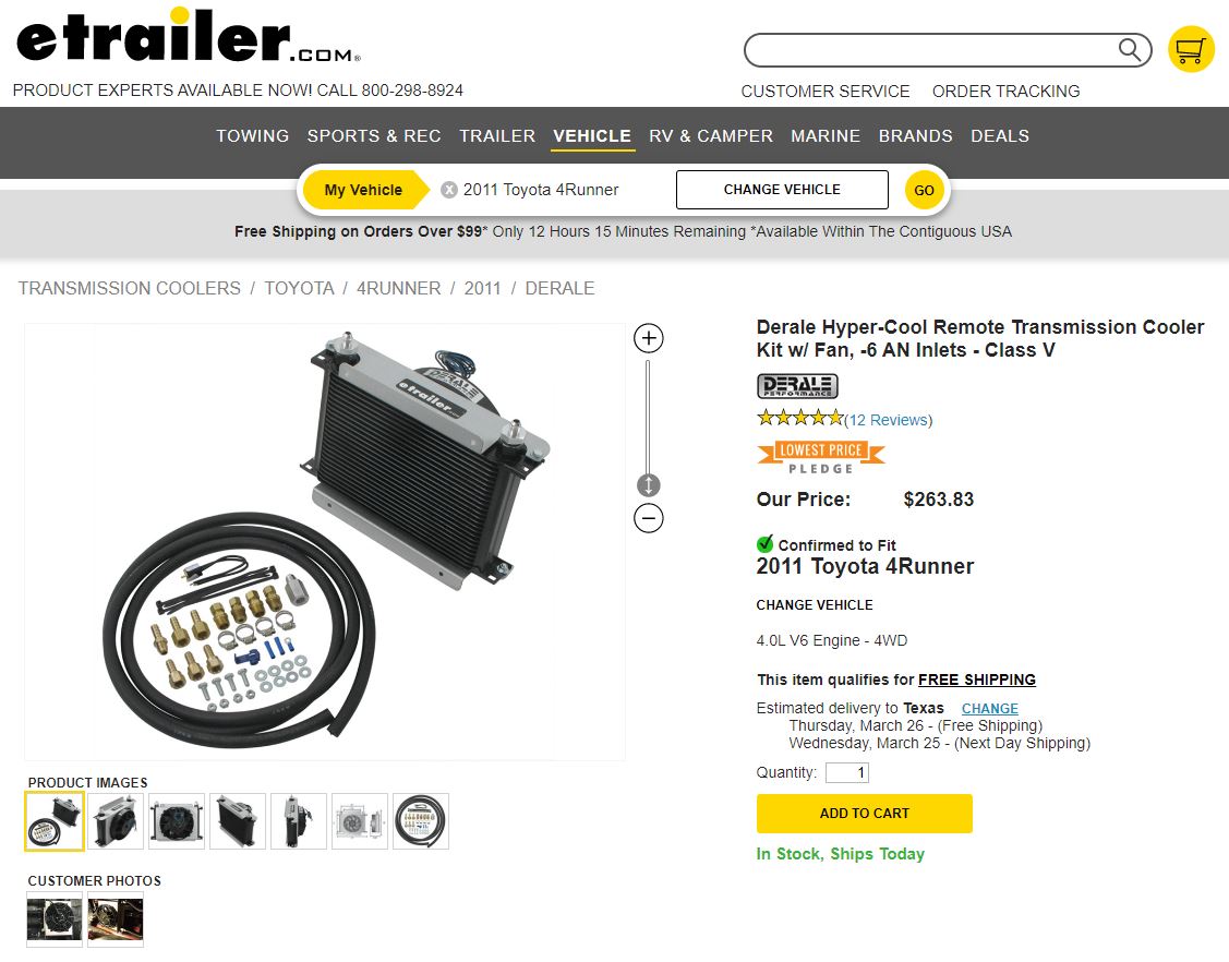

I'm considering this cooler and hosing through the radiator. What are you guys' thoughts... I know there are more expensive units but the budget is a bit limited. I intend to pull 5000lbs from Waco, Tx. to Central Idaho.

I’d look seriously into a tru-cool unit. I run one on my other big motor suv and what these units do to reduce trans temps while towing is amazing. Oh, and they are cheaper than the one you are looking at. I’d contact them for specifics though on your application because on mine I had to exclude the flow restrictor due to the OEM trans already doing what that was trying to accomplish. On my other suv I never see temps over 200 pulling nearly 10k lbs in ambient temps over 100 degrees.
Honestly that looks kinda overkill. You don't really need a cooler with an auxiliary fan on it and it adds a lot of complexity to the install. Just a regular heat exchanger mounted to the front of the radiator would work just fine. The OEM unit on the GX460 is small and simple. Just a bit more cooling than the 4Runner system that is a liquid/liquid heat exchanger in the radiator. (I'm not sure you need one at all).
Lots of 3rd Gen folks use it to'keep their temps down and extend the life of the atf and tranny. I live in colder climate so fig 7 would be my choice. I don't have one on my 5th Gen but have been thinking about it. depending on space available' I like the fan option.
pulled 18 sheets of 1/2 drywall (1000lbs.) on a 2400lb trailer yesterday... In gears 1-3 trans. temp. climbs to 177F and did not level off. The stock cooling isn't going to make it. Trans. fluid is 2 months old.
I don't think it'll hurt anything. The lack of transmission failures suggests that it's probably not necessary. I think the A750F normal operating temp range is 68-230*f. I think the old rule of thumb about temps over 180 probably has no more relevance in modern fluids and transmissions than 3k mile oil changes does to service life. I can't think of a single example on here of a transmission overheating that hadn't had the fluid replaced with the wrong fluid.
I'm sure a cooler wouldn't hurt. Higher tow capacity models with the A750 all have one. Probably more necessary if you have aftermarket skid plates that block the cooling air flow paths designed into the OEM skid plate set.
