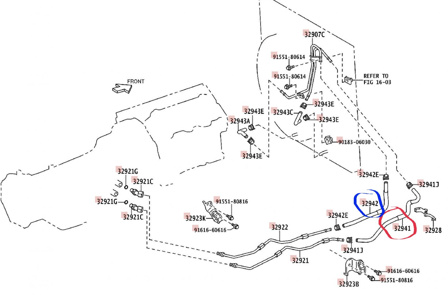

I recently installed the B&M #70274 cooler and obviously had an immediate reduction when pulling 3,500lb TT. However, temps still got up to around 200-205F when TC not locked up on a flat Texas interstate (25mph head wind). Prior to cooler install I had seen 235F on the same highway. Still have some temp concerns when I start pulling in the mountains. Will be doing a drain and fill more often just as a precaution. Have considered adding a push fan for stop and go though it won't help me on the highway.
Here's the 5th gen parts diagram also showing that the more U shaped hard line, that most have the blue mark on, is the right one to tap into.
32921 / 32941 is named 'cooler inlet'
32922 / 32942 is named 'cooler outlet' - where you want to tap into post stock cooling
