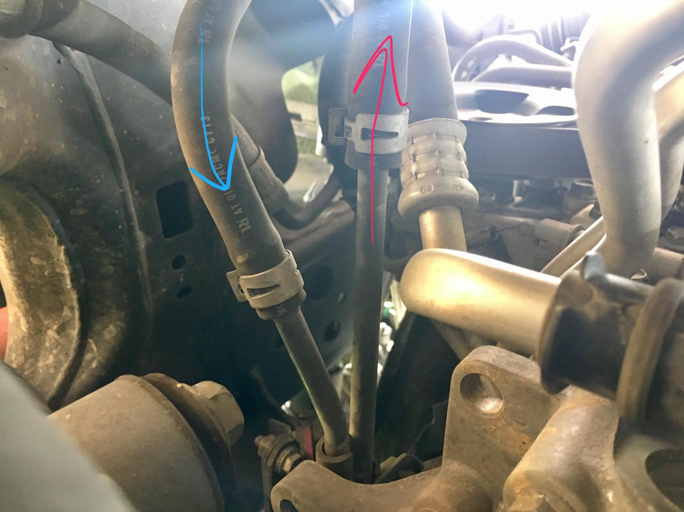

If you are confused about the lines going to and from the radiator, they are marked. The one from the trans to the radiator cooler is marked with red marks (hot), the one from the radiator to the trans are marked blue (cool). The lines connect to the radiator on the driver's side bottom. But you can access them from above on the passenger side, that's where i made my connections.

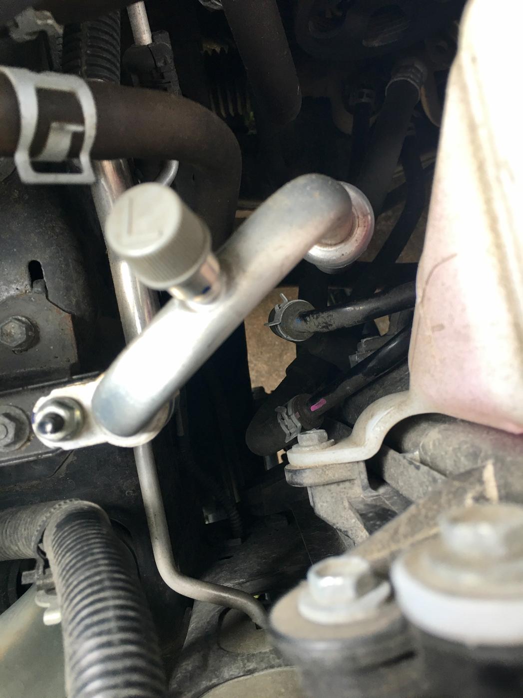

If you look at the pipes coming from the transmission you will see where they change from metal to the rubber lines. One of the pipes is straight and one has an angle to it towards the end. The angled pipe is the inlet into the transmission. The straight pipe is the outlet. Therefore the outlet pipe is the one going to your inlet on the cooler.
Also if you look on the pass side of the transmission you will see where the 2 pipes go into the unit. They are stacked on top of each other. The lower of the 2 is the inlet, the one above it is the outlet.
Hope this helps.
Hope this helps.
That helps a lot, thank you!!

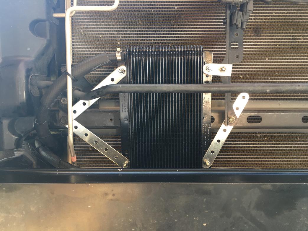

B&M Install - Hardmount
Installed the B&M trans cooler using the hardware and existing points on the AC rad and center support. I had to use longer bolts into the mounting points due to the extra thickness of the brackets, and a spacer for the top right (cut) bracket due to the offset. Initially I had the top right (cut) bracket mounted asymmetrically to the bottom - in a diamond/V shape, but that allowed the cooler to wobble back and forth, hence the cut bracket mounted horizontally to the vertical bar. I used extra lock washers and thread locker and extra zip ties for redundancy. It lays up against the backbar perfectly, and I stuck the foam padding against it for abrasion resistance. Setup is super rigid. My only fear is the hardware vibrating loose. An extra benefit is this mount puts the cooler further forward and gives much better routing angles for the hoses. Also doubled up and zip tied the hoses after routing for abrasion resistance.
Up top, my hoses were marked correctly for hot and cold. Tested multiple times with multiple ppl (there and at trans hard lines. If your trans is warm like mine was, you can start the engine for a few seconds and feel the hot ATF warm up the lines. I tapped from the cold line up top down to the bottom of the cooler and from the top of the cooler down to the cold hardline into the trans. The hardline that's kicked out from the transmission is the cold return line into the trans, and the straight hardline is the hot out line into the rad. As I'm writing this I probably should have bypassed all that snakework of intermediate hardline on the rad shroud.
Using ScanGauge trans temp is pretty stable at high 150-160s while coolant is 180s cruising on a 90 mile drive. Ambient was low 90s. Trans temps are 20-30 deg less than coolant and never got as hot or hotter than coolant like they used to. Used to see spikes into 200's from trans going up and down interstate hills, and now maybe 180s.
