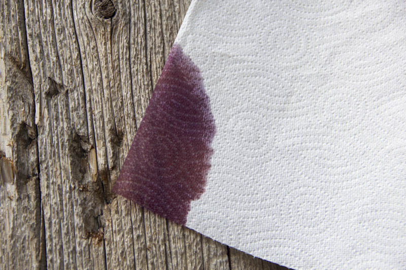

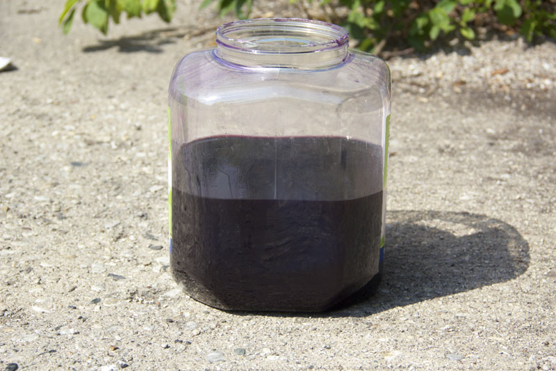

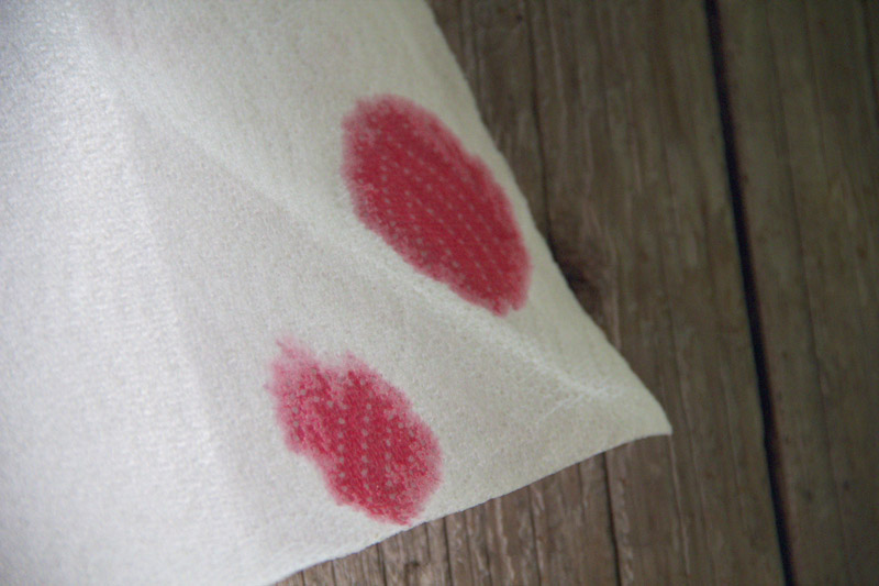

All done. Everything went smoothly after all and put we put a little over 3.5 quarts in. Anyway this is what the old fluid looked like. At 100k miles and towing a 5000lb boat, it is a good thing we changed it. 1) old 2) old 3) new
