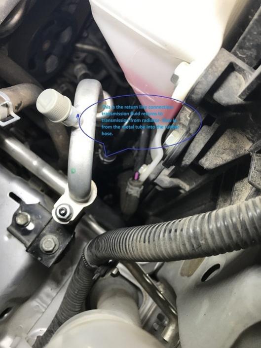

1) I have spent some time making sure I am selecting the correct (return) line to be used for the drain of old the fluid… in my 2013 4runner (and I would believe it would apply to all 5th gen) possibly best connection for that is located near the top of the engine bay next to radiator expansion reservoir (see attached picture below). I have disconnect rubber house at that connection and attached 3/8" ID vinyl hose to the metal tube for the drain (I have also plugged the rubber hose for the duration of the process-not sure if that is needed or not).
Toyota actually marks that return line with blue paint (that is the one you want for drain!) and marks the line going from transmission to radiator with red-which is very nice indication of what each line means.

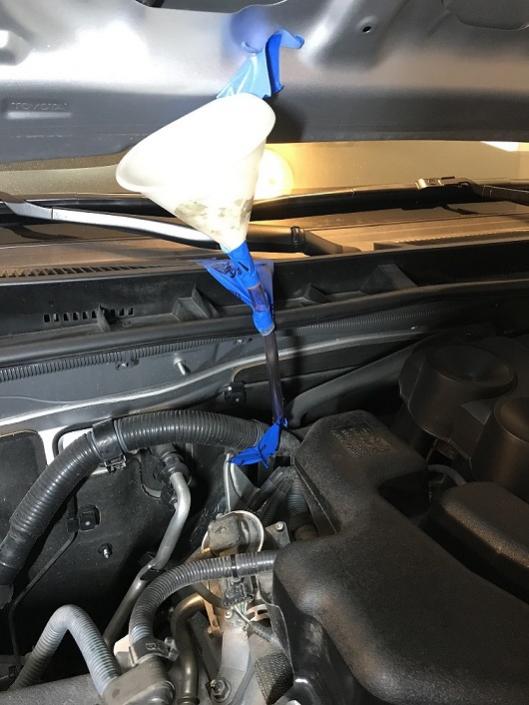

2) I have used "gravity feed" method to fill the transmission with new fluid instead of “Fluid pump”, I have routed 3/8" vinyl hose from the engine bay to the fill location on the transmission (make sure the vinyl house is not touching part of exhaust system) and attached small funnel on the top (see picture)- that made the fill process very easy and fast!

Gravity-fed system is simply the cleanest and easiest method. Used the same funnel and hose for rear diff and probably gonna use the same for transfer case and front diff as well when the time comes. Don't worry friends, I clean the hose out real good to avoid cross contamination.

Anything wrong with using the sending line (trans->radiator) instead? I can just as easily disconnect that line and point it straight into a bucket.

You certainly can, but if you use the return line then you'll also be flushing all the old fluid in the radiator/trans cooler. No sense leaving all the old fluid in there IMHO.
