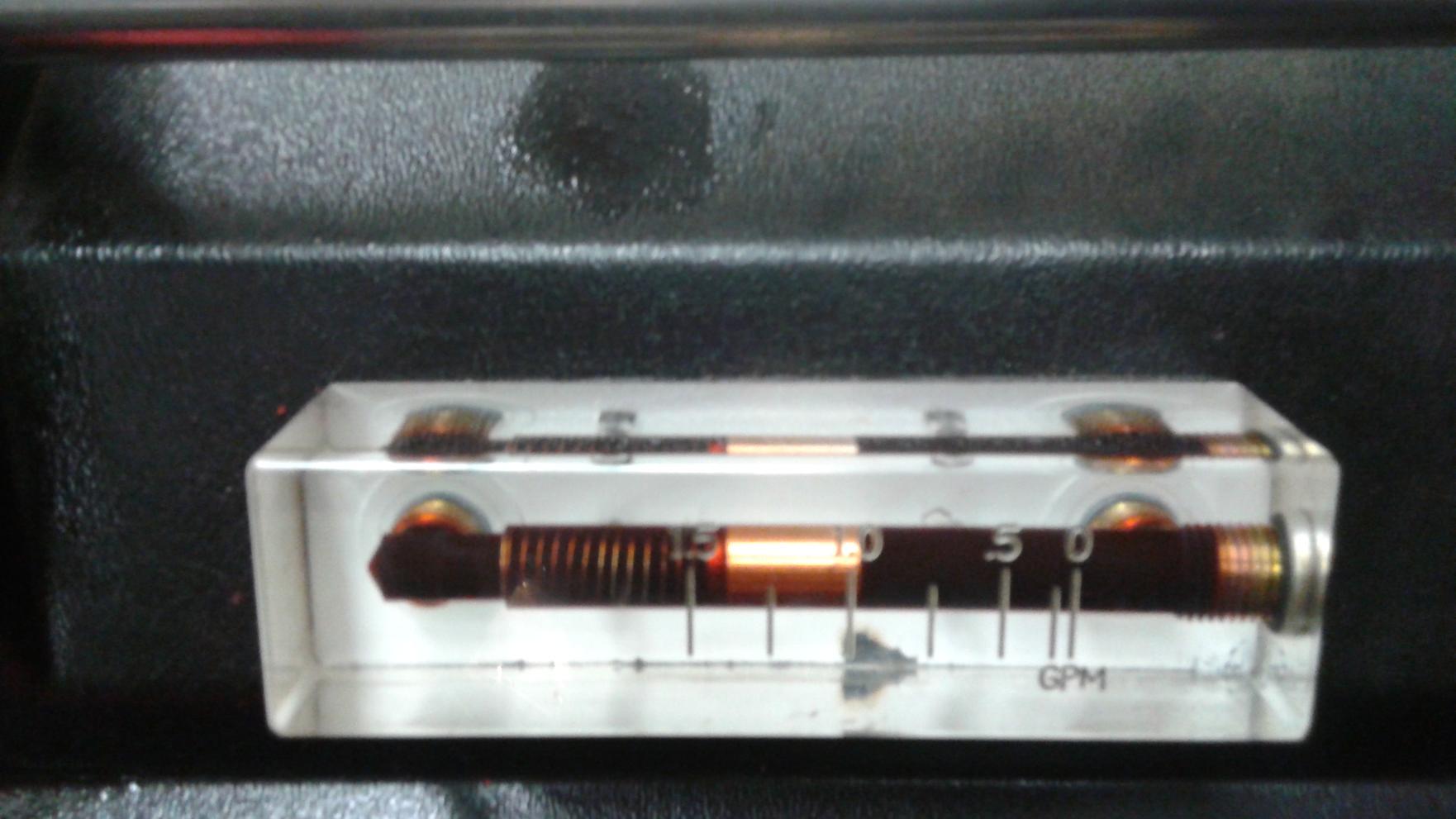

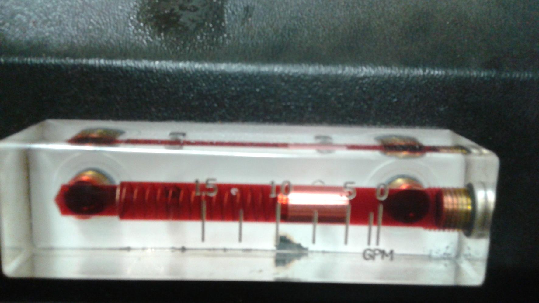

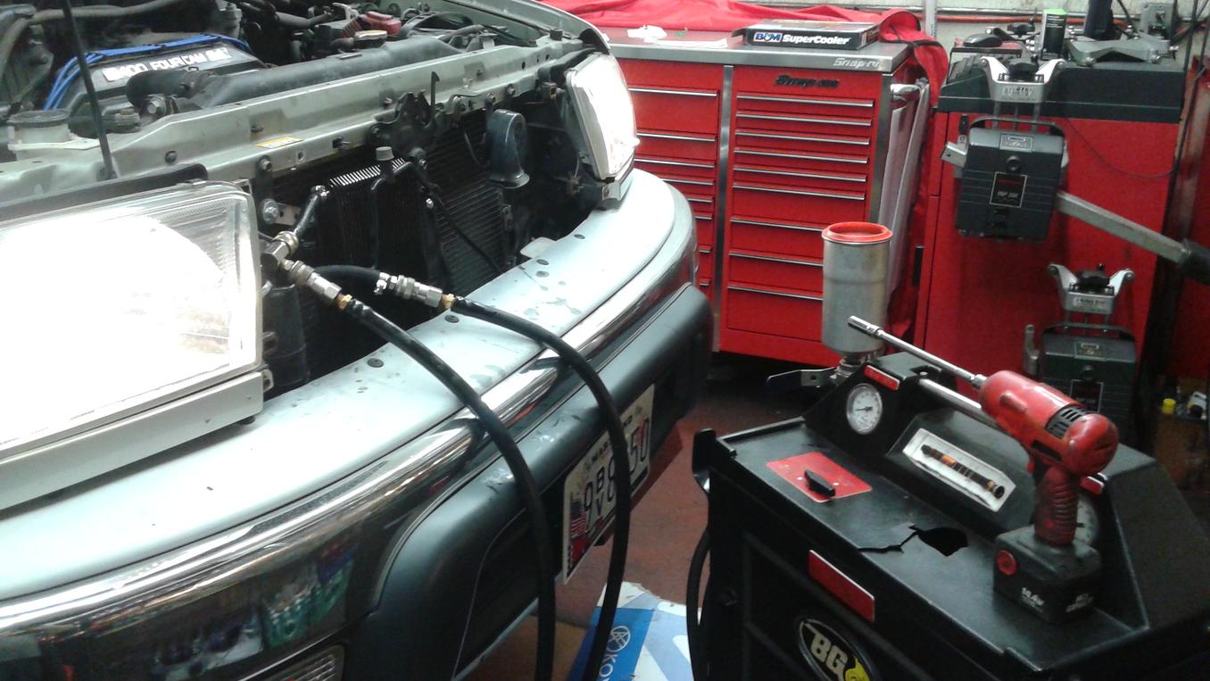

At work we use the BG trans fluid exchange machine. This machine runs off of the trans own pressure, no added pressure that could disturb internal parts. The new fluid simply pushes out the old fluid. I've used it on my own vehicles for years and customer's vehicles with well over 100k miles and i never had a trans issue after a fluid change. Pictured is the fluid before & after on my 02 4runner. With this machine there is a sight glass and you can watch the fluid go from being black & nasty to new.
