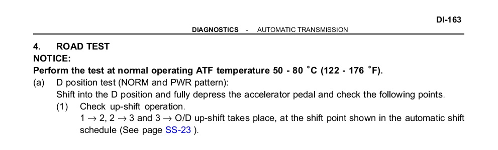

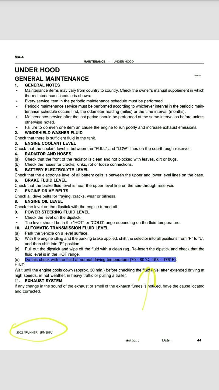

The normal operating temperature of the transmission fluid, according to the FSM is 158-176 degrees Fahrenheit. It takes me about 20 minutes of stop and go driving to get up to 160 (it's about 40 degrees in WI right now).
My coolant temps get up to 190 in about 5 minutes of driving.
Which FSM year is your info from? The range you have 158-176 is pretty narrow.
Here's the FSM pic I have saved
Sorry for the late response on this, I can't remember which year my FSM is for.
The temp range I quoted is actually the "normal operating temperature" for when you are checking the fluid level on the dipstick. Let me see if I can find it.
I think I've seen the same numbers you listed in my FSM also but in a different section.
I prefer the signature series from Amsoil. It's very good stuff IMO.
My pic is from the 2002 FSM as well...? I guess "normal operating" and "normal driving" are two different things...?
