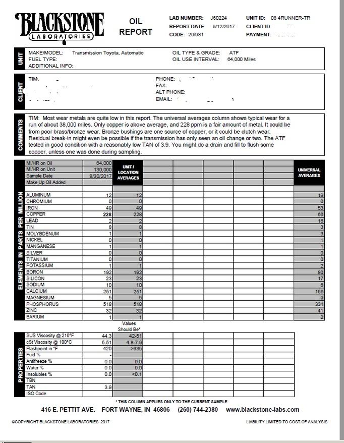

Hey all, did a report on my tranny fluid.

What's your total mileage and transmission service history?
And what do you make of all the copper?
Great Question!
It is a 2008 v6 auto with a 130k miles total.
Trans fluid was serviced at around 60k by a Toyota dealer. In the dealer description I pulled up (I was not the owner at the time) they noted it was dark and used 12 quarts of fluid so I assume they did a flush.
If you read Blackstone's report description they said high copper could be worn bushings, clutch plates, or something from break-in. :noidea:
This is why I posted up, thought maybe someone would chime in with more knowledge of the tranny.
I took this sample almost by chance... I had everything ready to do a flush (just by using the trans fluid pump and a hand pump) and first decided I should check the level first.
Upon checking the level I found the trans fluid spewing out, so I tightened the overflow bolt and got a sample jar. Filled the sample jar (about 5 oz) and then proceeded to let it flow to a trickle as stated in manual.
I estimate I got about 1-1.5 quarts until it was slowly flowing out of overflow.
At this point it seems to be a no brainer, I am going to complete the flush I intended to perform. I may overfill a tiny bit so that at around 38k-60k I can take another sample to compare to my initial sample report.
AuSeeker, Blackstone completes these tests for $28, I added an additional 10 dollar test to get a acid reading (TAN for transmission). Check out their website and give them a call if you have questions. I actually called in to tell them my plan and ask about TAN, first had a helpful admin who then transferred me to a lab tech.
https://www.blackstone-labs.com/
They will even ship you a free test kit, I just used a similar glass sample container I had lying around at work.

The "Universal Averages" are a little bit different, not much, but still different on some of the metals on the OP's report compared to yours, wonder why that would be?
I wouldn't think this would change from one report to another using the same transmission fluid, unless one of you does use a fluid other than the WS fluid.

I don't understand how this helps without a side by side result from brand new unused oil as baseline comparison?
or is that easy to find online somewhere, and if it is then why doesn't the report show these baseline new foil vs what was found?
I mean, when I look at a report like this it tells me nothing because I have no idea what the "healthy" numbers should be vs "bad" numbers

Good question Keakar, I will try to answer it.
New fluid should not have any of the metals or contaminants listed with values in the lab results. So baseline would be 0.
For fluid properties, the baseline for new fluid or acceptable ranges are detailed in the left column (viscocity, flashpoint, etc).
One factor, the total acid number (TAN), would be the only one that I am not positive what new WS fluid would have.
Another good question that I will email to Blackstone. I would take a guess that either they need to get consistent on baselines, or that they simply have more data on averages at this time compared to a few years ago.

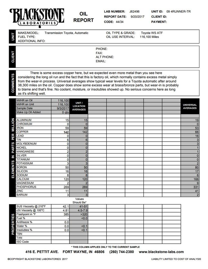

I did a full flush on transmission oil over labor day weekend and sent out some sample for analysis as well. Here is the result.
I am pretty sure this is original fluid from the factory, unless the previous owner replaced it before I got it at around 36,000 miles. I also got high copper content, but I don't think there is anything to worry about.
