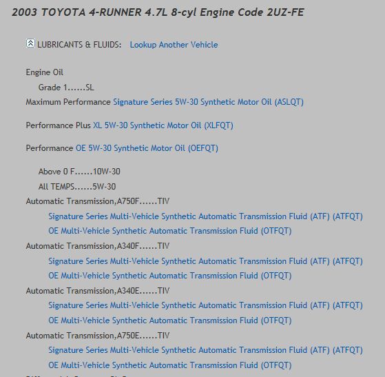

'03 will use TIV transmission fluid.
Top Shelf,
Thanks for the chart. Mines an 8 not a 6.

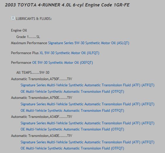

No problem, anytime! I'm showing TIV for the V8 as well. '04 is the first year I'm showing WS is recommended.
Thanks again! I was scratching my head over this as I was being told one thing when the book says another.
