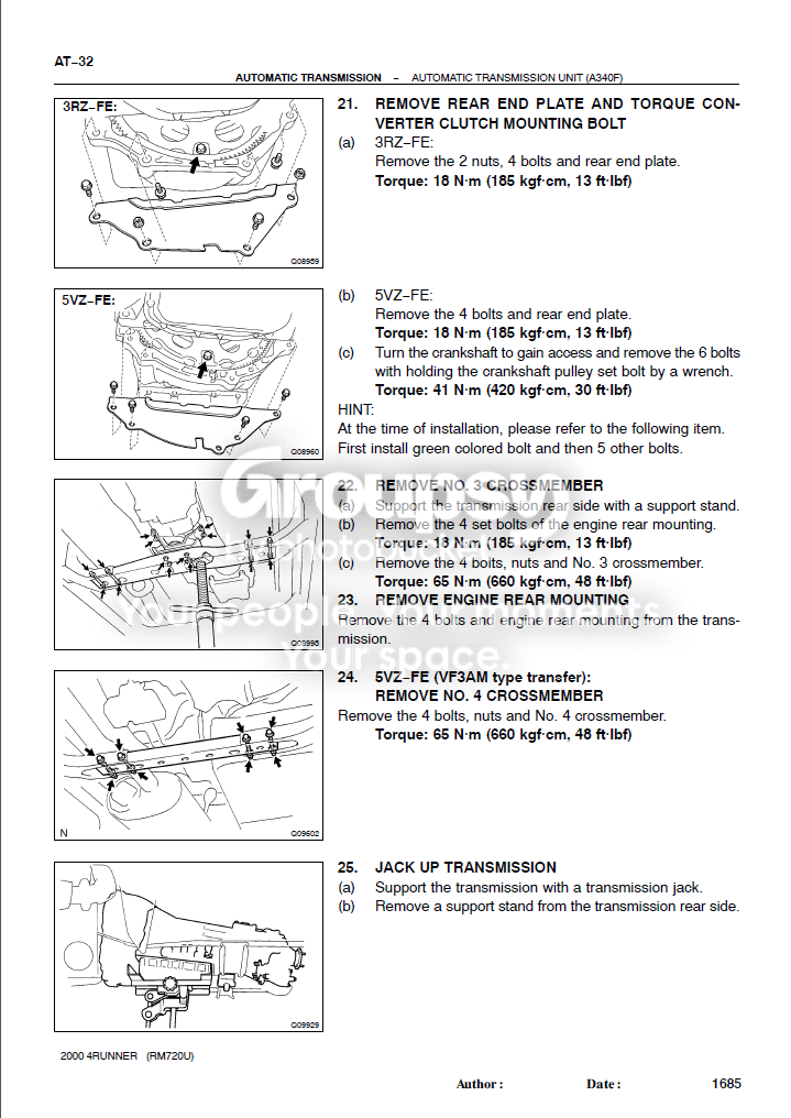

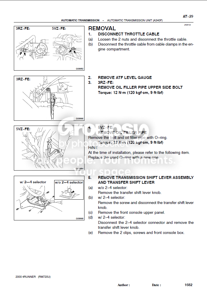

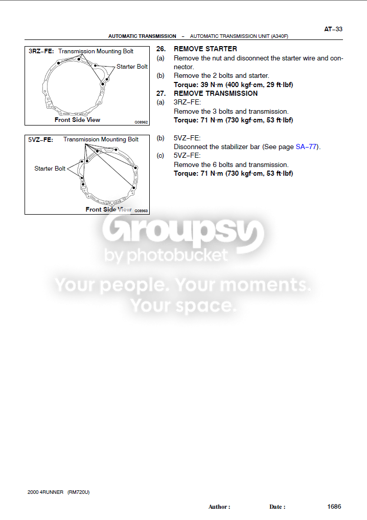

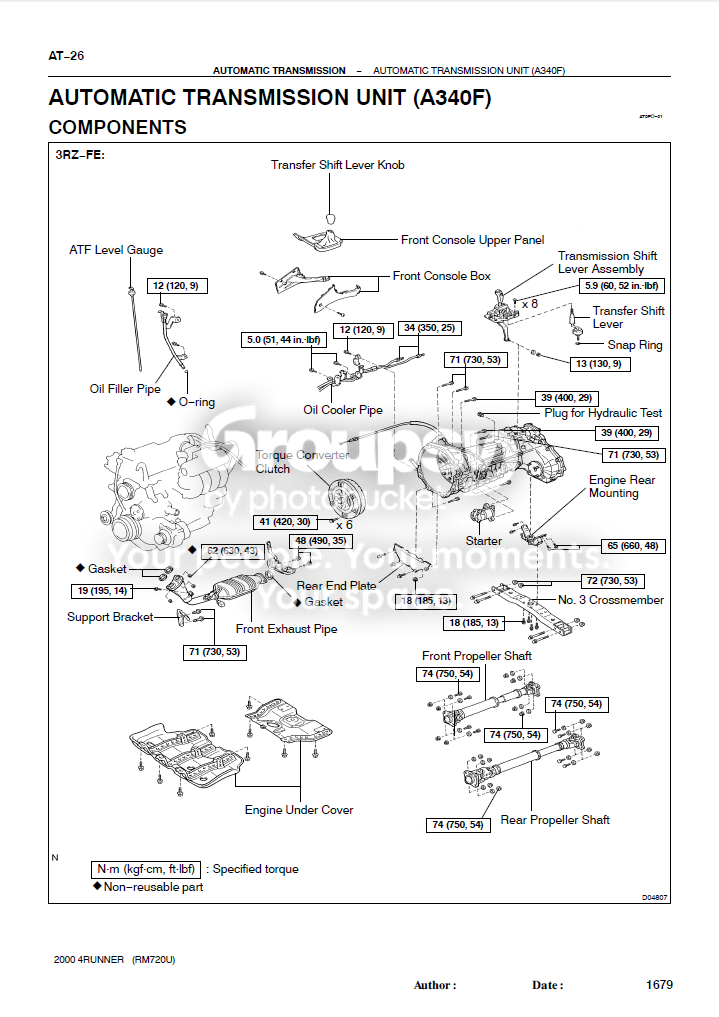

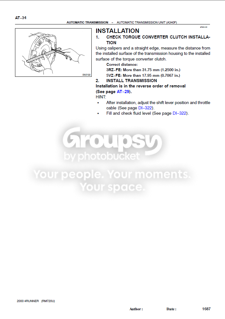

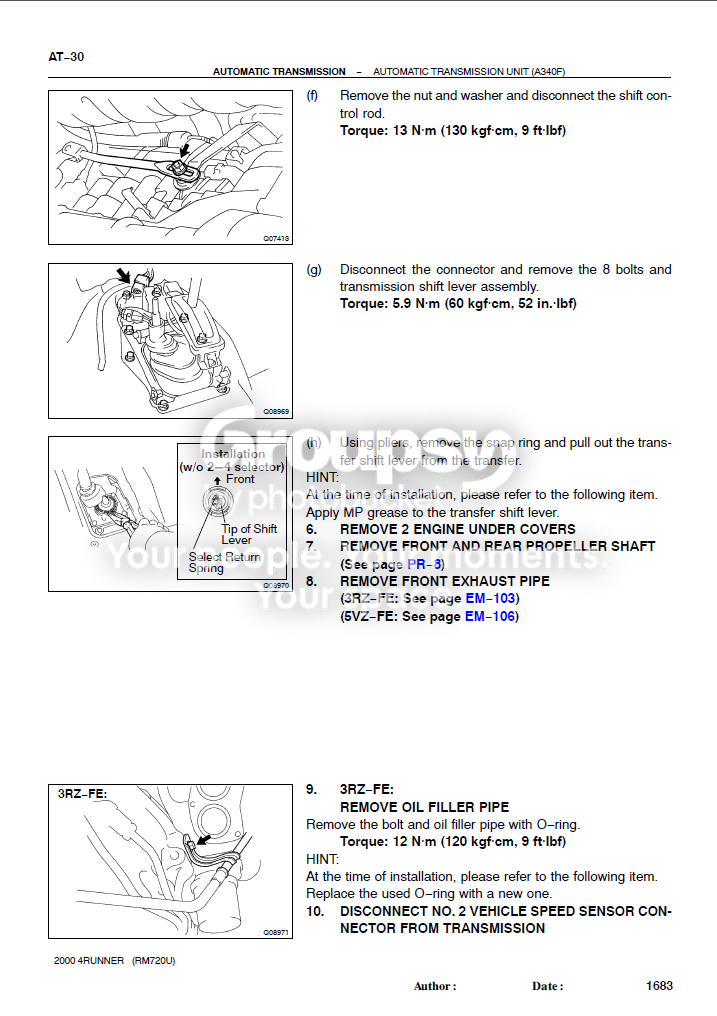

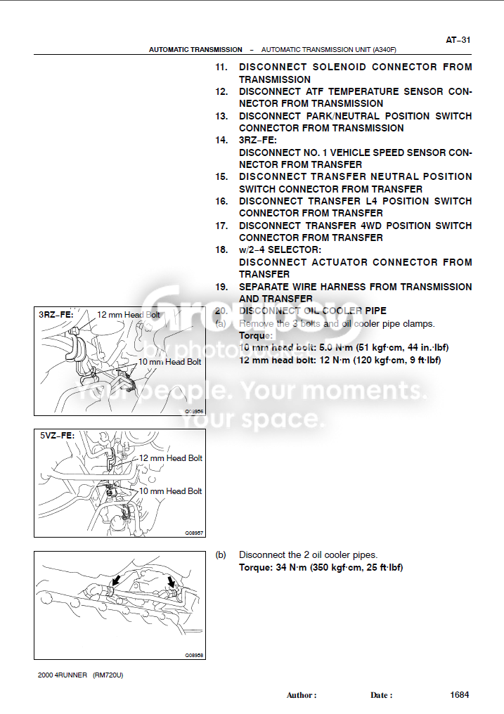

If you lived closer I'd tell you to bring it by. I've pulled mine twice in the past month and I'm starting to feel like a pro. Here's the FSM pages. It's pretty straight forward and this is what I used when I did mine.

This is great. What did you do about flushing the AT fluid?

Pull the drain plug.

You're going to need 12mm for the transfer case bolts, 17mm for the bell housing bolts, 14mm for the cross member bolts, and, IIRC, 13mm for the TQ bolts. There's a couple 10mm bolts on there as well.

Here's the components list if you want more torque specs.
