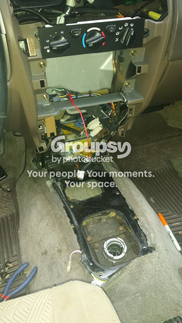

Just as long as I'm on the road by Monday that's all I care about. Last night I was able to get all the linkage removed, and shifters out. I started soaking the bolt in PB Blaster, and I'll hit them again tonight. If I have the transmission out by Saturday morning I should be in good shape.
Made a little progress last night, but better than nothing. I have to let some of the bolts soak in PB Blaster before I even try to get them off.
I went ahead and removed the radio since I have a nice little gadget to install.

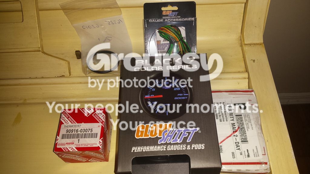

Glow Shift transmission temp gauge, OEM thermostat, and o-ring.

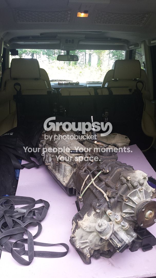

The donor.
