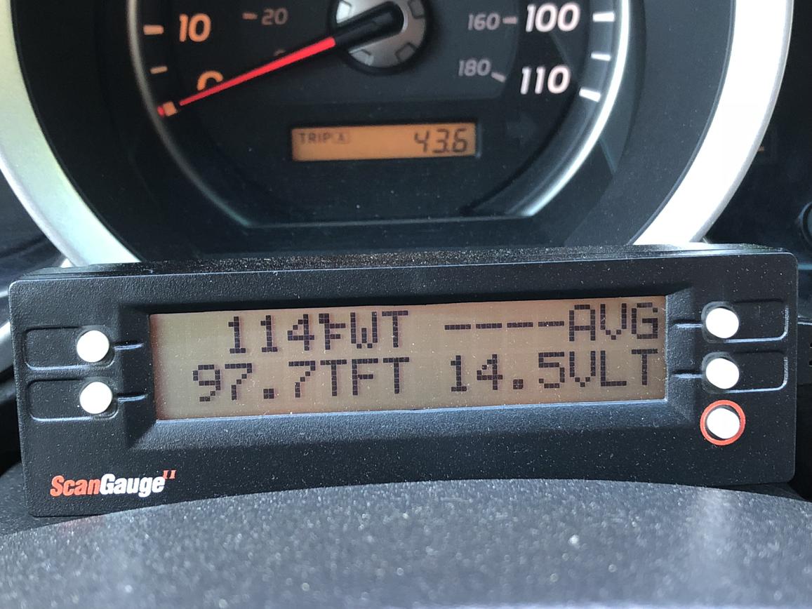

Drain and fill is very easy to do yourself. The transmission is not actually sealed (it has a breather line) and the only difference is that it does not have a dip stick. The easiest action is to do a fluid level check. If that's good, then do a drain and fill. The transmission fluid temperature needs to be between 95-115F before removing the overfill bolt (5mm Allen). It's very easy to check the temperature with a Scan Guage2 but you can also jumper 2 pins on the OBD2 port to see if you're within the correct range. The so called "lifetime" fluid was a misguided name.
Here’s the transmission temperature (TFT) readout on a SG2.
