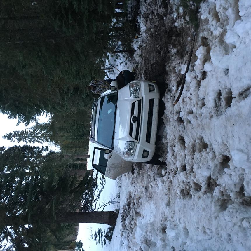

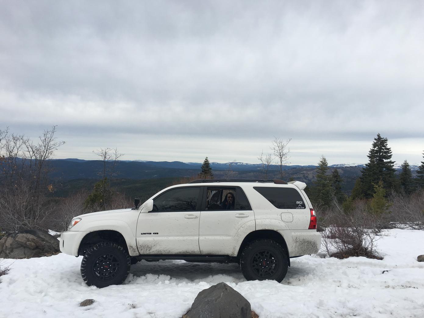

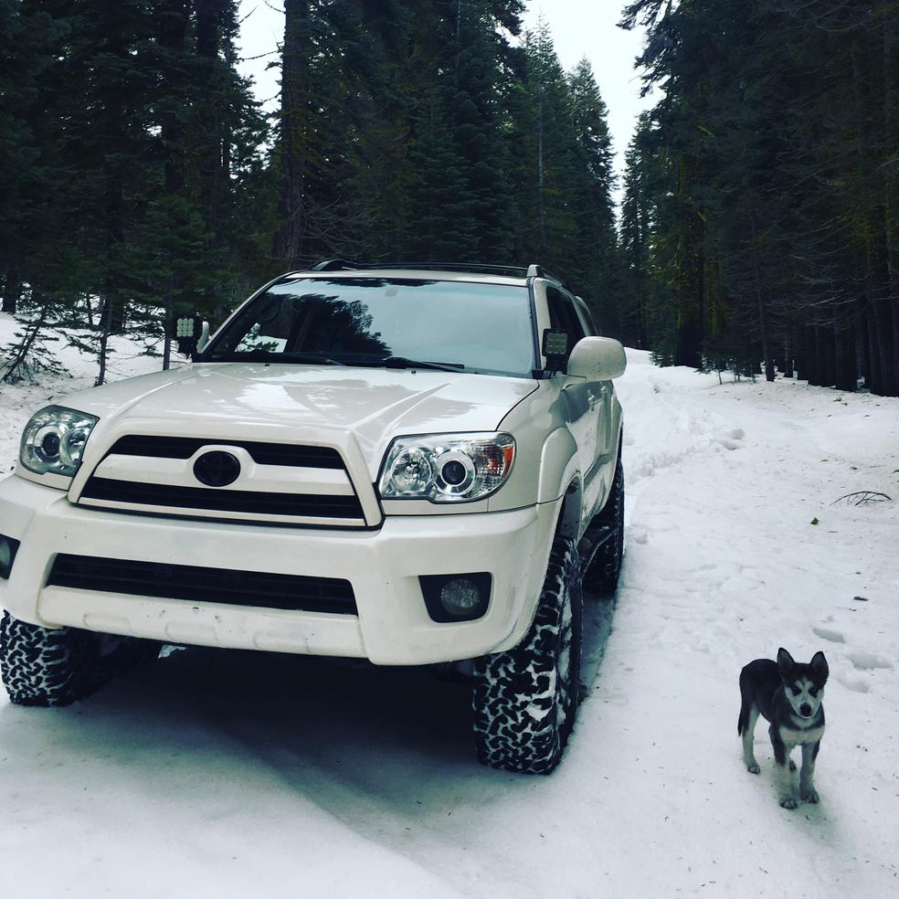

Factory new replacement. $2700 and some change. It does feel like I'm driving a different car. It is under warentee now so I will enjoy it to the fullest. First day back we hit some trails.. why I was concerned about a "break in" period even though I had never heard of such things for a transmission.
