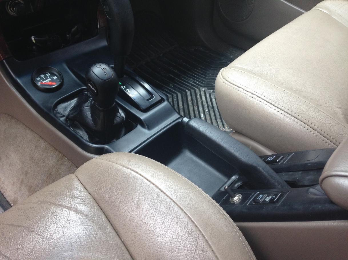

I use an AutoMeter 2640 hooked up to 2 senders in my '97.
One sender is in the return line right after the oil cooler and one is in the send line right out of the transmission.
The ON/ON toggle switch near my parking brake handle is what's used to switch between the two readings, but I typically just leave it on the Send line reading.

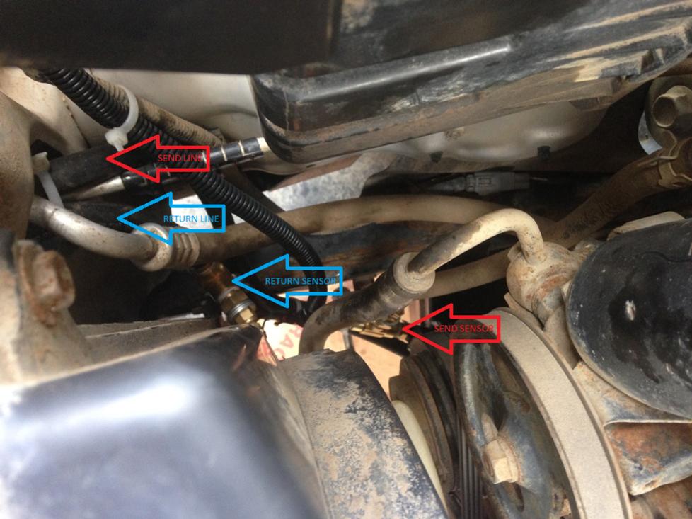

I wouldn't think it's necessary. I have mine installed as close as I could to the end of the metal line. I attached about 6 inches of line from there (just enough to clear the crossmember) and then installed my T fitting with the sender from there.
For my return line sender, I installed it in the same fashion, but as close as I could to the cooler, but right after the Rad firewall (so as early as I could to where the return line comes back into the engine bay)
