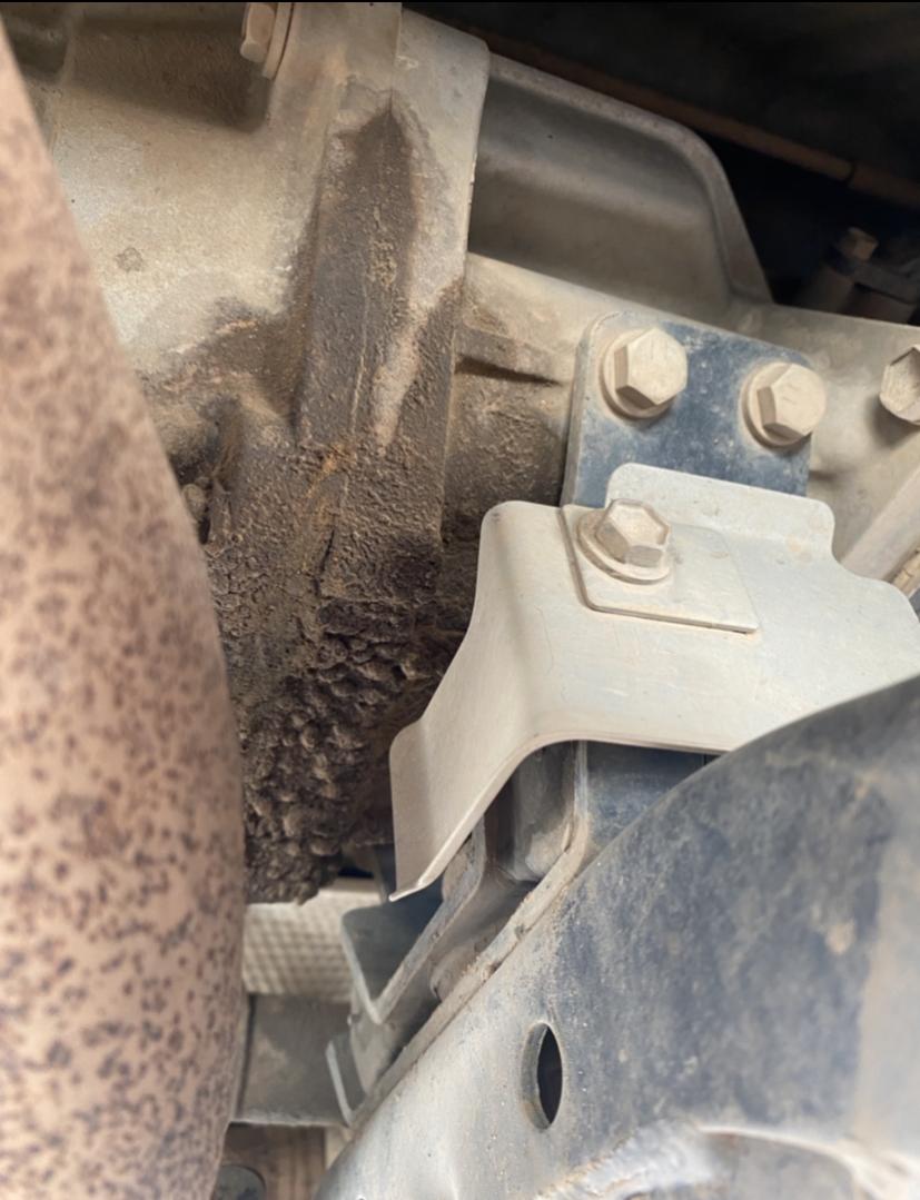

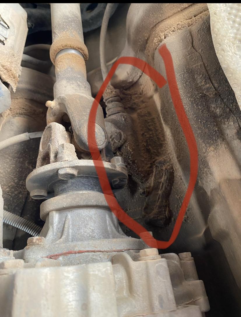

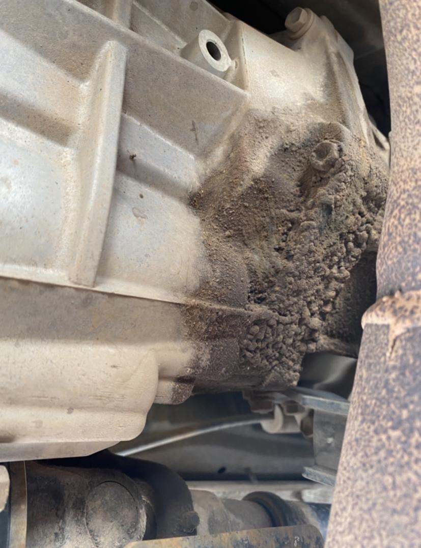

I crawled underneath today and noticed 2 wet spots. One on the transmission and another behind it. I live on dirt roads so dirt is clumping around the wet spots.
Is this a concern? Is it something that should be fixed ASAP?
Thank you.

Try wiping it clean and checking after a couple days. To me, it just looks like grease splatter from your drive shaft since there are two zerks right there. Tranny fluid isn't as thick to make clumps like that and if you haven't taken it apart is is unlikely that it would develop a leak.
