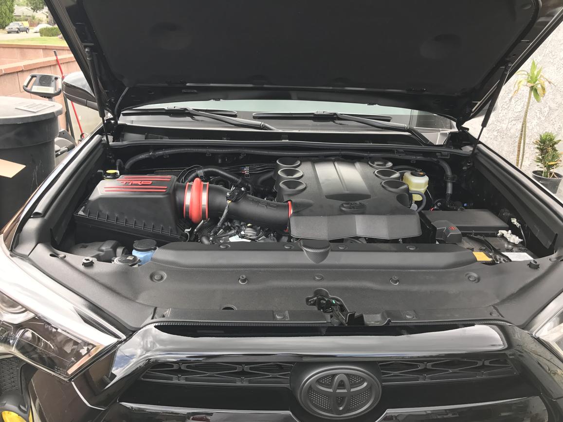

Fits perfect on mine.

Toyota rarely changes anything...
Pretty much anything that fits a 5th gen fits 2010-?
In fact 2003 4runner to present share many things mechanical. 15+ years of the same basic truck.

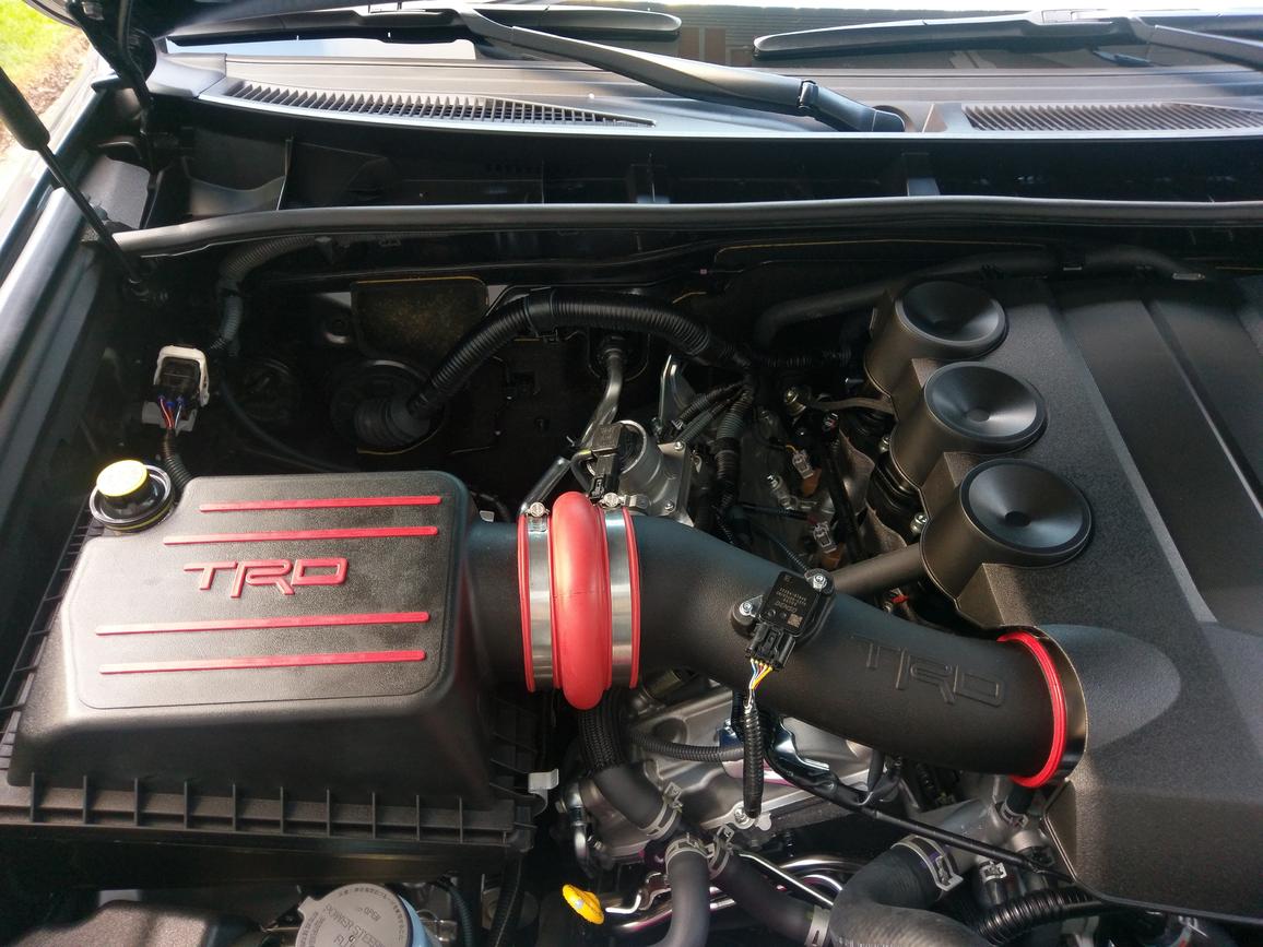

Fit perfectly fine for me also. Just installed it couple days ago. Only thing I noticed was that one of the 12MM bolts that hold down the filter box was too long, so I just added a .25" spacer/washer and it was fine.

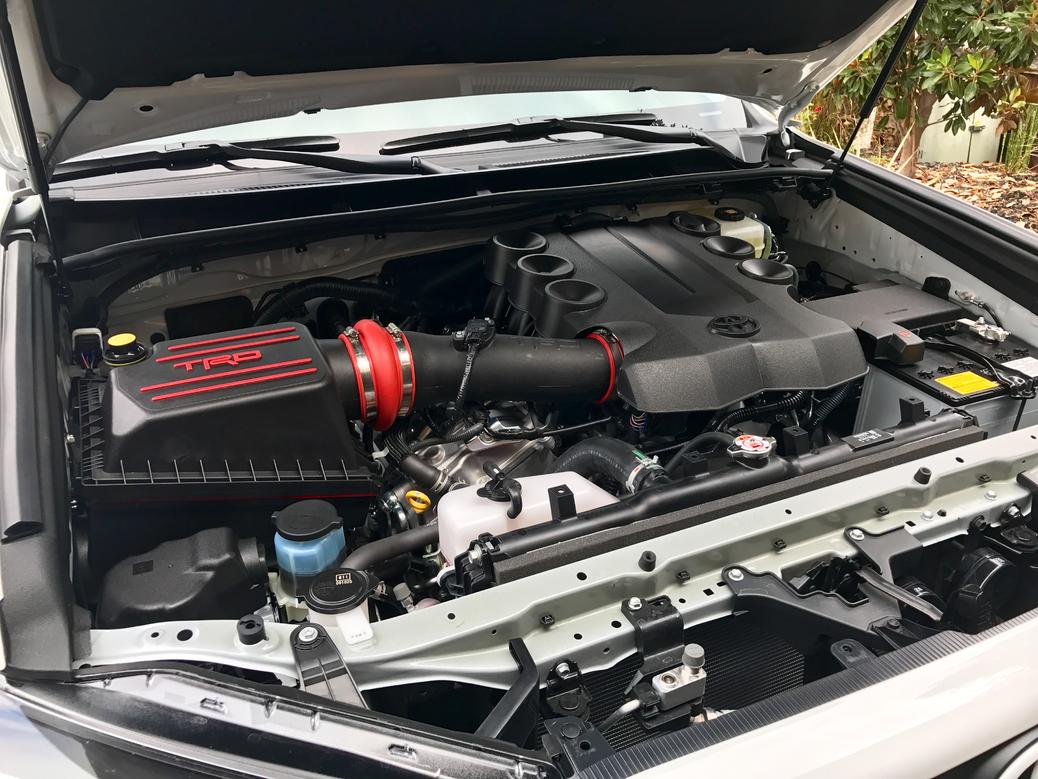

Had no real issues installing on my 2017
