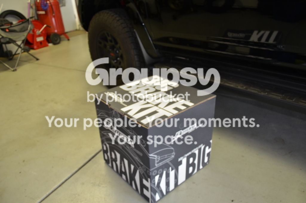

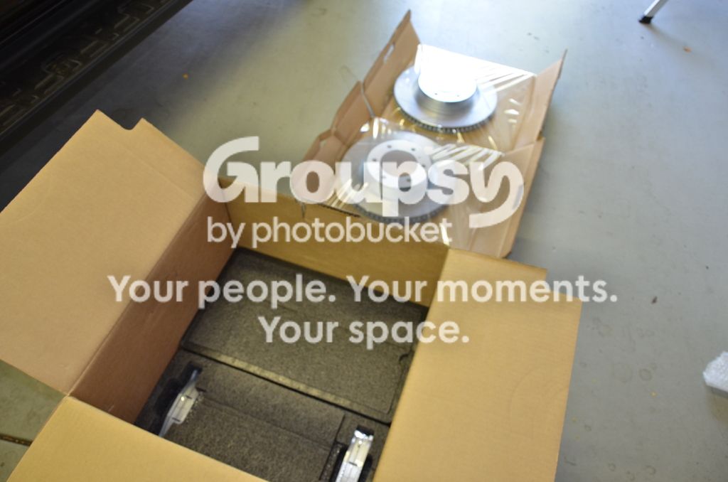

Unboxing

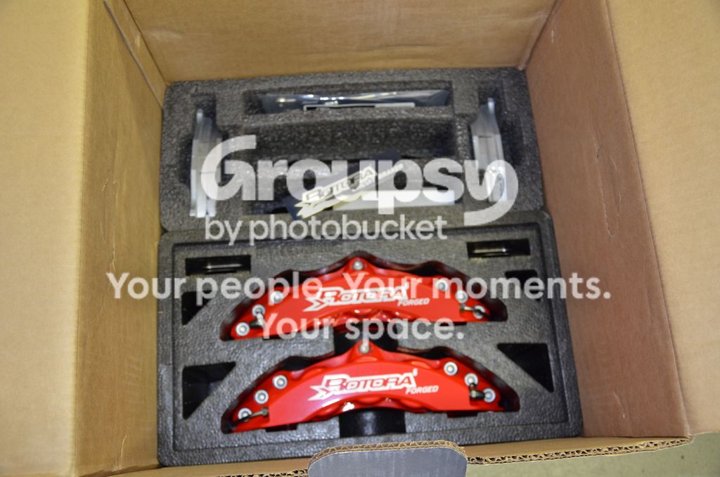

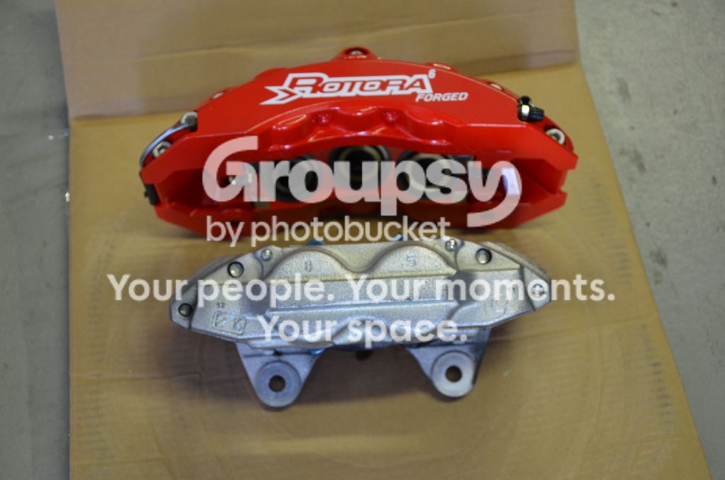

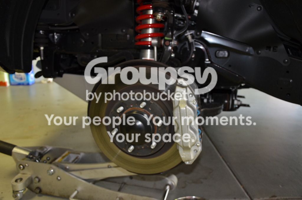

Nicely packed Rotora 6 piston with slotted rotors

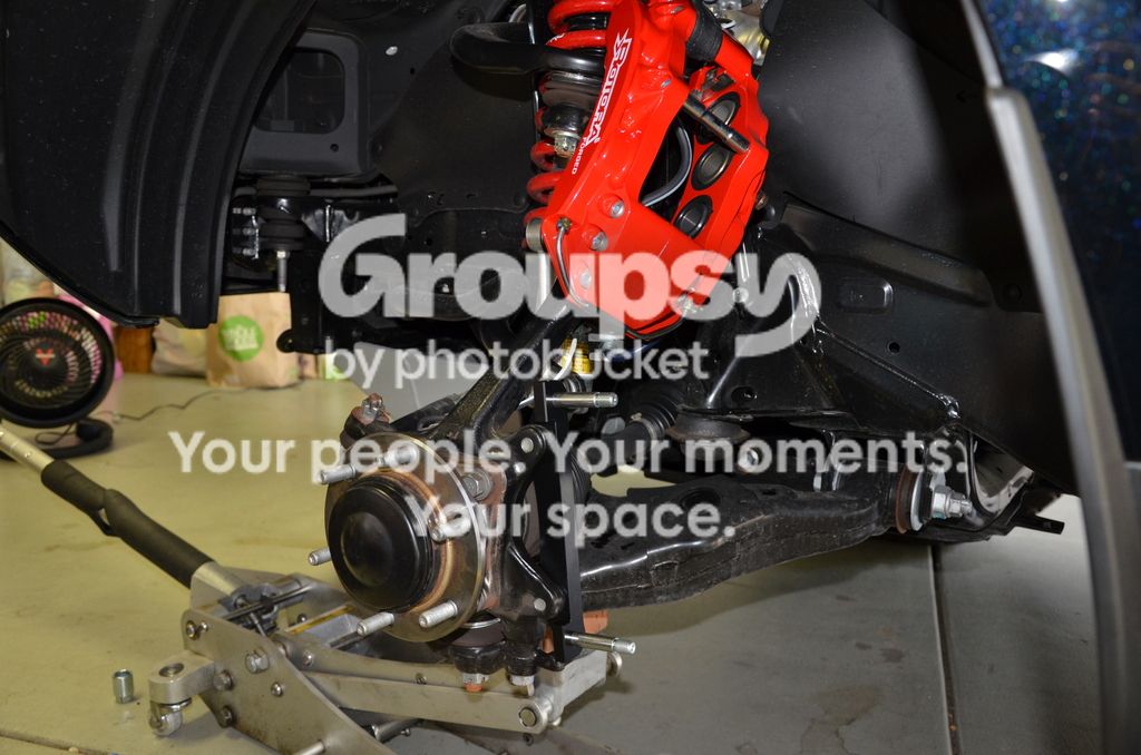

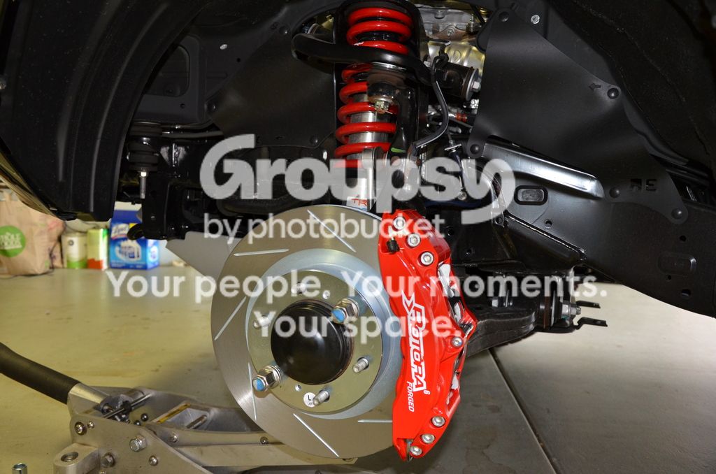

Let the install begin.
Caliper comparison

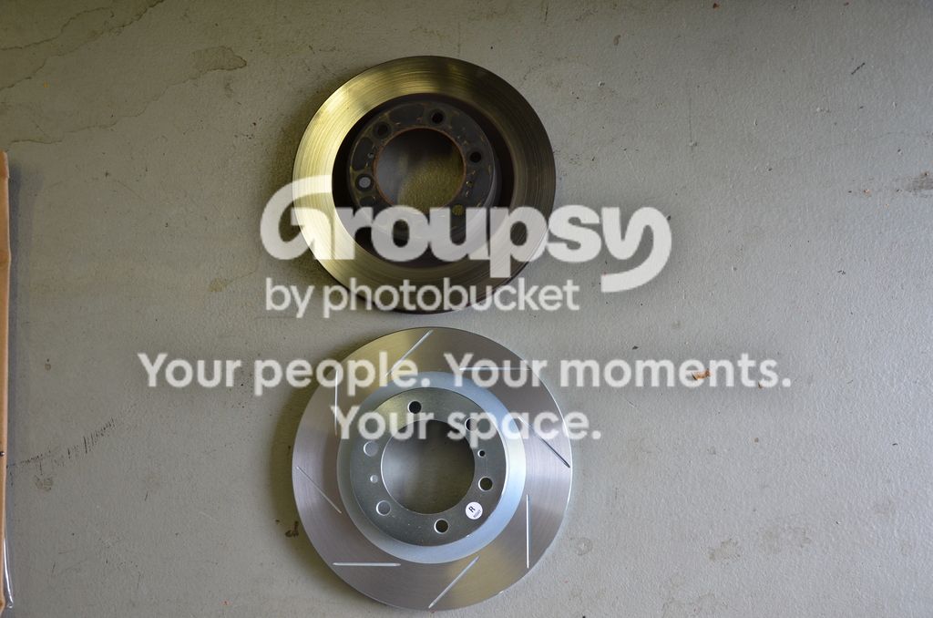

Rotor comparison
Factory
The manual wanted me to cut the stock brake shield…I was able to remove the whole piece.
After
Specs: Front: Forged 6-Piston Aluminum Calipers / 338X32 1-Piece Slotted Discs / Stainless Steel Brake Lines / H2 Ceramic Street Performance Pads.
The end.
Big Brake Kit on the TRD PRO gives it a massive nose dive when braking hard. Enjoy!
Kudos for being the first to do this. Land cruiser has a point. Stock brakes are adequate for this power starved truck. When URD releases their supercharger kit for this truck I will consider picking up a set. What are the specs of the rotors? Diameter looks the same. Weight? Why not two piece with aluminum hats? Price?
Rotors are 338x32 to clear 17inch rims. They only reason it's not a 2 piece rotor is due to the 17 inch rims. I don't plan on upgrading the rims. To fit the 2 piece I would need 18 inch rims. The weight of the calipers are half the weight of the factory calipers. MSRP $1995

Rotors are 338x32 to clear 17inch rims. They only reason it's not a 2 piece rotor is due to the 17 inch rims. I don't plan on upgrading the rims. To fit the 2 piece I would need 18 inch rims. The weight of the calipers are half the weight of the factory calipers. MSRP $2.100

Makes sense if you're sticking with 17"s. So they were willing to do two piece rotors? If they can go larger but lighter than stock with aluminum hats I may need to look into it...
