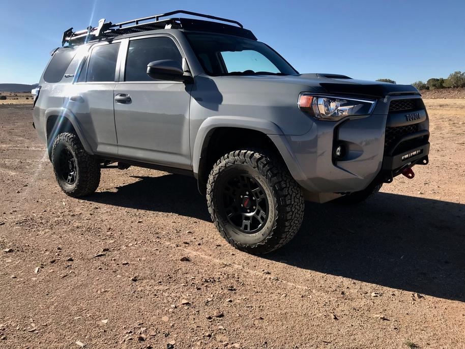

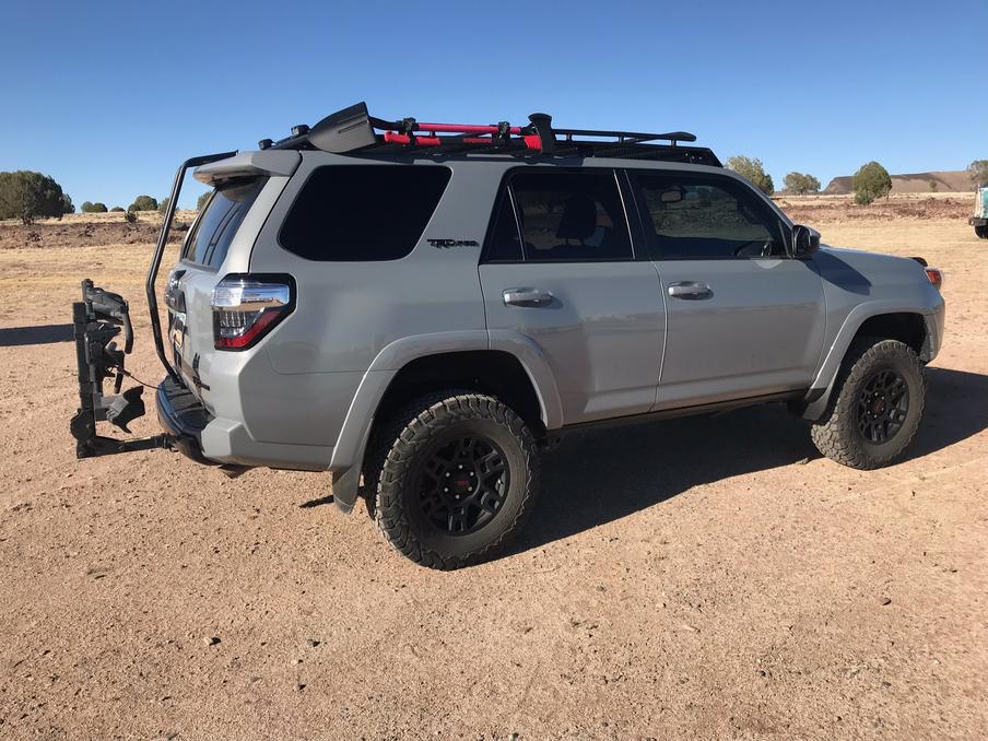

So, I did finally install the bumper/winch and as predicted, the rake is very noticeable. I did call Dobinsons and they assured me they could make a coil to whatever spec I wanted but would need new shocks as well. Their shocks are slightly smaller than 2” which is my only hang up. In the meantime, my son installed a King suspension on his 18 Taco. He prepared for the eventual bumper winch upgrade and got 14” coils with a spring rate of 600 or 650... can’t recall which. Expensive, yes.. but it’s quality. I think that’s my plan. Full King, 14”, 650 LB spring and custom colored in red. $300 xtra per King. I’ll post pics when it’s done
TOOK THESE YESTERDAY FOR A GOOD “before” pic
