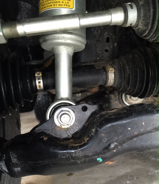

First, I have seen some talk in TRD Pro thread, but could not find specific answers if they have already been posted...Also, pardon my lack of thorough knowledge on lifts. Here are my questions:
1) If the pic below was taking to the higher notch, would that net .5"? Is this a cheap solution using what already is stock or is more needed? Though, I would want the back lifted the same as well.

From what I have seen and read on here, it is not adjustable like the Bilstein 5100. So you are stuck unless you put on a different lift, or put (gasp) spacers on a TRD pro. Why did you want to lift? Looks? Or bigger tires? Being that you paid for the TRD suspension already, I would leave well enough alone.
What notch are you referring to in the photo??
I think he is referring to the other bolt hole next to the lower strut mount but that's not for mounting the strut. I do believe from the pics I've seen the trd struts do have an additional notch on them but I think that's to lower it.
If you are referring to the other bolt hole, no.

To lift your vehicle you would either need to do small spacers or replace the suspension with something like the OEM light suspension. This would give you 1-1.5 inches of more lift over your stock trd pro suspension. Lifting your 4runner is no different from any other - except that to do it properly will remove most of what makes it a trd pro.
Why do you want more lift?
The pre production. TRD suspension had 3 notches on it and it was set to the 3rd or highest one when the pictures where taken. By the time it went to production Toyota got rid of that 3rd highest notch and only put 2 notches on the front coilovers making it a little lower and only adjustable to go lower.
So, to go higher you can add a spacer (not the best solution but cheap) or buy different suspension
you can either put a spacer on to lift it higher, or replace the entire suspension on it. i'll leave my questioning of why you bought a Pro to replace to the suspension and not to offroad it to the side.

Spacer lift will be fine. Problem with that is the current OEM shock could top out on the down extension and that would be a problem. If you keep it on the road you should never have that problem though. Spacers are cheap too.

If you want a little more I would do a toytec 1/2" spacer up front. Should net you about 3/4" more lift and for the rear a pair of 10mm OME rear spacers for around a 1/2" of lift.
