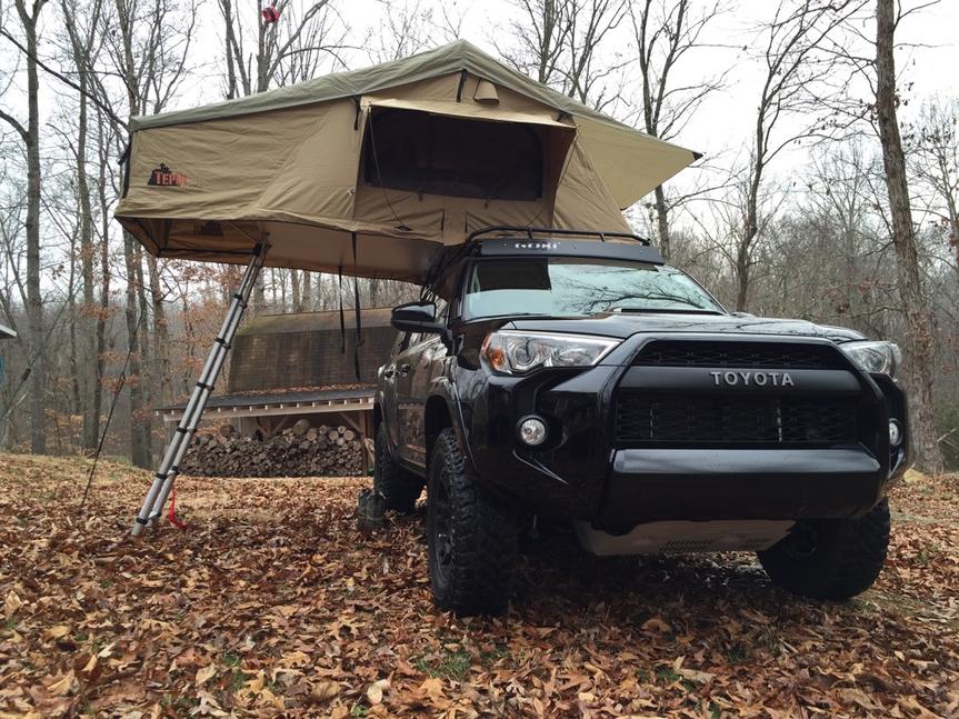

I too started a similar thread when I first got my TRDP.....I had a very similar question. Was looking to slightly increase ground clearance and load carrying capability WITHOUT changing out the major TRD suspension components. I called up the folks at Toytec, had a lengthy conversation, and we came up with this:
  • Replace rear springs (which are basic stock 4runner springs) with a RCC2.0 or RCC2.0HD spring.
  • Add a top spacer on the fronts with a longer stud setup or
  • Replace the 650lb Eibach spring up front with a heavier spring.
I have added a good bit of weight to my Pro with the addition of a RTT, Gobi Rack, Sliders (to come soon) and expedition cargo. I will be at the very least adding some rear springs soon.
Hope this helps.

Dude your ride rocks!

I would really like to see your setup. You're doing the exact things that I am planning. Only difference is, your are doing!
Looks great! I may have to hit you up for some advice.

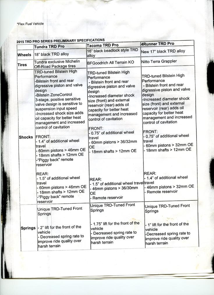

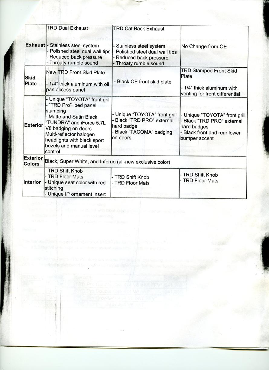

Sourced from Toyota at the request of an Inventory Manager:
That is a "talking points" sheet and has been here since September. It mentions the word "travel" but is that shock travel? Did they modify the bump stop? I don't know. I do know what happens if you run too short a shock though. You go over a deep pothole or speed bump and end up buying new shocks. You can't assume and posting that same sheet in two different threads like it was special does nothing.
