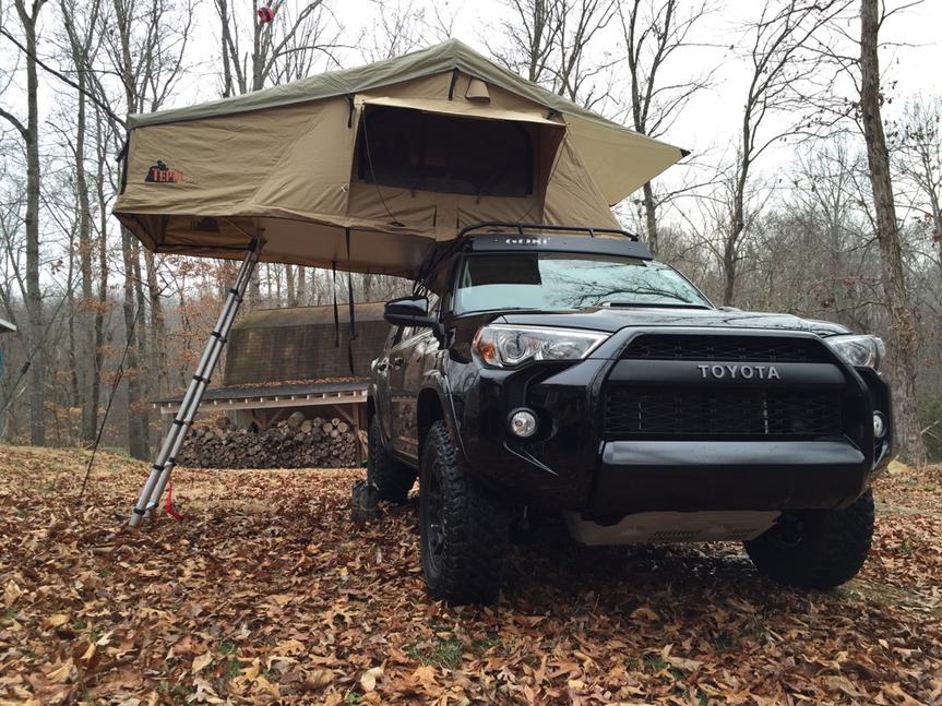

I too started a similar thread when I first got my TRDP.....I had a very similar question. Was looking to slightly increase ground clearance and load carrying capability WITHOUT changing out the major TRD suspension components. I called up the folks at Toytec, had a lengthy conversation, and we came up with this:
  • Replace rear springs (which are basic stock 4runner springs) with a RCC2.0 or RCC2.0HD spring.
  • Add a top spacer on the fronts with a longer stud setup or
  • Replace the 650lb Eibach spring up front with a heavier spring.
I have added a good bit of weight to my Pro with the addition of a RTT, Gobi Rack, Sliders (to come soon) and expedition cargo. I will be at the very least adding some rear springs soon.
Hope this helps.
