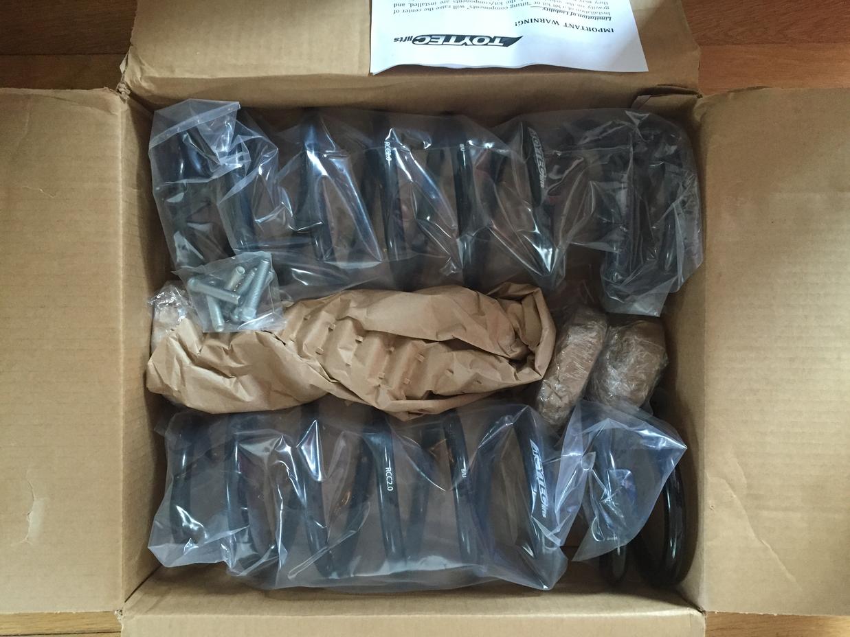

FedEx just delivered... On Christmas morning!? 4runner might arrive today as well. Not intentional. I swear.
Didn't read the whole thread either but I just bought my 2016 TRDPro almost a month ago and didn't waste time ordering the toytec TRDPro lift. I spoke with Scott over at toytec and he recommend using this lift until the stock TRDPro suspension wears out. Then fully upgrade. The owner of toytec uses this lift on his TRDPro. I already ordered mine and it should be here Wednesday :thumb:
