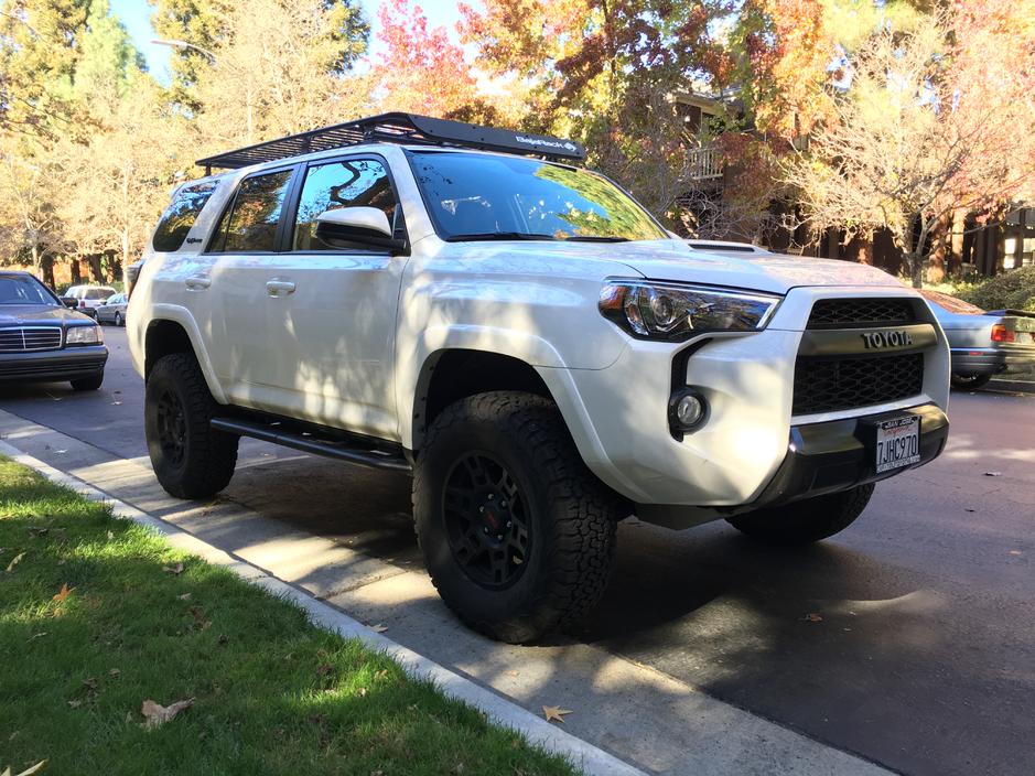

34x10.5x17 BFG KO2
Fronts swapped for Bilstein 6112
Stock TRD rear shocks with Toytec Superflex

What was the reason of swapping the front shocks?
Also do you have any rubbing with the 34's ?
Thanks
No rubbing with the Bilsteins set at 2.5". No other mods were required however this might change once I get UCAs. I foresee it rubbing against the front bumper if I push out the caster any further, so I might need to trim the bumper a little more (where it is already trimmed from the TRD models) or raise it to a full 3" lift.
I wanted more of a lift and didn't want to run spacers, hence the reason for the swap. I misspoke and these were swapped for 6112s. The Bilstein 6112 are identical in terms of shock body, piston size, and possibly valving to the TRD shocks, but gives you added lift due to the extra retainer positions.
