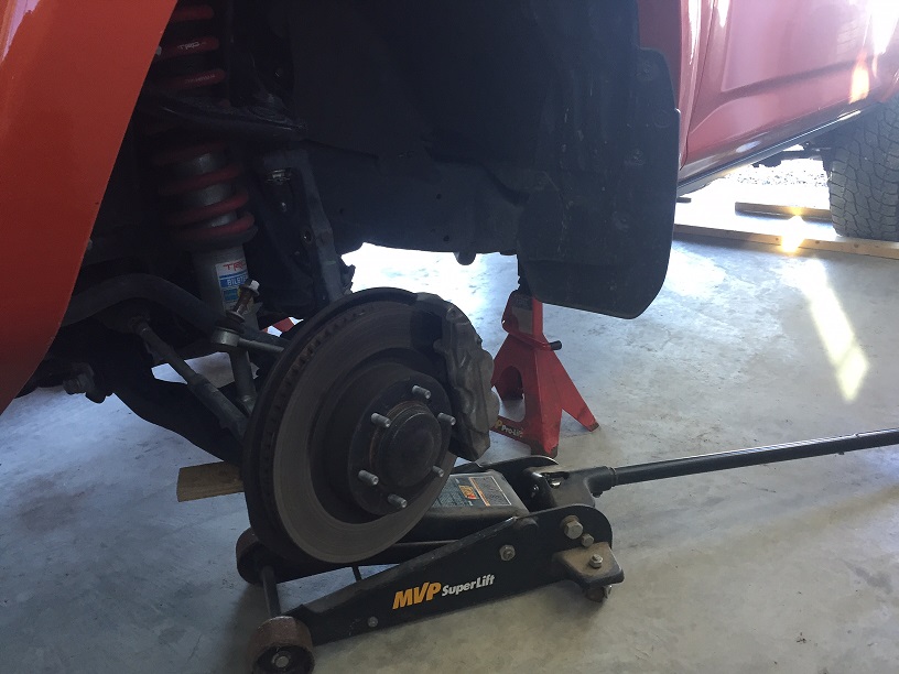

1. Remove the front wheels both sides, and use a jack to help keep the whole assembly steady while you are dissembling.

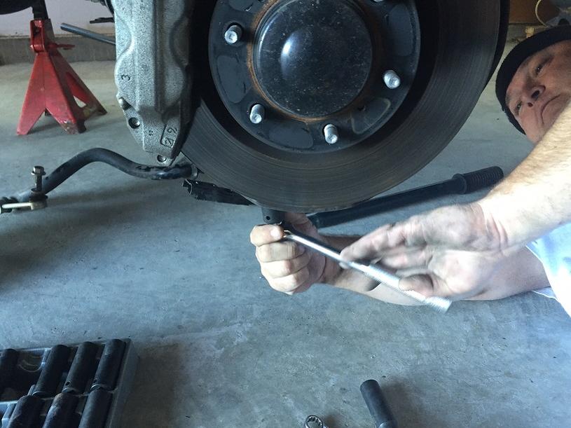

2. Remove the end links to the sway bar on each side.

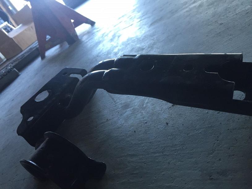

3. Remove the front skid plate and the two supporting brackets to get them out of the way to remove the sway bar. The two brackets hold the skid plate on the frame and look like this.

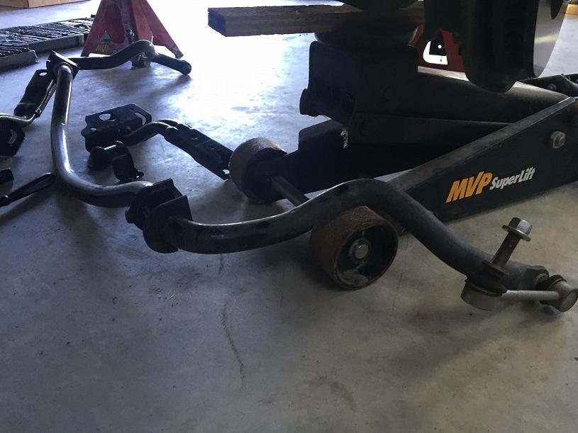

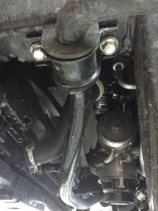

4. When you slide under the rig from the front, you will see two brackets that look like these that are supporting the sway bar. Loosen both bolts closest to the front of the rig, but not totally removing them, they are slotted and need to remain to put it back together more easily. Remove the two bolts closest to the rear of the vehicle all the way out. Be sure to keep track of every bolt you take off, I used zip-lock baggies to help and taped them to their respective parts. Once you remove the back two bolts, the sway bar is free to be taken off but having two people to guide it together was much easier than doing it alone.

5. I simply left the sway bar and brackets under the truck, they didn't get in the way there.

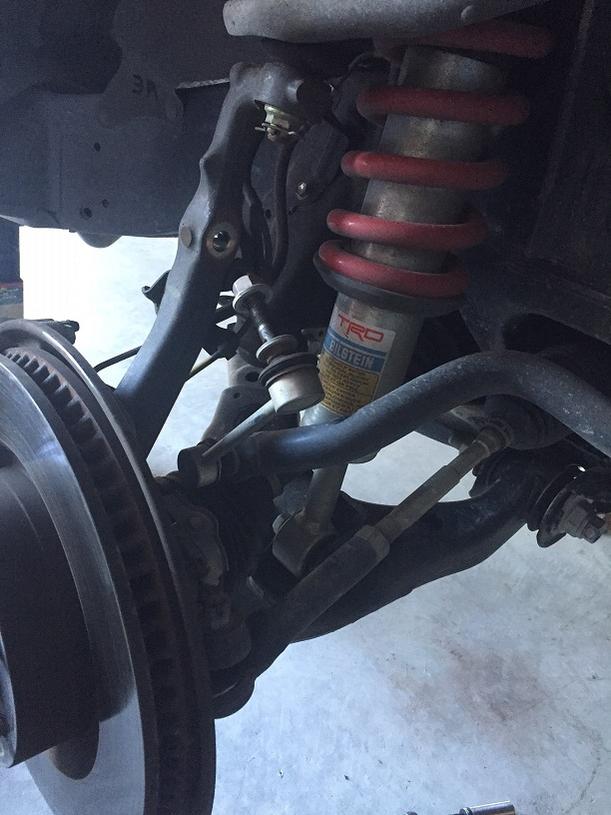

6. Remove the two bolts located directly under the rotor to free up the CV joint for the needed mobility to get the coil-over out once it's detached. The bolt is located directly above the sticker on the floor jack behind/under the rotor, fyi and there are two of them.

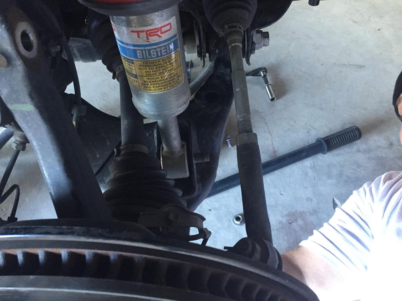

7. Remove the bolt on the bottom of the shock and the three at the top. Be sure to take a picture prior to removal and mark the back bolt to distinguish it from the other two for proper placement when re-installing. I used a sharpie and put a dot on the top of it. If one person moves the upper UCA around, it will help you get the shock out much easier and will prevent you from scratching it all up.

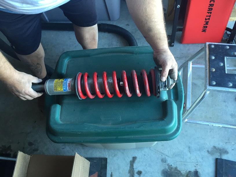

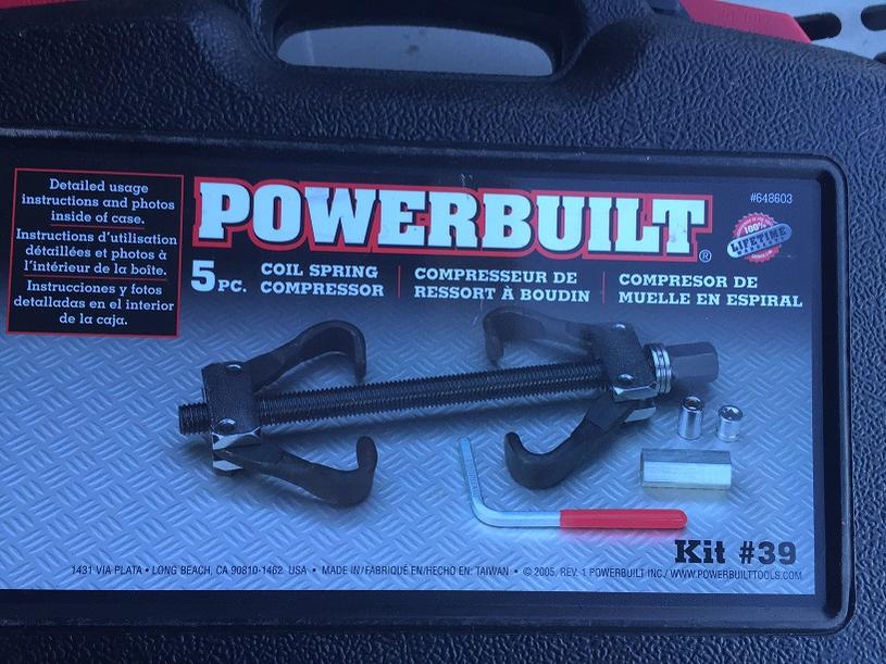

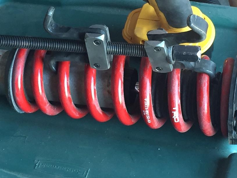

8. I went to Advanced Auto and they run a rental buy back program for the spring compressor, you will need TWO. You buy it, use it and return it for a FULL refund, nice eh? I only got one and man did I regret it. It makes the spring tilt to the side it's installed on and once you add the bottom spacer, getting the top nut, washer and washer centered was a PITA. Here it is:
9. Once you have the springs compressed, the top bolt should come off easily, if it doesn't then the spring needs to be compressed more. If you try to take it off when it's still too tight the kinetic energy in the spring will hurt you badly and very quickly. BE CAREFUL HERE.

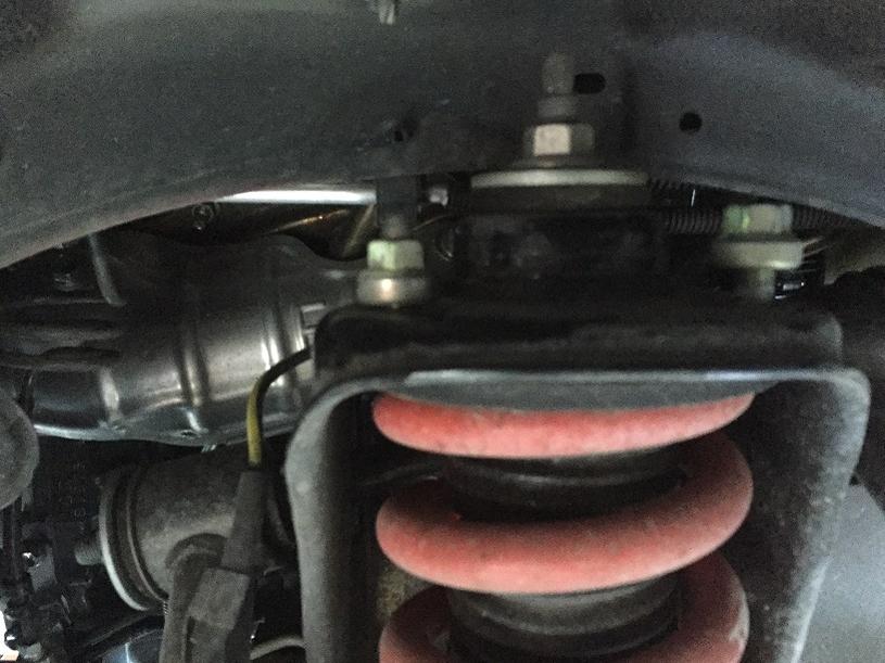

13. Re-attach the top rubber grommet, washer and nut. Once re-installed, tighten it down until it stops and use the very top portion of the shock to hold it from spinning while tighten the nut.
14. Be sure to add the small spacer to the top of the fully assembled coil-over before you install it back.
Sidebar.....since I only had one spring compressor on the spring it twisted the spring to one side and then popped off before I had reinstalled it. As you can imagine this was a pretty big problem. I put it back on but was very weary of it coming off again so this is when I used some common sense to help me out. I put only the washer and the nut on, until I had the coil-over back on the truck. I put everything back together, sway bar, shock etc from beginning to end and put the tire back on. Once the truck was taken off the jack stands and lowered back to the ground, the weight of the truck made getting the grommet to fit properly WAY easier. We actually repeated this "mistake" on the other side to save worrying about the spring compressor popping off. Two spring compressor's should prevent this, but if you only have one, there is another way.

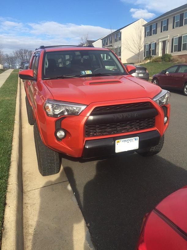

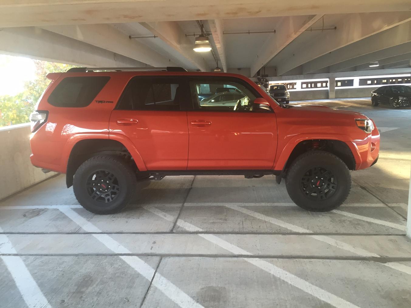

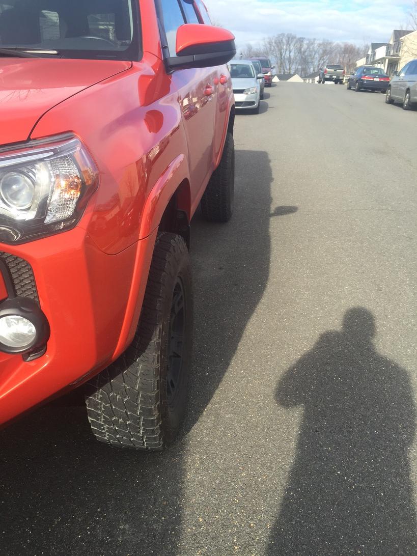

Review of the install, if you have the money pay someone else to do it, hahaha! It wasn't extremely difficult, but there were times when I wasn't sure we were going to figure out issues mainly due to the proper spring compressor. The rig came out like others have said, "like it should have come from the factory!" It took us about 5 hours but that was with many breaks for mental stability. :mad2: Do the front first, the back is pretty painless. If you own a TRDP and want more from the look and feel, this is the lift for you to not have to replace the majority of your suspension. Here are some pics of the finished product, sorry my phone sucks but it's all I have....I did also add the Spidertrax adapters and they require no fender well trimming with this lift. The truck drives almost the same as before but I don't want to give that feedback until I have driven it a bit more.

You went with the 2" rear springs didnt you? By the way great job, looks awesome...thanks for the write up
Yes, the 2" rear springs and thanks. It is quite a bit more Impressive in person than pics I saw on here to. With these results, best mod so far.
