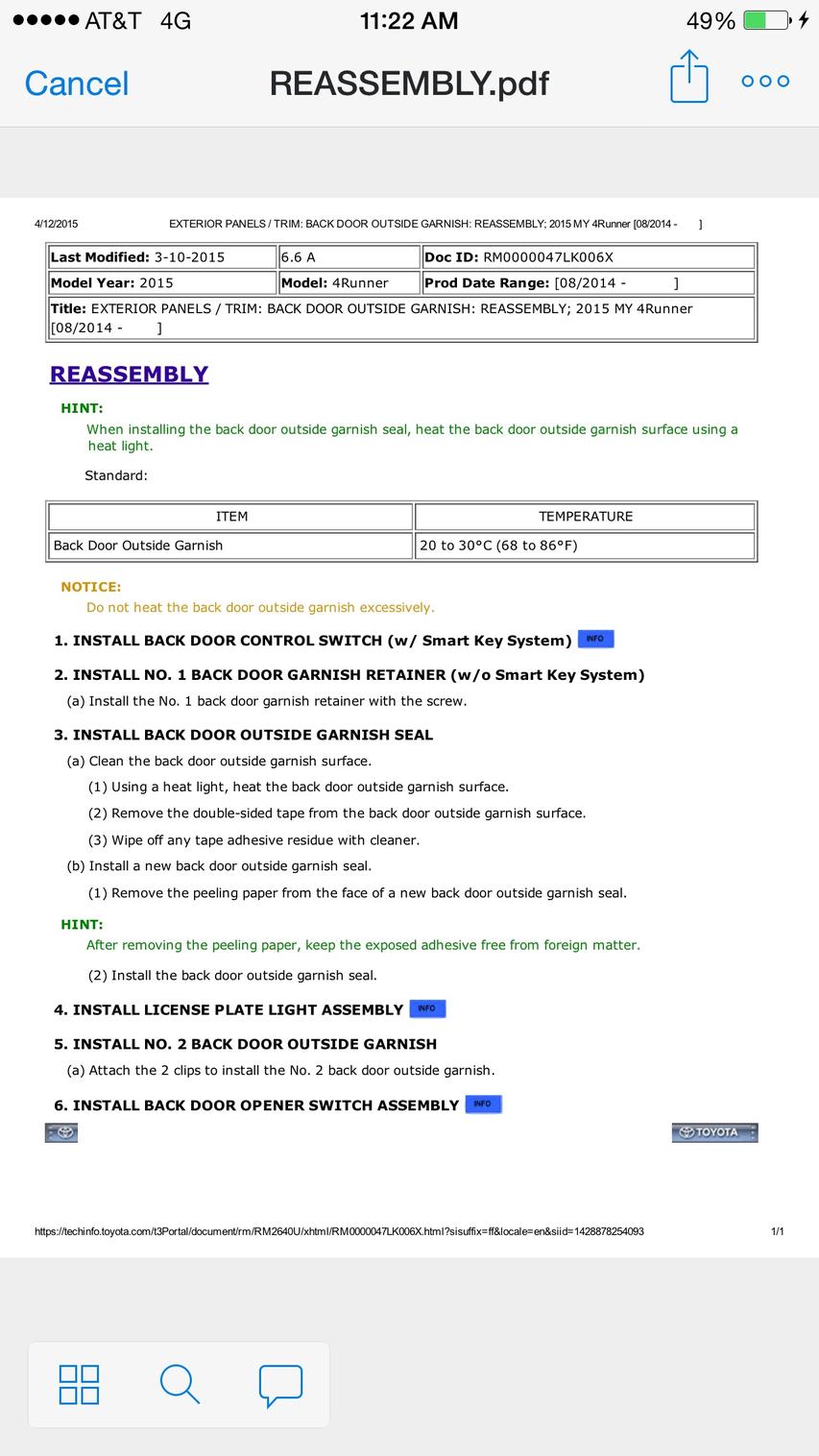

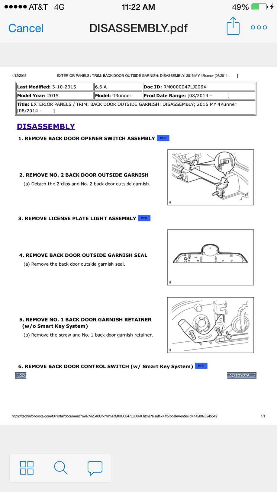

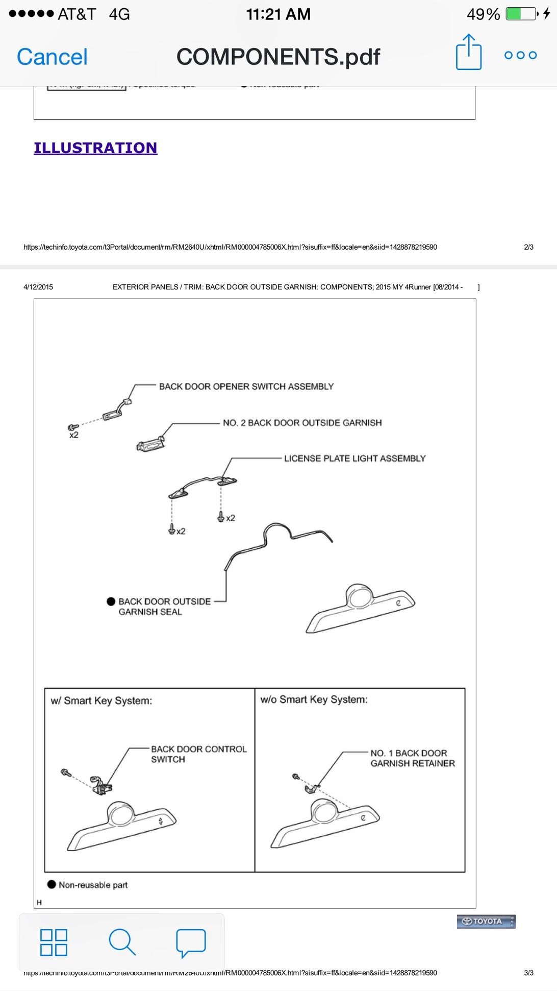

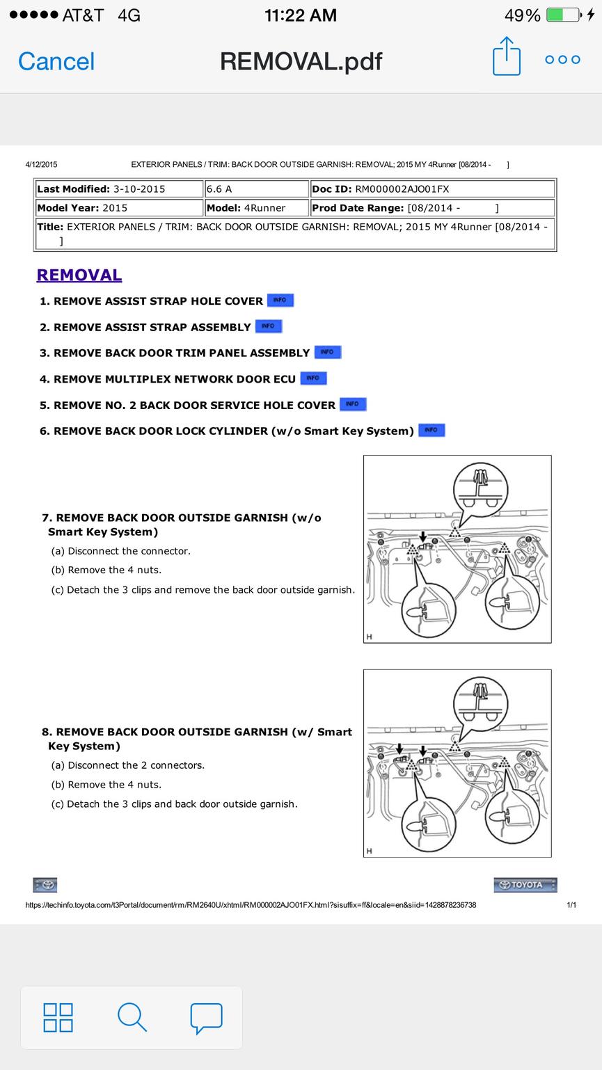

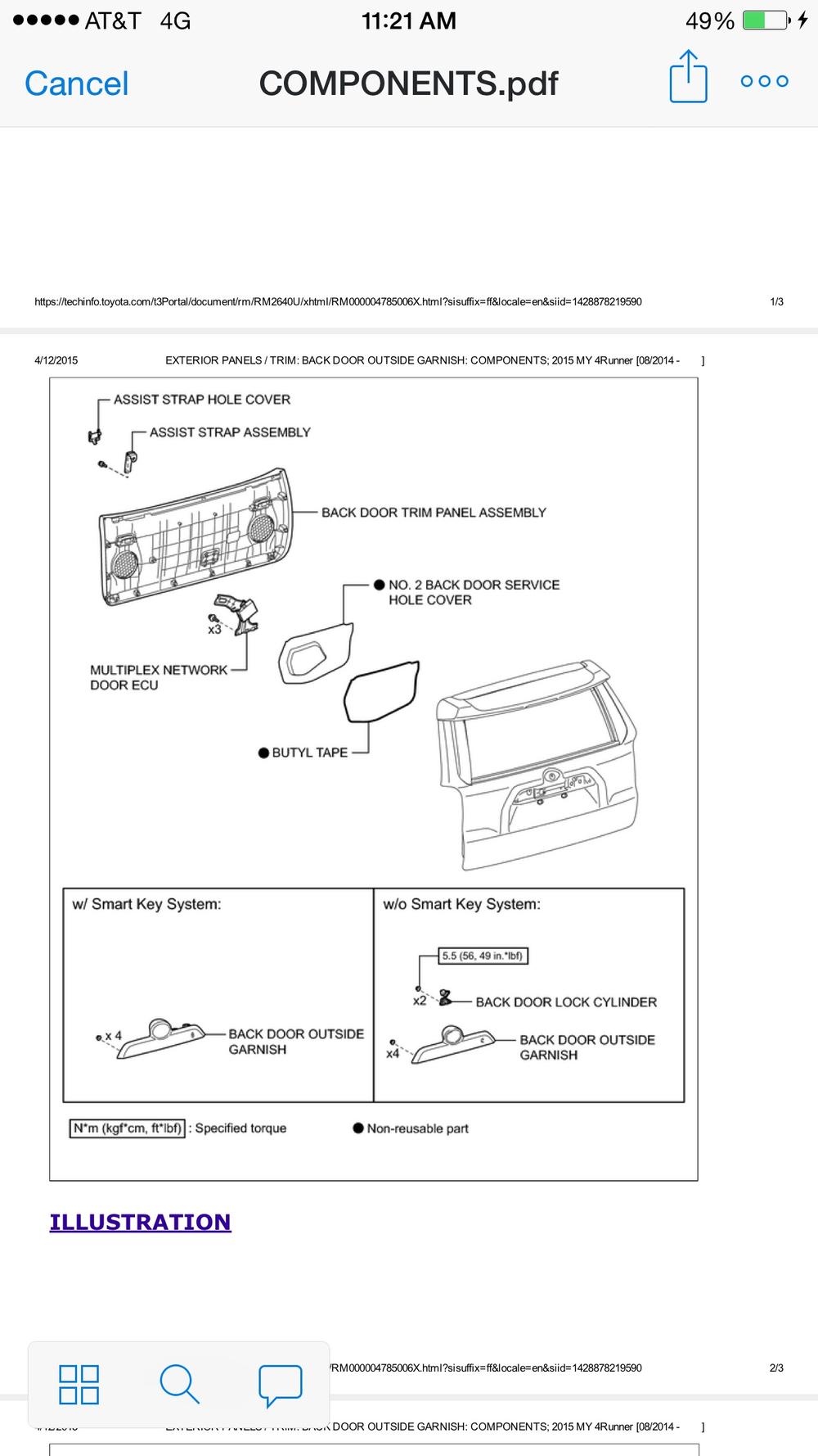

Oh wow, sorry about that bud. When I was stuck, [MENTION=28870]d_clark[/MENTION] helped me out with those links, which I guess only work if you have a Dropbox account.
On my iPhone, so will post individually..
Components:
