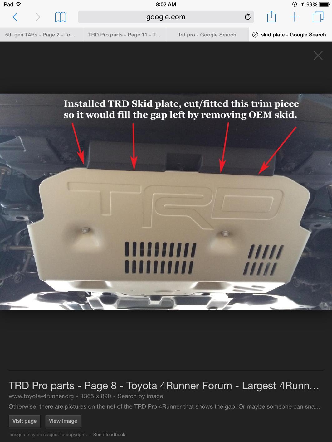

Yesterday I had the TRD Pro skid plate on my 2015 Trail (mine does not have KDSS, and the instructions in the skid plate instructions clearly state that it will not work with KDSS). They had to remove the wimpy Trail protection plate to bolt on the TRD skid plate. It was a very quick install. The only difference I can tell is that my steering is just a bit stiffer (I have no idea why).

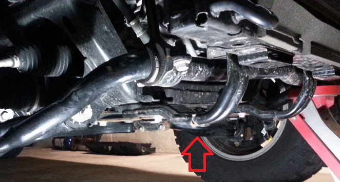

yes, pics please. this seems weird. the only readily apparent difference (visibly) between the prototype KDSS-compatible skid and the production skid is the lack of the cutouts to accommodate the travel of the KDSS swaybar. there's another guy on here who tried to mount the Pro skid on a KDSS Trail and he bailed on it too. see here: http://www.toyota-4runner.org/5th-gen-t4rs/186911-trd-mods-2.html#post1978925
it's not obvious why this wouldn't work when looking at the prototype, KDSS-compatible skid, however. looks nearly identical to the production skid. :confused:

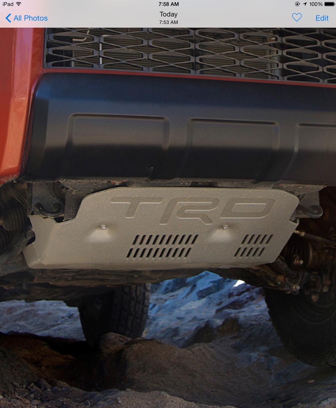

For what it's worth, I don't think it's the same skid plate, it's hard to tell but I think the holes are off set some. If you look at the vent cuts the where the "R" lines up, it's slot 3 and 4.
When you look at the KDSS plate the slots are 4 and 5.
KDSS skid plate vent cuts,
you can see the bolt holes look different

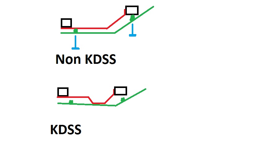

I had a local FJ buddy swear to me he could mod one for me and he failed too. So I also have a $250 paper weight. After a full week of working on the truck, I am too lazy to take pics but here is a quick and dirty drawing. (don't hate on my mad paint skills lol)
Basically, it will not work due to the bottom radiator support brackets. The non KDSS ones are flat at the bottom and the KDSS variety curves at the bottom for the say bar. You would have to use 1 1/4 - 1 1/2 spacer for the rear mount and a 3 - 3 1/2 spacer for the front. But this also throws off the angle on the front lip (where it is stamped TRD).
I am betting that the prototype used the flat brackets or none at all. One thing I noticed while installing my lift was at no time did the sway bar ever travel enough that it would have hit the regular bracket at full droop. So unless there are bracket clearance issues during side to side articulation one MAY be able to swap to the flat brackets. I am not sure how one would source these though.
