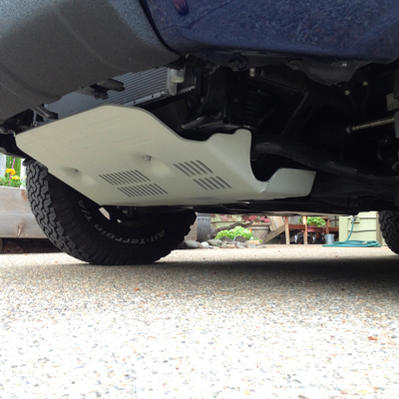

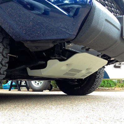

I'll take some photos this evening and try to post. Looks like the pre-production TRD Pro…
Did you compare the interior height of the skid plate (on the driver's side where the KDSS sway bar droops) to the interior height of the supports? You might want to do that before really articulating the front end and finding out that the swaybar and skid plate don't play nicely together.
I made a template off the stock skid plate and transferred it to the TRD unit so clearance is good. Used a little artistic license in the final cuts. I use my rig mainly for hauling my drift boat out of crappy takeouts and not serious rock crawling. Thought the TRD plate would look cool and channel road kill under the rig without dragging it along. I also like to mess with the guys at the dealership.

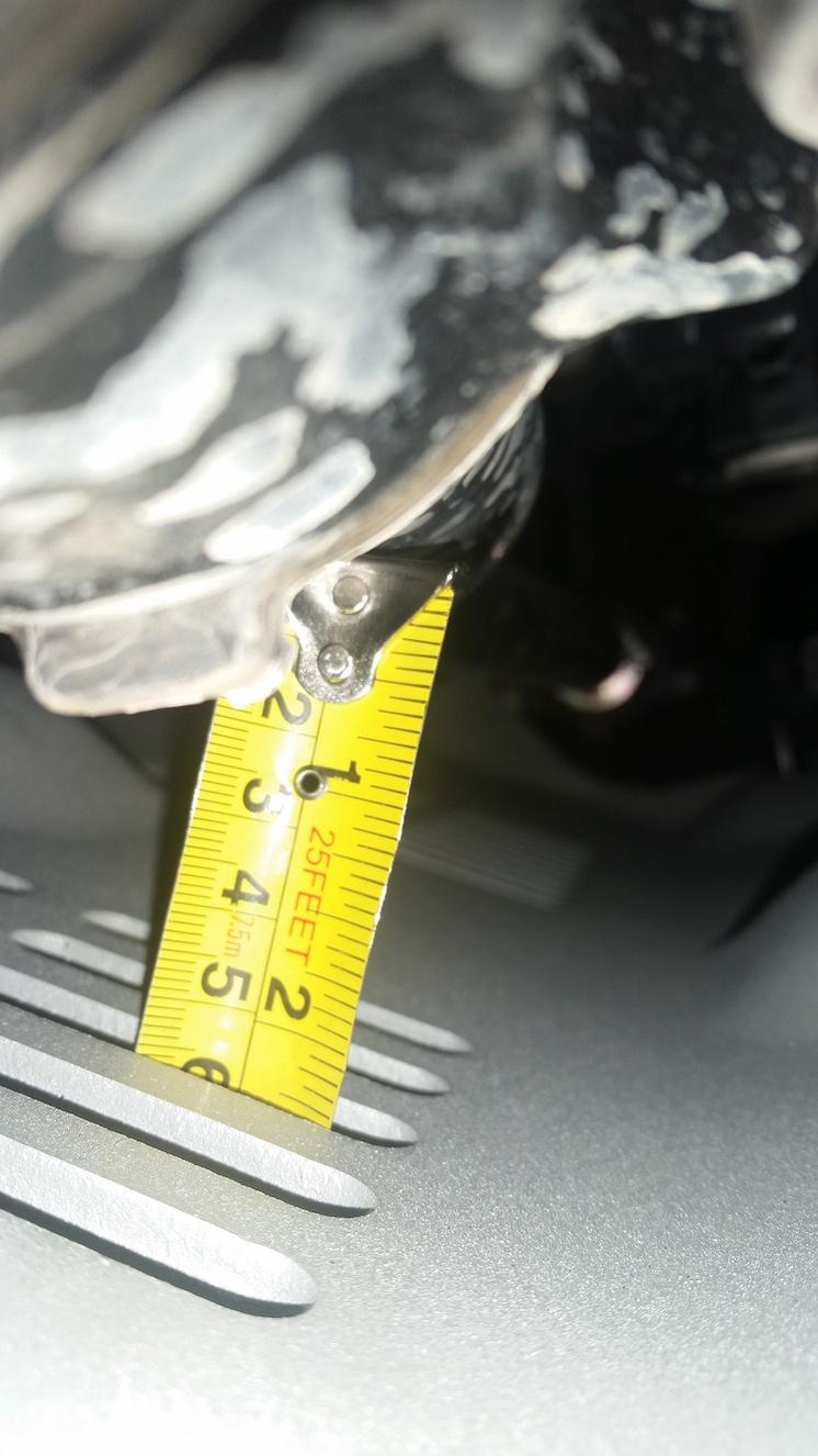

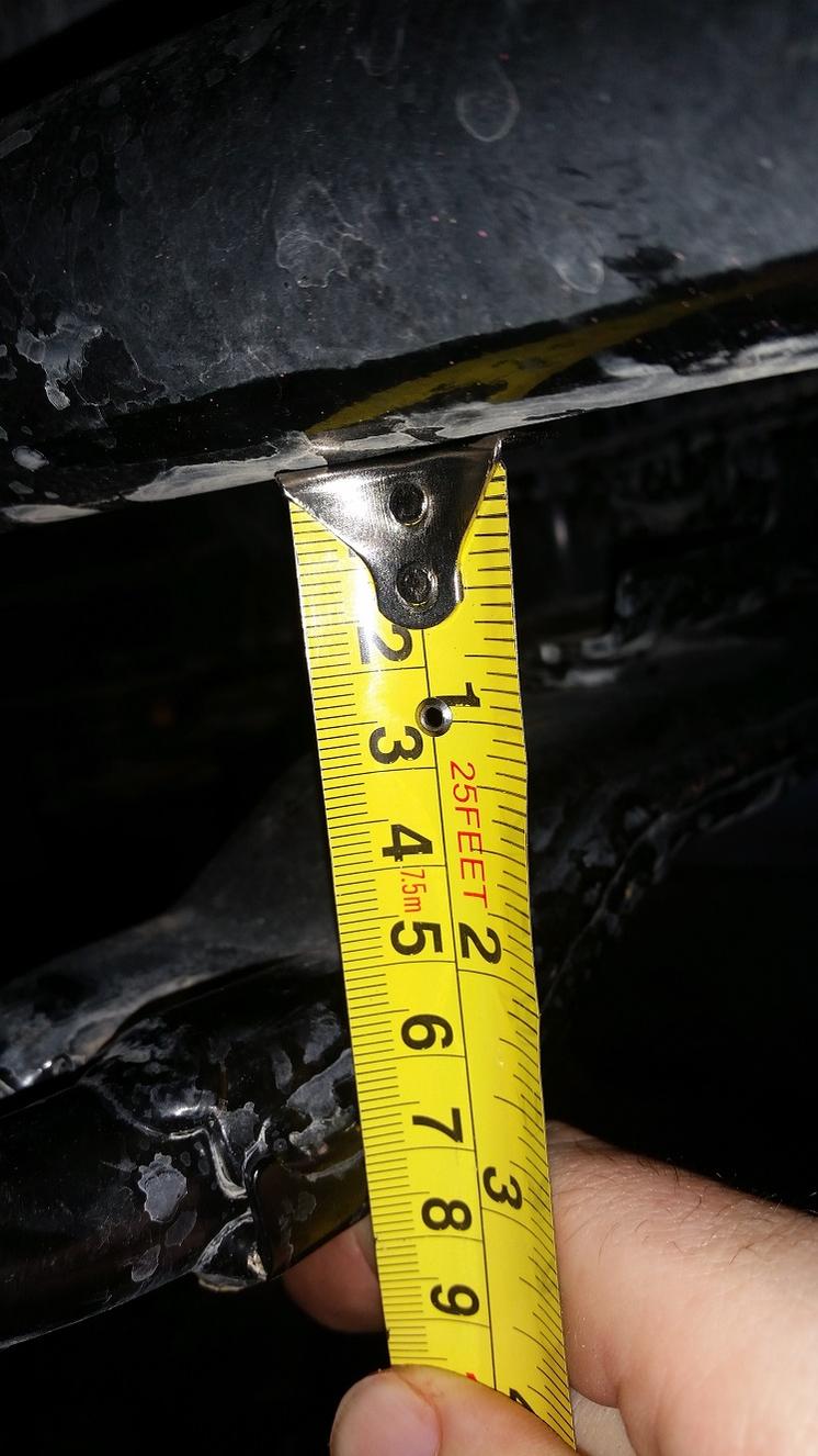

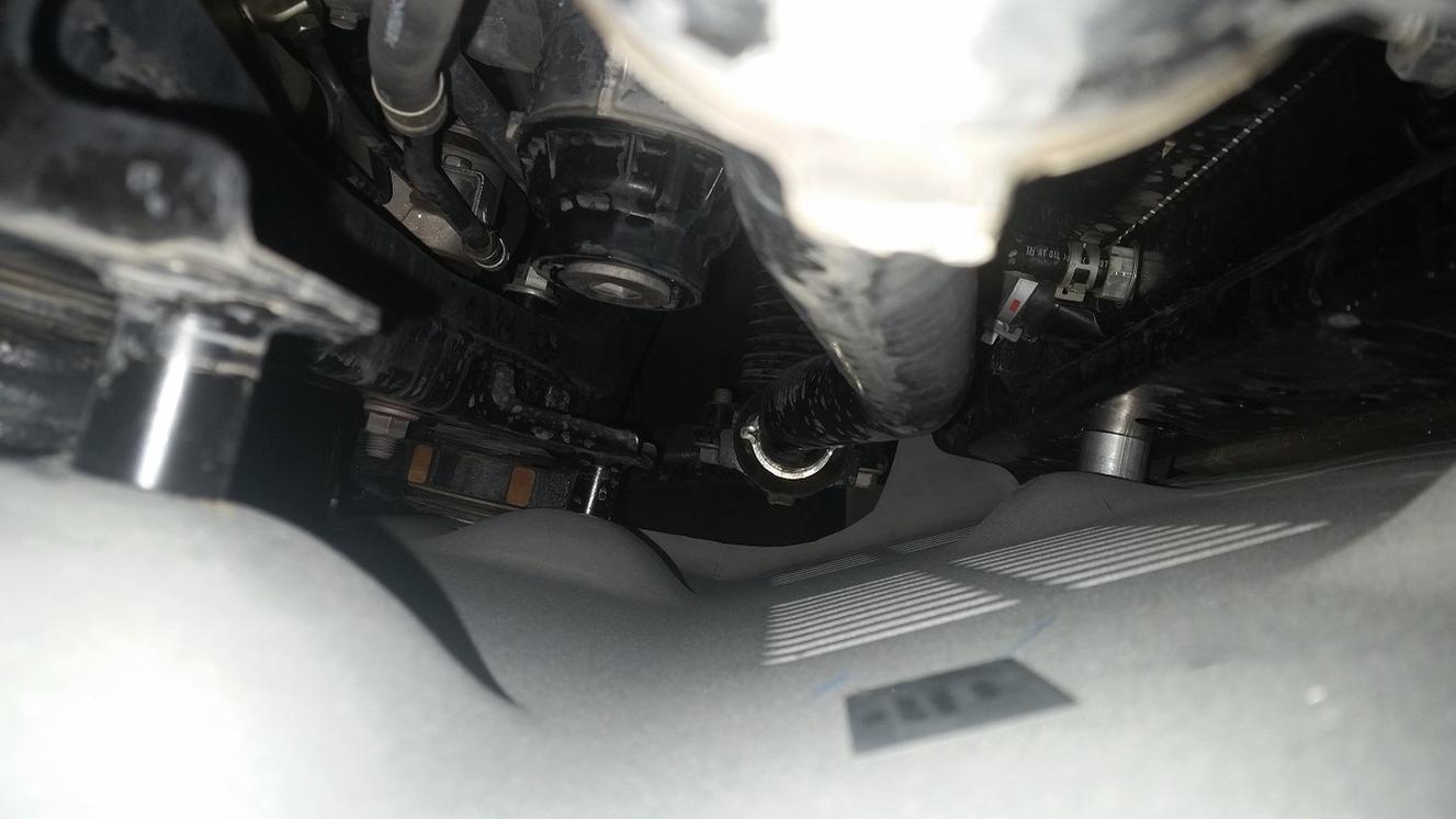

My buddy cut mine and did not do as clean/detailed of a job as OregonTrailRunner but I am not worried about it. Here are some pics showing internal clearance. I measured at the same spot and no clearance was lost with the skid in place. It was dark outside so I could not take any external pics yet.
