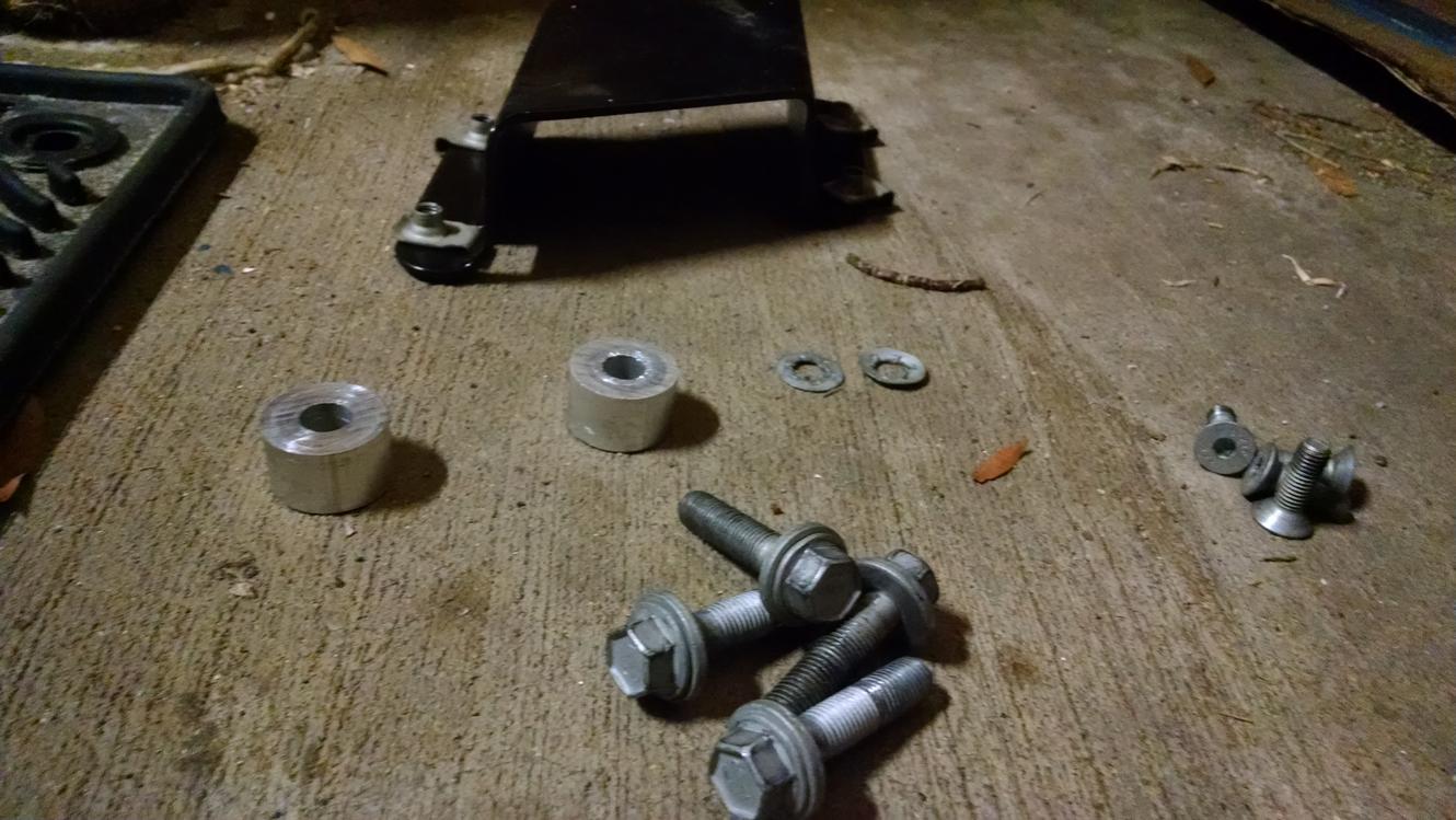

Took my skid plate off to paint it. Not sure if I have an issue or not. First front bolt seemed to be stripped and was not coming out. I stopped and re-read this thread. It didn't really help. I noticed something spinning above the plate when turning the bolt (bad visibility above the plate, but shined flash light in there) . I leaned into the plate with my forearm to get some friction, the spinning stopped, and i was able to proceed and get the bolt out. I will chase the bolt and threads before inserting as recommended here. Hope to avoid purchase of new bolts, but will if necessary. Added a pic of all the pieces, including extra parts I was not expecting...
Those bolts look stripped. You didn't need to take the Allen screws out. The problem is the blind nut welded inside the lower radiator support. Is that there?
The front bolts will only come out so far because they have a spacer and a keeper on the bolt to hold that spacer in place. Now, if the bolt is stripped or messed up you will need to chase the bolt or purchase new ones. It's hard to tell from that angle if the threads are stripped.

thanks for all your input. so yes, the bolts are stripped, and no, the nuts did not pop off....I don't think i'll be able to chase the bolt threads that are not there (as one of you stated...) but I will chase the nuts, and with new bolts, hopefully i'll be back in business.

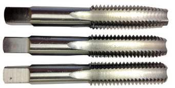

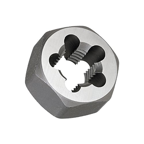

Here were the parts I got at Amazon for my fix (see pics). I first tried the still good rear bolts with in the front nuts, they would not go in, so I chased the front nuts with the attached device in the pic. Now they go in just fine.
I then chased the bolts, and they definitely need to be repaired/fixed quite a bit by the die. As it stands they 'may' work. If I use them I'll swap the 'fixed' front bolts to the rear and use the bolts from the rear up front. not sure if new $32 bolts (PT938-00140-AA) at dealership or ~$28 online with shipping will be worth it. I'll may snug up the skid with the old bolts and see if I feel comfortable with it, checking often to see if they are holding. if not, i'll resort to the new bolt purchase.

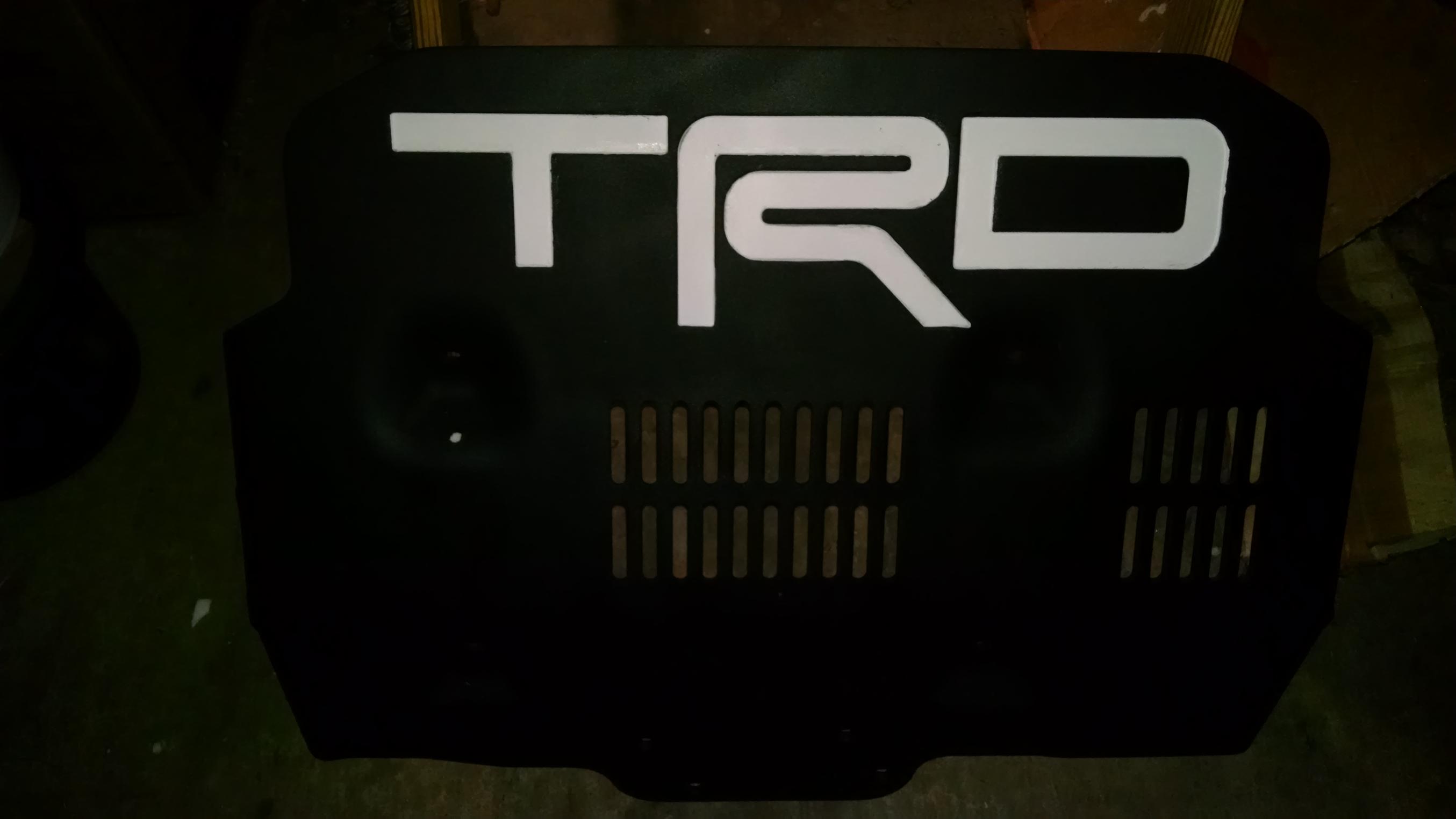

Attached a pic of the painted skid. I think this will look sick on my Super White (awaiting final clear coat).

skid plate all back in place. I like the result. old bolts swapped around as previously described. holding good so far, i'll check them periodically. didn't apply the 'thin' washers. they would not go on easily. what's a project without a few extra pieces when done, right?
