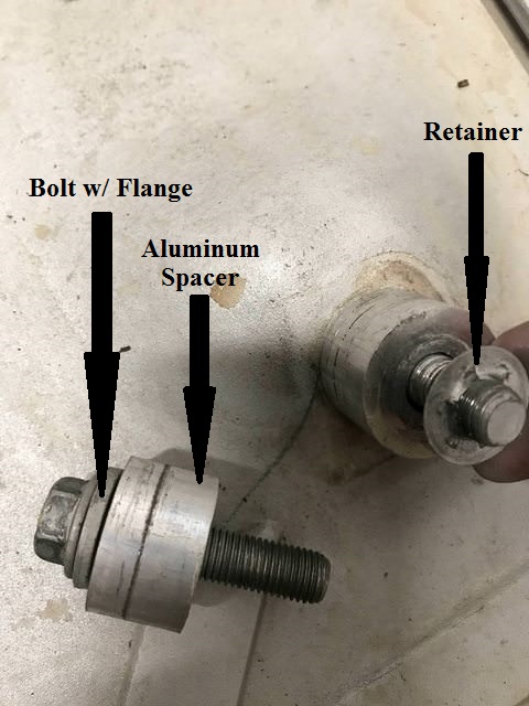

I was working under the hood today and dropped a clip onto the skid plate, so I removed it but had some trouble getting it back on. Can someone explain to me why there's that flange welded on one of the front bolts, but not the other? It everyone else's like that?
If this is the welded flange you are speaking of on "one of the front bolts", then both should look exactly the same in that location .
Bolt with flange, aluminum spacer and the retainer.
The retainer is not welded, you can turn it and screw it down to the spacer prior to installing the skid plate. There should be one on each bolt.
A replacement kit part # is: Toyota (PT938-00140-AA)
