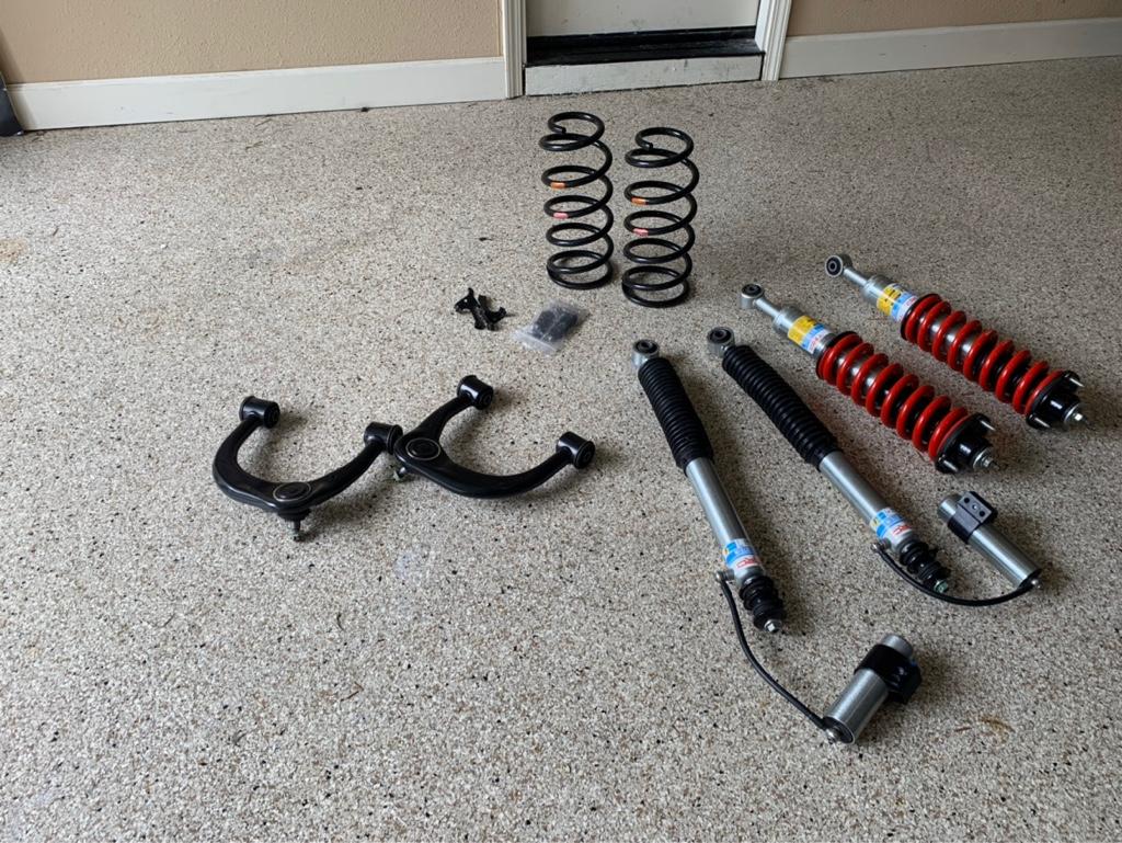

Does the TRD Pro use different rear springs than the SR5 or Trail? Reason I ask is I see the TRD Pro "full suspension kit" for sale quite often. I've never seen it listed with rear springs until yesterday. Person selling the kit says they use different rear springs than non-TRD Pro vehicles.
I have a TRD Pro kit from TRDshop.com sitting in my basement but it does not have rear springs. I'm worried about installing it and having reverse take.
Can anyone confirm for me one way or the other if the rear springs are different or not? Thank you in advance.

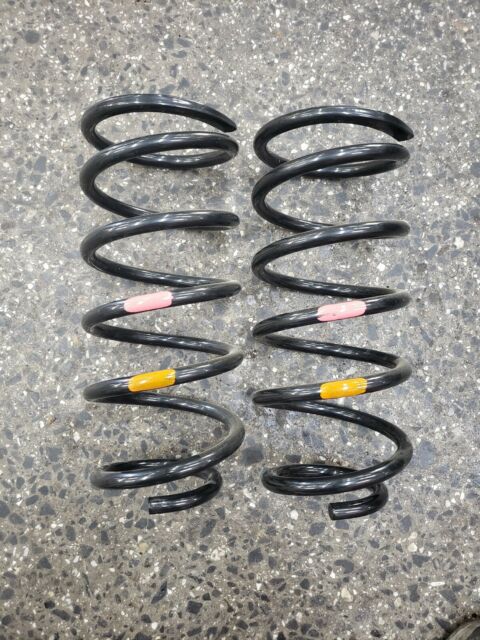

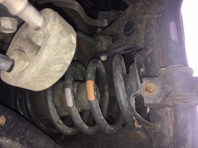

Limited color code = purple/orange, below. SR5/Trail/OffRoad/Pro have Pink/Orange. I looked again, corrected to pink/orange for non limited.
