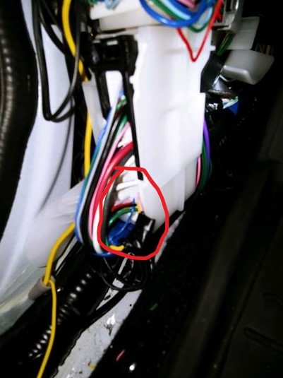

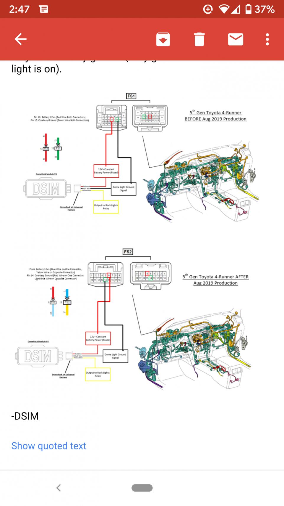

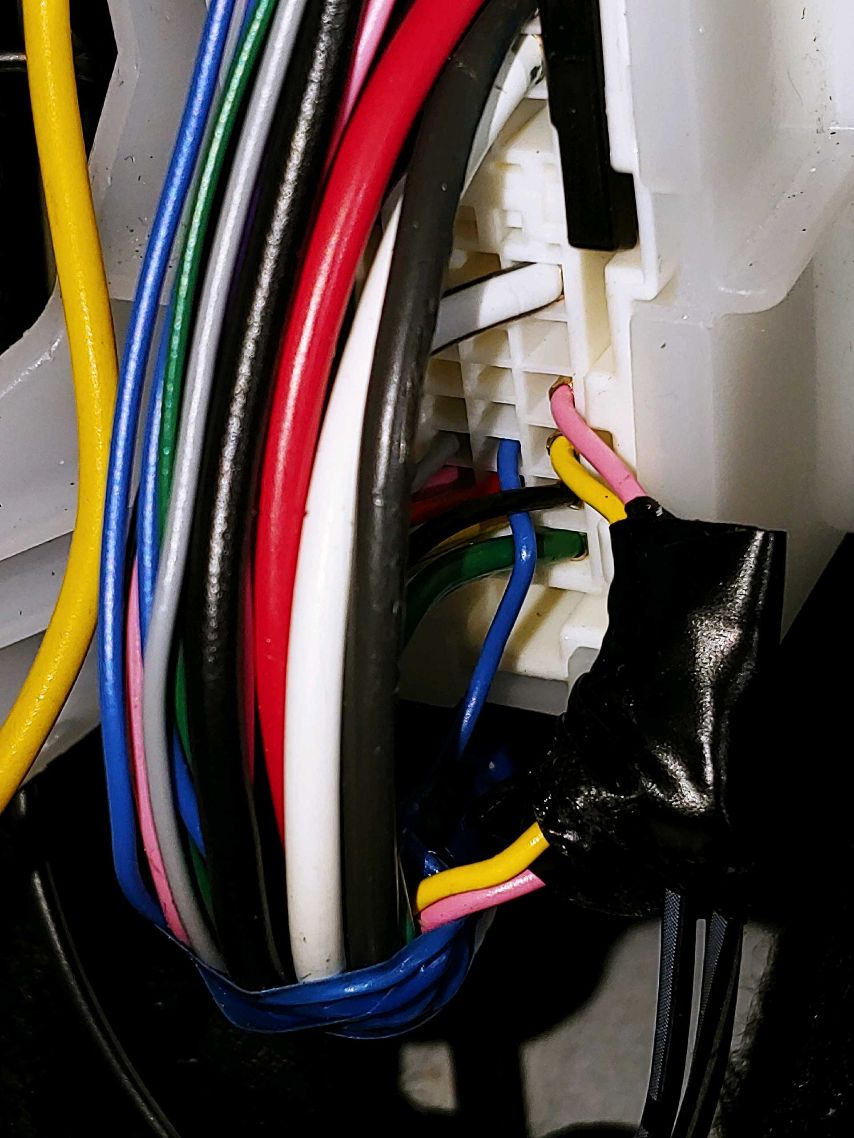

I just got finished upgrading my 2020 pro with power folding mirrors with puddle lights and turn signals (puddle lights and turn signals never option for this model)
I was able to bring in the turn signal positive and negative through the door dongle into the wiring harness on the drivers side bottom. (This is the very bottom connector) You will see 1 pink and 1 yellow wire in the photo that were tapped for the positive left and right signals. The grounds go straight to chassis.
I was able to go into pillar A on the drivers side and attach my ground for the puddle lights to pin 14 in the connector. See attached diagram. The positives need to be attached to a 12vdc constant on. The lights now work with the remote control and follow the patterns of the dome light in turning on and off. I have not rigged it for a manual override.
