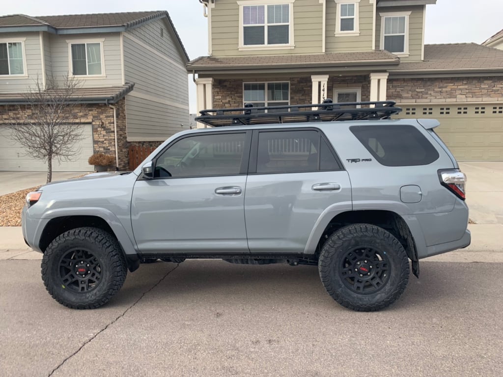

So there are a lot more posts from people doing more research on this and ultimately deciding the 14" coils would be fine on the TRD Pro coilovers which I agreed with from the beginning. I did this swap back in the late summer/early fall of 2018 I wanted to give an update on how my suspension is doing after running this setup for nearly 50,000 miles.
Frankly, I've loved every damn mile of it. I've taken my 4runner all over: Moab, Sedona, Anza Borrego, Joshua Tree, Coyote Flat, Mojave Rd, etc. and have put this suspension through its paces. It has impressed me over and over again with every obstacle and terrain I've thrown at it. Coils have not sagged at all after many long loaded down trips (and more than a couple bump stop hits lol) and shocks are still doing just fine. Still as responsive as the day I had them installed. And I have not found that the down travel was limited at all by this swap. Only limiter is the IFS as we all know haha. And 600# is not too stiff for a DD if you have a little weight such as sliders, skids, roof rack.
Added new tires too.
Sorry if this has been answered, but on a non TRD we should be able to get this same stance with 6112's up front and 5100's in the rear with the T13 springs correct?
Are you talking full 6112’s (struts and coils)? If so, yes. Putting longer coils on sr5 stock struts wouldn’t give you this or be advised.
[MENTION=87276]DarkSideGTI[/MENTION] .....what he said. Yes you can use normal 6112 coilovers, 5100, and T13 to get this stance.
Thanks guys. I just ordered 6112 coil overs, 5160 rears and some OME springs.
Nice setup, don’t forget get bigger tires: this will give you that added clearance, not necessarily the lift itself... that and your rig won’t look like it skipped leg day.
I did leave that part out. Our SCS Stealth 6 wheels and 285/70/17 Falken Wildpeak's just arrived.
