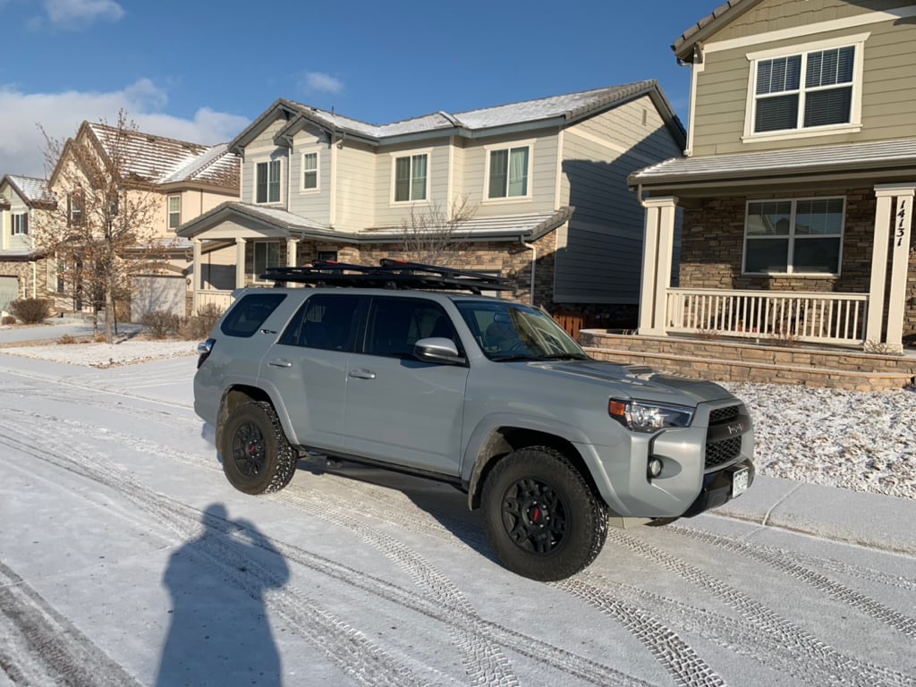

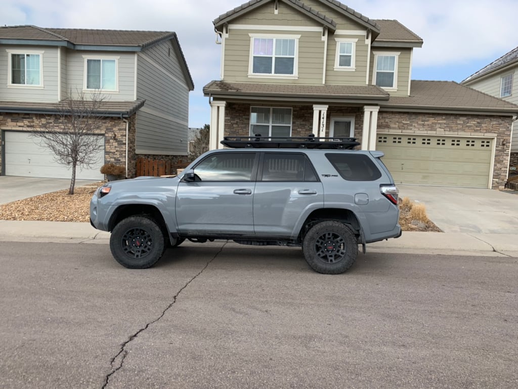

Today got 6112 coils put on my TRD Pro. This is what I got
Stock photos before the coil swap

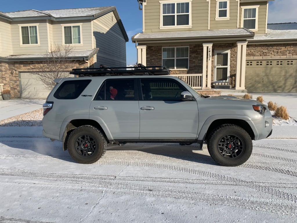

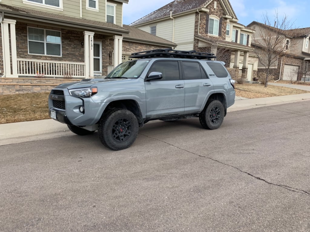

After coil swap
Received 2 inches of lift in the front from the coils over a stock trd pro. The back coils are wheeler t13. I did not expect to receive that much of a lift but it drives really smooth.

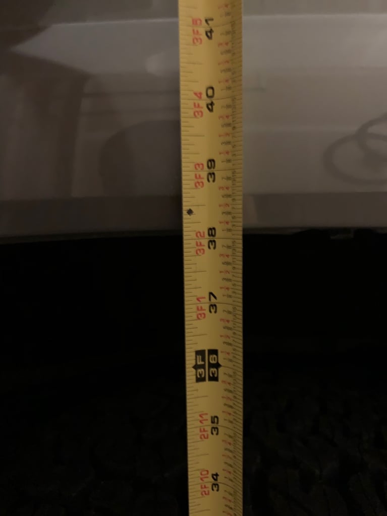

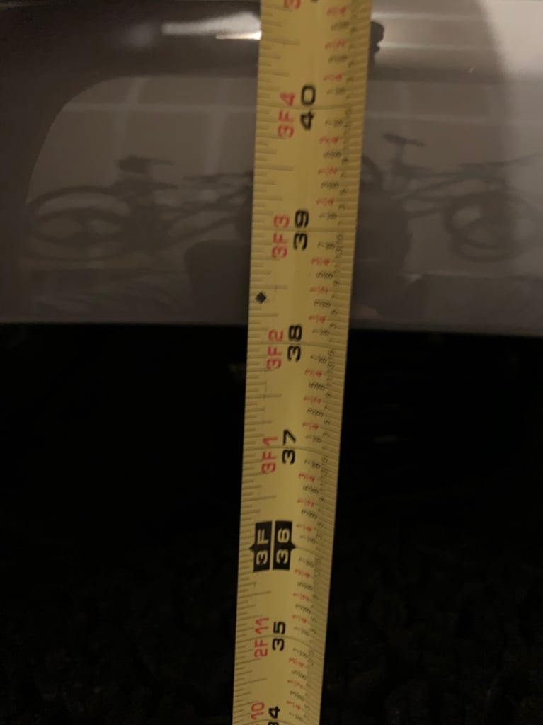

Measurements
Hey nice setup, I’m going this route. Do you mind posting the measurements from ground to fender and hub to fender?
I actually took some pictures of the measurements this morning from ground to fender. Dead even from front to back. I did not expect that.
Front pic
Rear pic
