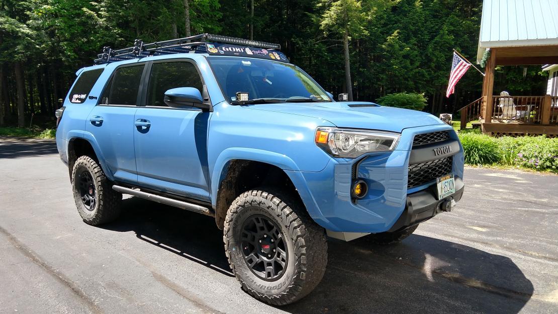

Over the weekend I had my Toytec spacer lift swapped out in favor for the 6112 coils. I gained about 1/2” lift in the front and have fallen in love with the feel of the truck now. It’s a more solid feel, much less nosedive under braking and less body roll through turns.
Pics to come!
Pics to come!

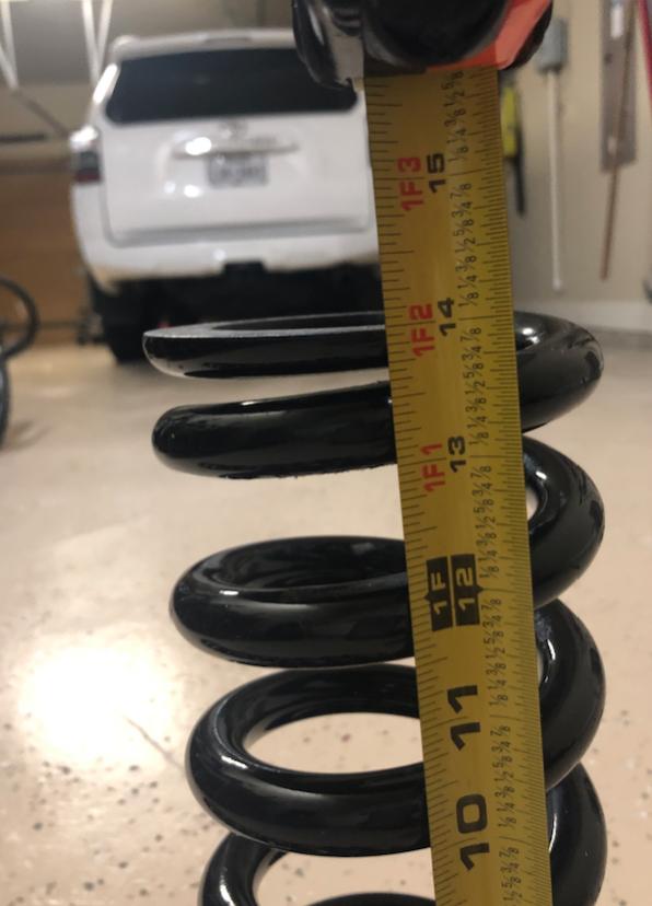

Anyone know where to find the 6112’s without the springs? I bought the TRD FJ Pro Kit last year when Toyota was clearing them out and would like to use those 14” TRD springs with the 4Runner shocks to raise the front more since I’ve settled.
Looking for some 600lb coils for my TRD pro suspension. Anyone have any leads?

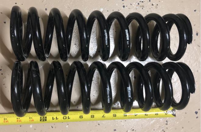

I have a used set in great condition for $100. I was looking to pair them with 6112s but I couldn't find the shocks separately so I'm going to pickup a new coilover kit and sell these coils instead. These are the 14", 600# Bilsteins. There are a few scratches but very clean and no rust. PM if you are interested. Thanks, Jason

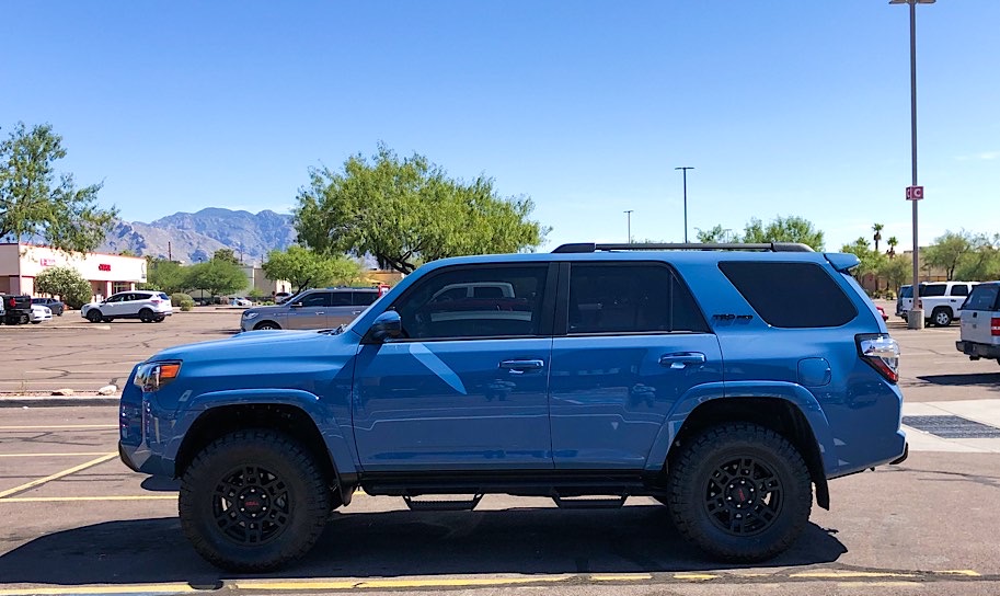

Picked up 6112 springs from @jrfordlandia and wheeler t13 for the rear.
Front is 23” from center of hub to fender, rear 23 3/8”. Drives great!
