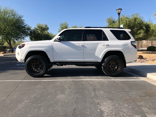

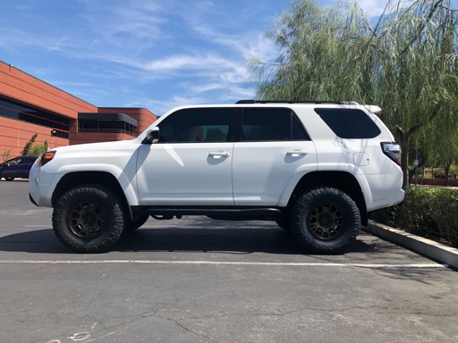

I’m using Bilstein rear coils. They are supposed to give 1-1.5” rear lift. My rear is sitting 1” higher than the front. Looks perfect to me. Running 285 Ridge Grapplers. On road has been great. Haven’t been off-road yet. No regrets here.
Nice, got pics?
Whoops thats not the pic I wanted to share. Different tires but same lift. Here is how she sits currently. Last pic was on 255/80r17’s

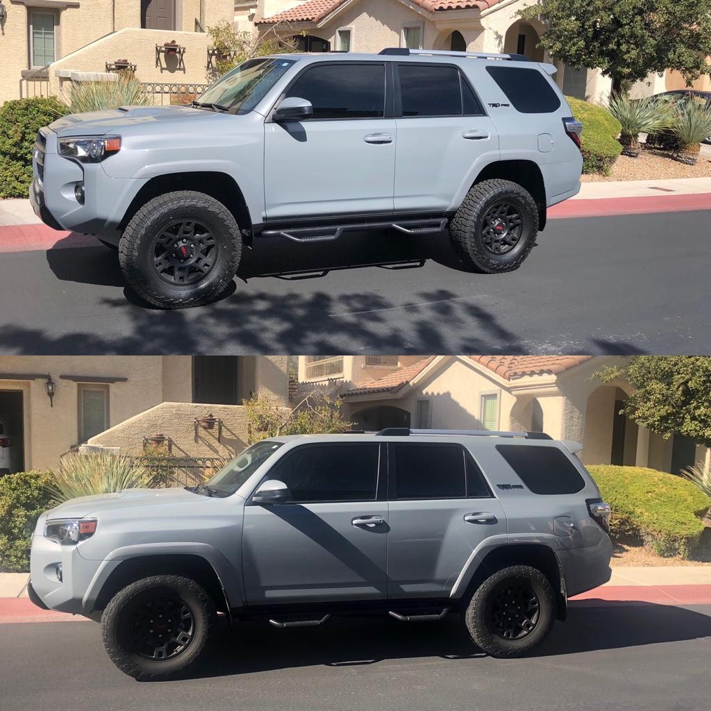

So I FINALLY pulled the trigger on this after having the 6112’s for over a year. I went with Icon 52700’s in the rear which give about 1.75” of actual lift. My measurements were rushed but it looks like I got 2.5” to the fender in the front and 2.25” to the fender in the rear when combined with 285’s. It’s been about a week and I love it. Far less nose dive and lean when cornering and it just looks better. My co-worker, who is an Tacoma overlander, said it now looks like someone told it to “grow a pair” and it did... in the pic, top is after and bottoms is stock.
Looks great. Have you gotten an alignment yet? Just curious if you'll require UCAs for caster. Any rubbing? I have 14" 650lb springs and T13s waiting to be installed on my '18 Pro.
Alignment done right away on stock UCA’s. Oh rub on full lock turning left when backing up.
