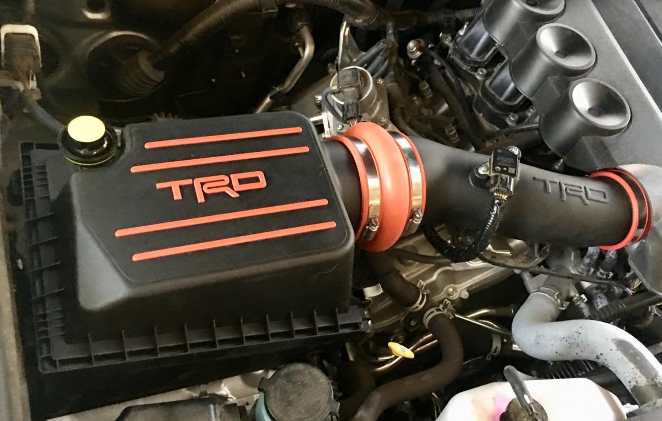

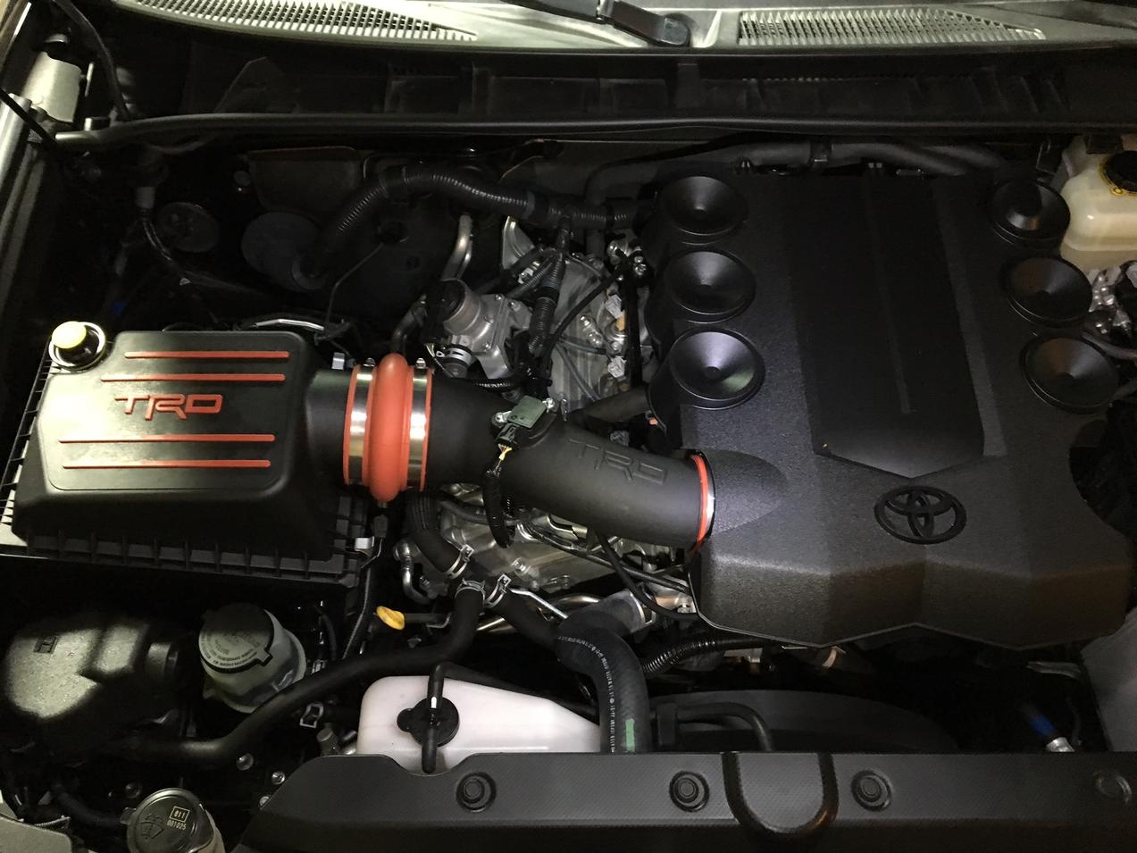

185976d1452059823-how-guide-trd-cai-installation-trd-cai-installed_02-jpg

Meh... Trd doesn't look like it will work. Maf sensor port would need a block off and it's the wrong bend. Maybe something else will pop up.

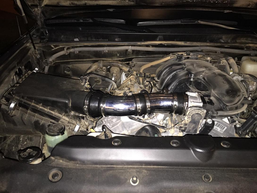

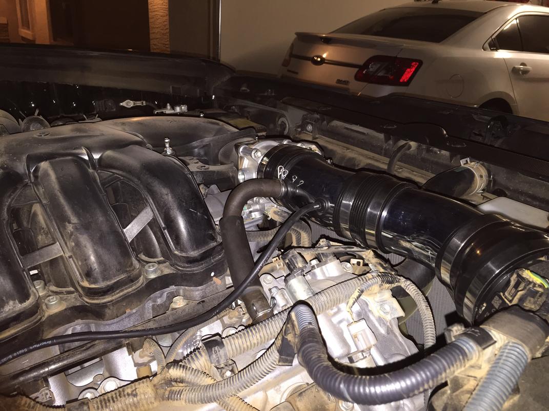

170325d1440481058-made-air-intake-image-jpg
170326d1440481516-made-air-intake-image-jpg
Debating going with the autozone specter kit and just painting the tubes black for an oem look...
Just buy the TRD parts separately. I bought everything for about $250 including a K&N filter

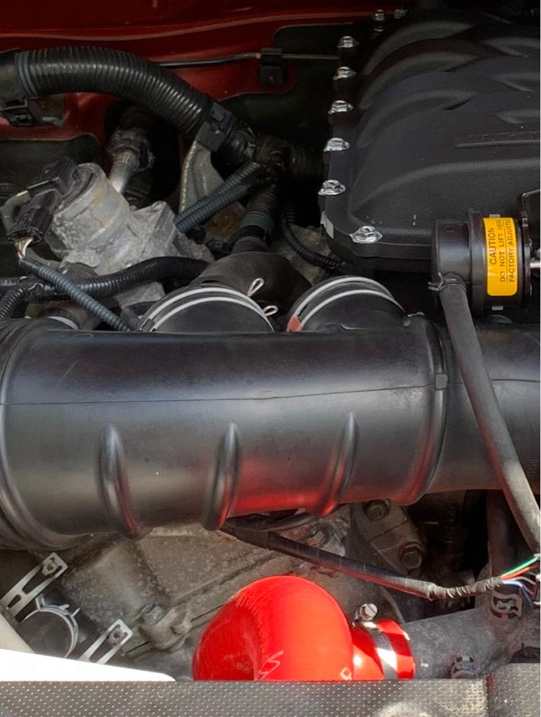

Here's what I found with today's revist.

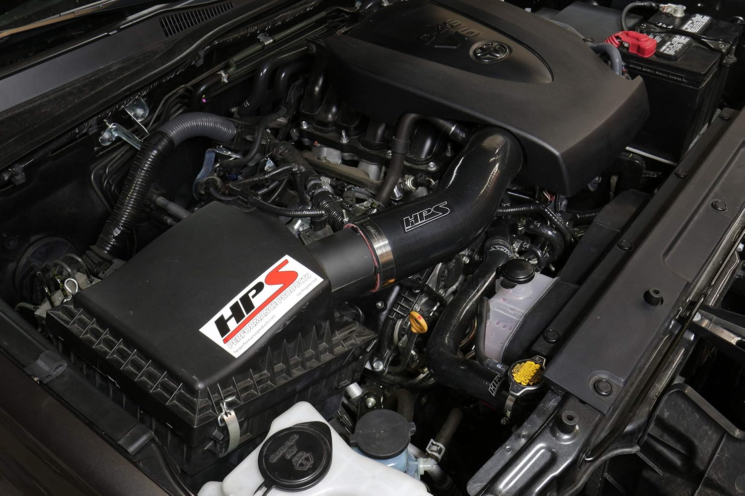

HPS makes a replacement pipe for the Taco.:
Taco Engine bay:

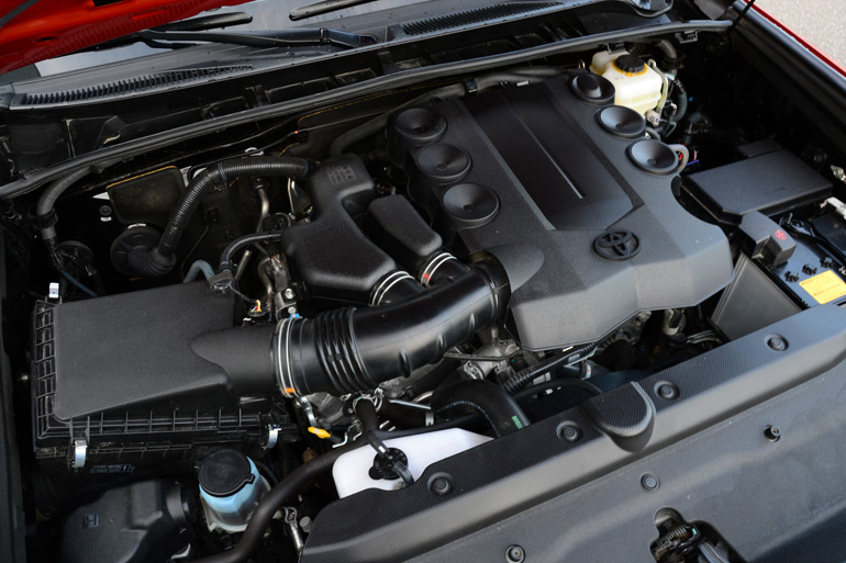

4runner engine bay :
Wondering if the oem pipes between the two truck are the same diameter or not.
Not crazy about what HPS is selling because I feel like it's about $100 over priced but it seems like a possibility at a glance.
