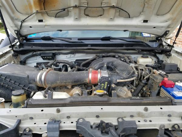

With a blower, engine cover is no longer needed and the intake baffles are eliminated. Magnuson supplies plugs with hose fittings on them to run the OEM hoses back to the intake tube.
With the stock airbox you will need a HPS 3.75" to 4.5" 4-ply silicon reducer coupler. A TRD CAI tube PTR03-89100-AA installed upside down and the TRD coupler and clamp hardware kit PTR03-89100-AB. You will require longer hoses sourced from the autoparts store as well. Aftermarket filter of your choice, I went with the dry aFe air filter.
I recommend a URD maf calibrator and maxbore.com trottle body bore job for the heck of it from the savings from not buying a complete TRD CAI kit.

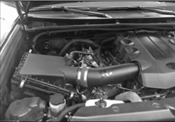

4Runner Intake Tube

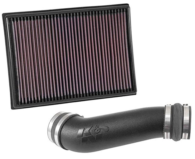

K&N sells a tube and filter kit K&N 57-9034. It's a tube only and a panel filter for the stock housing. Not sure if you can just get the tube.
Hello. Expanding upon the comment of trdgmn
... I wanted to lose the two windpipe growths (baffles, resonators, anti-resonators). But, I am just not appreciative of the TRD CAI bling. I wanted a plain vanilla pipe that retained a low-key appearance.
I just ordered the K&N 57-9034. It cost way more than it is worth. It was, however, the only stand-alone tube I could find. It mates up to the stock air box, and maintains the stock MAS position. It comes with an oiled K&N filter, which I will sell to recoup a few dollars.
I plan to pair it up with the TRD “intake flow accelerator” which replaces the plumbing between the air box and the fender. PN PTR03-34079.

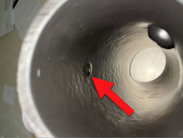

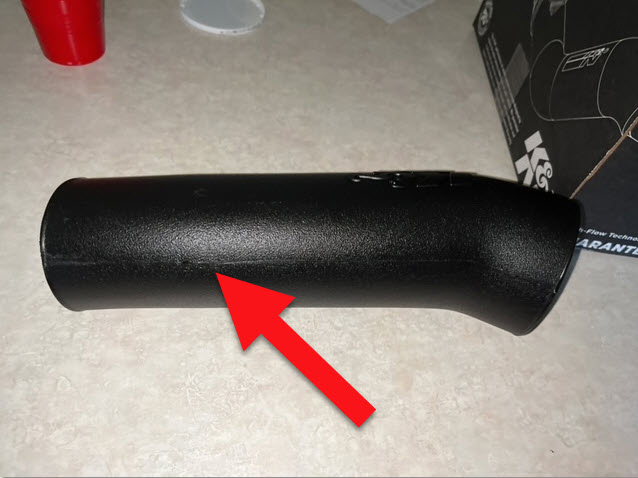

I received the tube today. Inspection revealed a "wart" on the inside. That wart lines up with a seam on the outside. It leaks ...substantially. K&N is sending a replacement.
