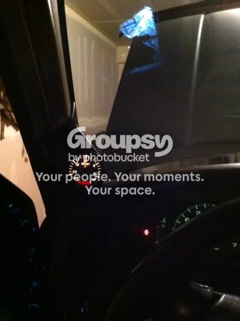

photo-1.jpg~original
photo credit A.Wilson013

Should look/sound like this =p
