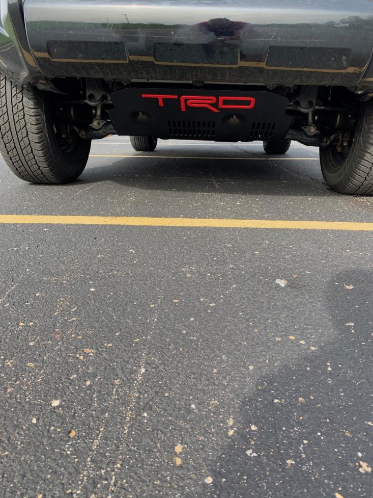

So I need up installing the TRD Skid that I received.
At some point, when the red letters break off I will order Tufskinz in matte black, but I was jut too damn excited to get it on!
PSA... good luck with getting ANY customer service from Bamwholesaleparts.com
They never answer the phone, call you back or respond to any emails. I will never be ordering from there again!
Installed pic:

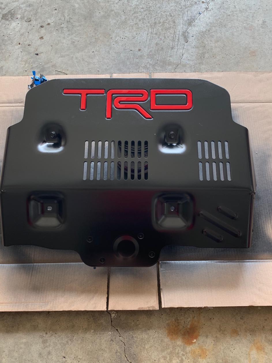

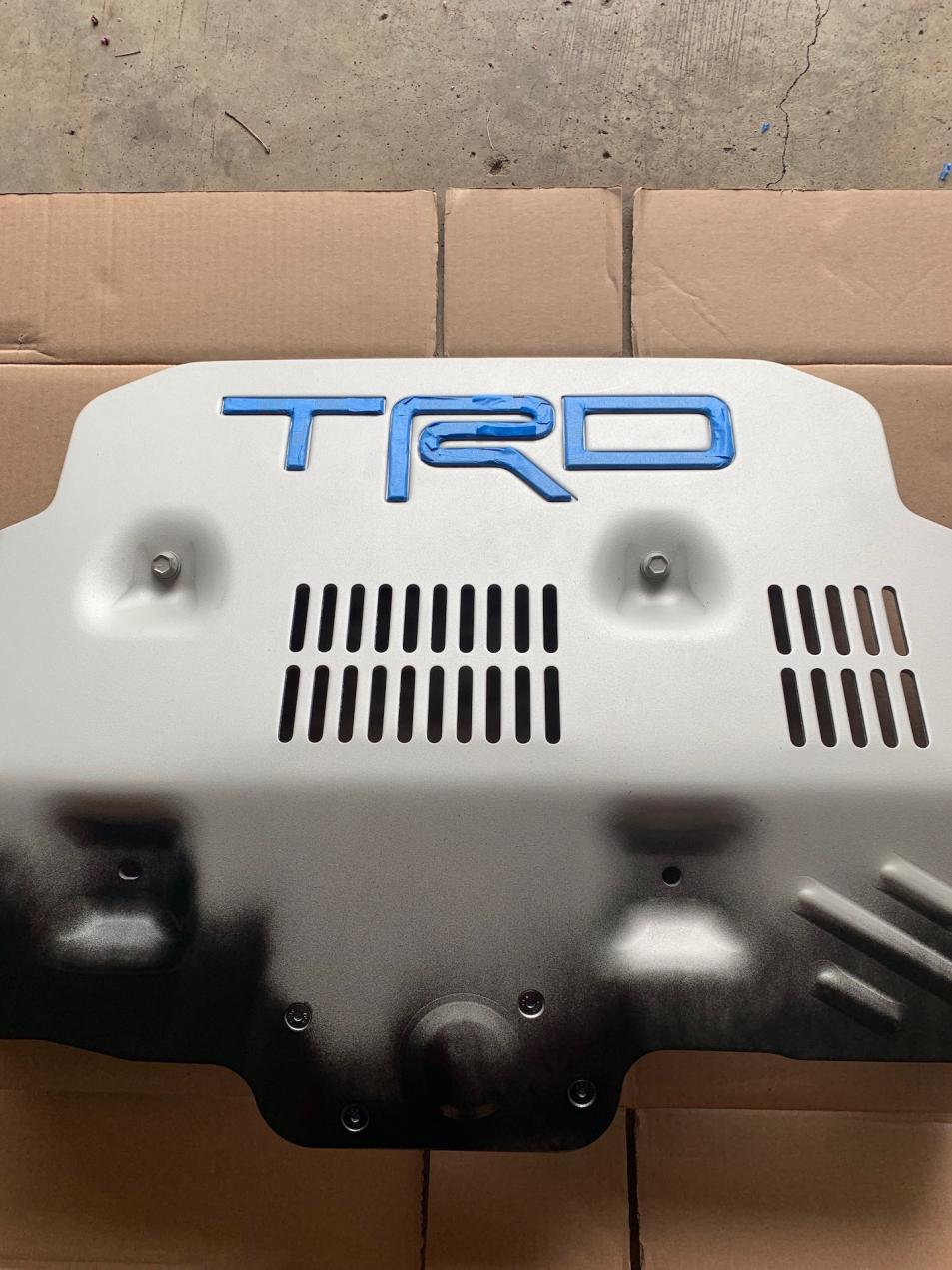

This morning I taped off the lettering and used satin black rustoleum on the skid plate. Turned out good

osugsxr, How many cotes did you do? You Mind showing a picture of the can you used? Thinking about doing the same and leaving the letters red.
Unable to upload a pic of the can but it was rustoleum satin black . I did two coats to make sure nothing was missed. As for taping Taking your time , I used an exacto knife to keep it clean .
I might try this with plasti-dip first as I can most likely just spray it on and peel off the letters after. Looks pretty damn nice either way. Mine should be here next week. I just never thought to paint it black. "I see a red door and I want to paint it black!..."
[MENTION=172349]osugsxr[/MENTION] that looks great! Now let's see a picture of it on your 4runner!

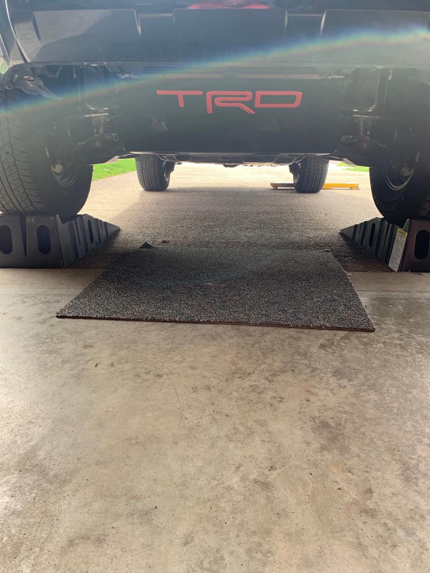

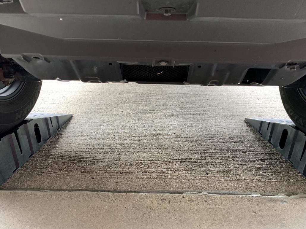

did the install this morning very straightforward. First pic shows I was missing a bolt on the left side and right side was almost out from a previous dealer service. It is luck of the draw on who you get at the dealer for service, not too concerned about it.
Install took about 30 minutes taking my time. I did rethread the holes with a 10mm x 1.25 tap. After I did this the bolts went in without issue plus I used anti seize. I tried tightening them first without rethreading but didnt go in as far. I do need a car wash sometime soon!
