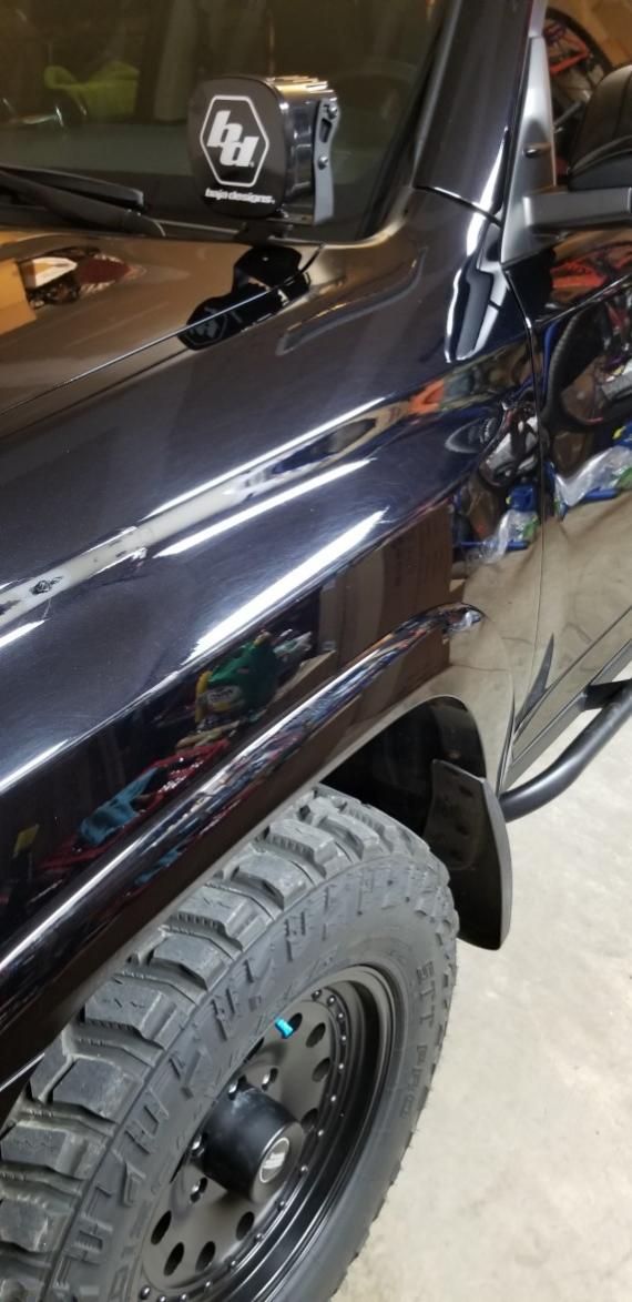

I have removed the 20s a few weeks after getting it on one of my Limiteds. Now I only run the following on one limited, the other limited stays stock with 20s and XREAS still so comparisons are easy.
MT Cooper ST Pros 265-70-17 8 inch wheel 40psi-42psi C rated
AT BFG K02 265-70-17 8.5 inch wheel 40 psi E rated
Snows Blizzak DMV2 265-70-17 P rated 32psi
XREAs is an interesting system but like most all in one systems its generally ok on most stuff but never really shines on anything either. I ripped it out and went with Kings, which have been far smoother in comparison, even when valves are set on stiff.
