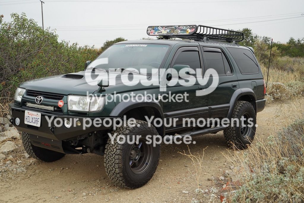

Hey Guys so lately i have noticed a decline in my mpg in a big number.
i used to get about 250mile out of about 3/4 of a tank of gas in the 4runner but. recently i have droped a wopping 100 miles on the tank netting me only about 150 miles per 3/4 tank. i have not changed anything on the 4runner since the mileage decrease. this is a list of mods i have on the 4ruuner which have not changed and a list of mantinance items i have done since i noticed the milage drop. 243k miles on motor.
mods
TRD Supercharger
Doug thorley headers
afe intake
mandrel bent 2.5" exhaust system
urd 7th injector kit w/ 170 thermostat did not swap out to the walbro supplied pump as i am not runnig a smaller pulley for more boost.
urd lightweight crankshaft pulley using the kit as is out of the box from URD.
maintence since mileage loss
fuel filter
cleaned air filter
new plugs went from ik22 to ngk BCPR7ET's ( could this be what is affecting my mileage? these were used on 4wheeler.coms article)
MaF Cleaned out.
i hate loosing sleep over this as i drive this vehicle 60+ miles a day and 7 days a week. i just want my MPG back.
