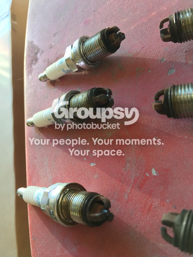

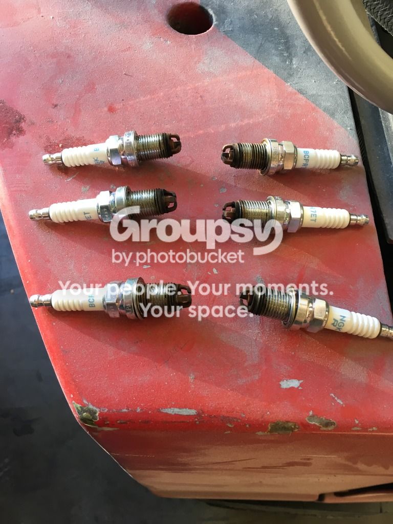

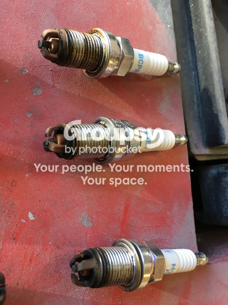

no exhaust leaksor such. just poped the ik22's back in the 4runner. ill post pics of the NGK BCPR7ET's tonight.
Here are the shots of the ngk's
Here are all 6 plugs left ones are passenger side right ones driver
FCD6DC33-85A5-433C-AEA6-3DF1A1BC9730.jpg~original
Top to bottom cylinders 5,3,1

Top to bottom cylinders 6,4,2
