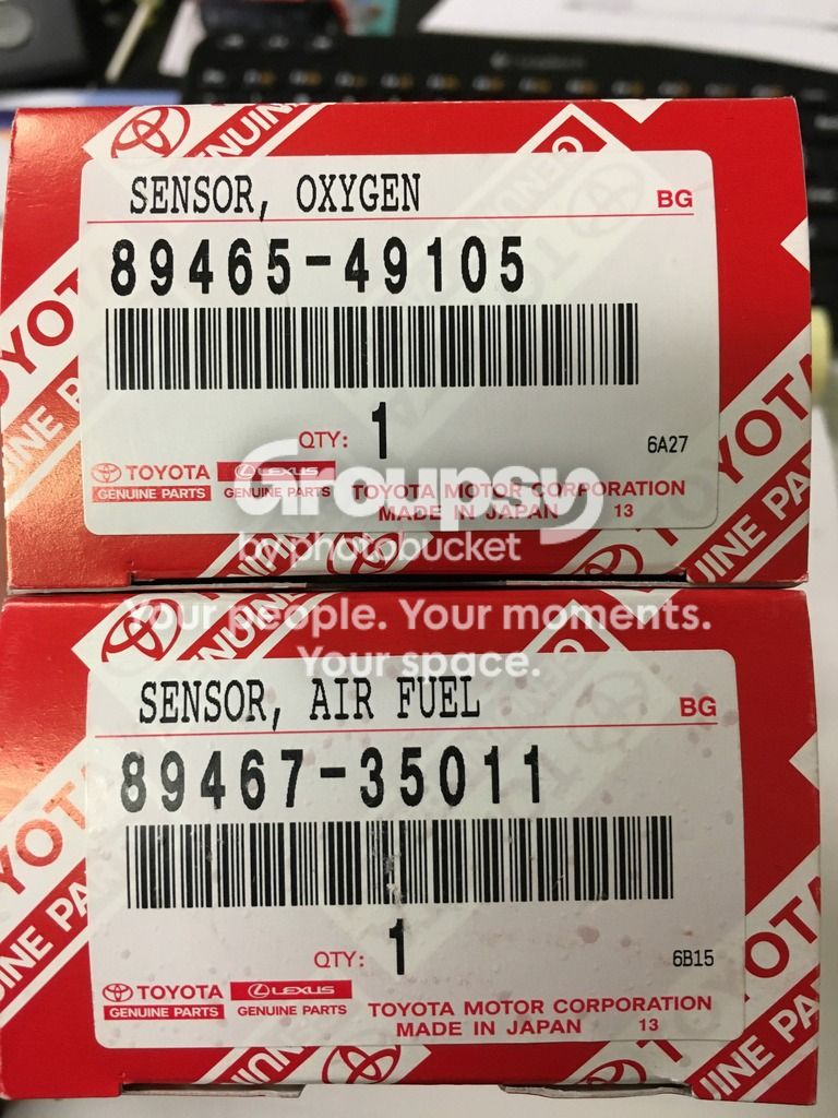

So here is an update I was sold the wrong a/f sensor by the local Toyota dealer the a/f. Sensor ending in 35060 wa a little short for my truck and I had to take it back for the correct ones. Replaced them both today and reset the ecu by pulling the efi fuse for about 15 mins.

Make sure to all of you that replace your sensors to buy the gaskets as the sensors do not come with them. Also the oem gaskets look much more durable vs. the aftermarket denso gaskets that were given with the cheaper denso replacement I had replaced my original oem ones with a few years ago. I just filled up a full tank on the way home and will keep an eye on my mileage with the 4runner. I'll report back after 2 solid fill ups with these new sensors.
Interesting, I didn't know this. I replaced both sensors with denso awhile back but didn't pay attention to the gaskets.
Gaskets were junk. And crumbled after I took them off the oem gaskets look more robust and are aluminum with paper element.
