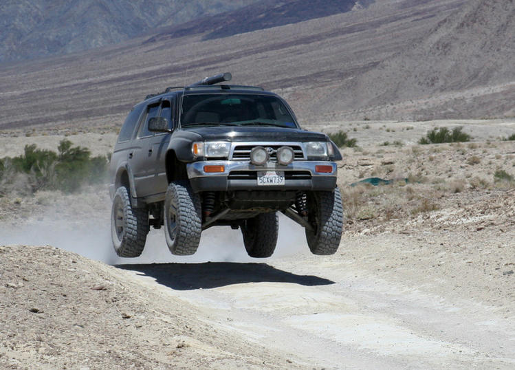

Like I said, if its actual long travel with some work in it, cool. But if its a spacer lift made to look like long travel, hella-homo.
In Southern CA the nose high look comes from REAL Prerunners that try to keep the weight in the rear so that the front float over bumps when you're hauling a$$ through the desert.
That being said, I don't expect most people from other areas of the country to understand the "look" of a Prerunner. SoCal's the minority when it comes to this "fad", but the Baja 1000 might be something you might want to google to understand why the nose high lifts are rampant around these parts (not such a fad around here, that race has been around long before 4runners were ever made). I personally think it looks better on a truck than a 4runner because it makes a 4runner look like it has saggy a$$ syndrome, but that's coming from someone who's owned a couple long travel caged Toyota prerunner trucks.
I also don't like an excessive stink bug rake, and only think it's necessary of you're hauling loads. The rear should be no more than 1" higher than the front otherwise it is just as equally for aesthetics as the nose high look.

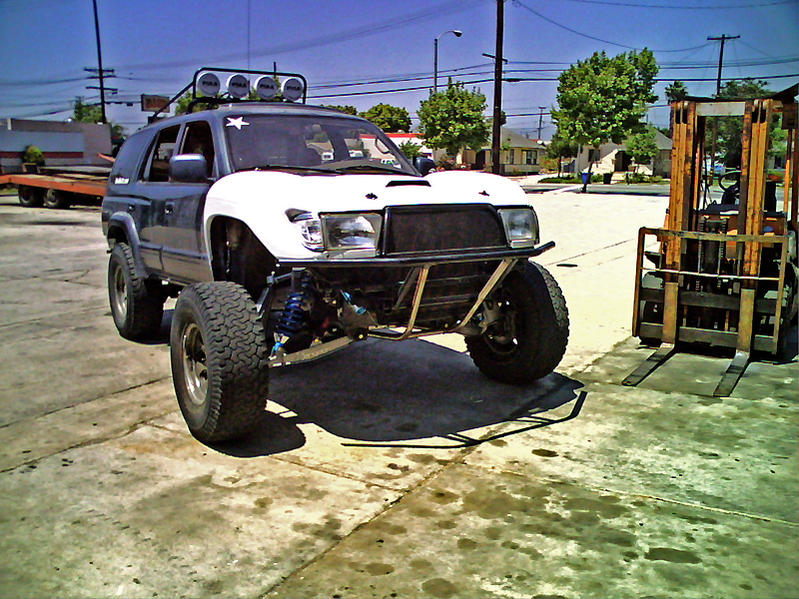

Haha yeah i guess i can see how you guys cant grasp the concept in the mountains **** yall have run offs just for when you get going to fast...well no spacers for me, actually to be honest I left my front up a little bc I was going to get a shrockworks front bumper (see told you I liked you rig RIP) and I am in houston so I was trying to save on shipping. How much does that thing weigh btw? you get any extra sag in the front? Anywho decided a diffferent direction and I will be taking the 4runner in before i head out to my next rig for a month...im taking it into a fab place called Gas Pedal Industries to get my bumper want a prerunner style but never found a bolt on i liked, especially those bolt ons by baja bumpers looks like a dinner plate got stuck on the front while driving down the highway IMO. But I completely agree that some can be overkill...oh and about the SA bombing thru the desert you ever see those JeepSpeed guys its all SA cherokees doin exactly that pretty cool (used to have a cherokee myself) now some can be overkill IMO for instance, this looks flockin stupid wide

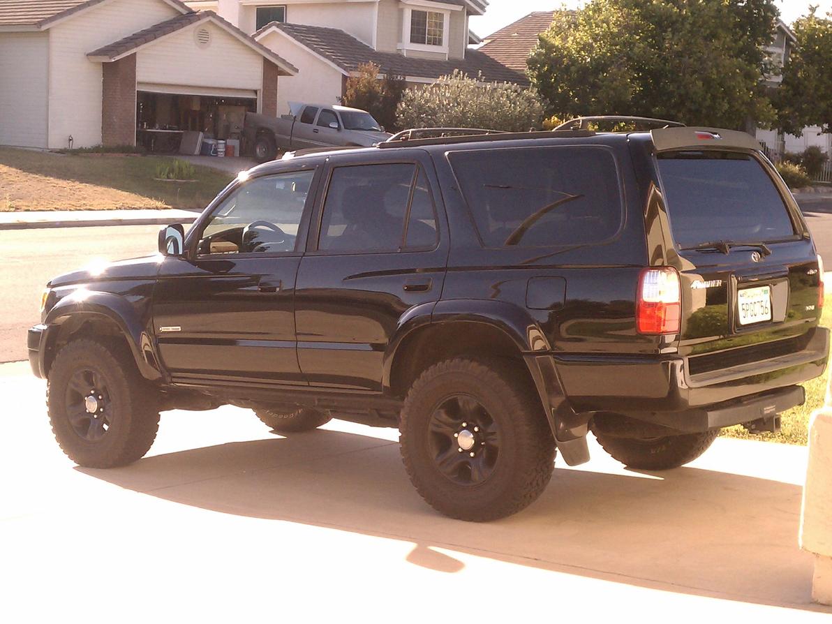

Just thought I would throw up a recent pic and troll for a few opinions. As you can see the rear is now higher than the front by about a 1/2. So I am looking to get the front up a little more.:banana: So just some opinions on either 3/8 top plate spacer or 5100 on the second notch.

Pretty sweet stuff! I like your wheels, and your 4runner looks very clean as well! I'm currently piecing together my lift kit. I have LC 7.5 wraps on the way thanks to crumpkd. I'm going to buy some new Tundra TRD front coils, front Bilstein 5100's, and some Tokico Trekmaster shocks for the rear. You ought to start a build thread.
That looks real clean. I like the rake as is so i gotta ask what the set up is in this pic. Is this with the TRD tundra coils in back? What did it take to install um.
I noticed an improvement in the ride when i got my 510s. If you can swing the 5100s i'd go that route instead of a spacer.
No, TRD springs up front. I went with 99 tall springs and a 1" aluminum spacer in the rear along with the tundra bilstein/toyota shocks. Rides real nice with this set up
