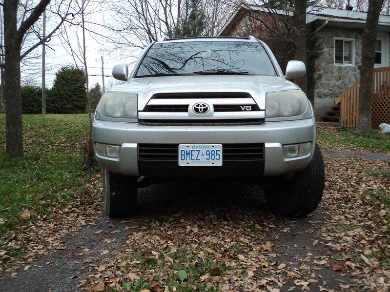

Well I finally figured it was time to a build thread. I wouldn't quite call my truck "built" yet but over the past year of ownership I've done a few modifications even though I don't tend to document well, I'll post the pictures I have.
Start:
Now:
Current Setup, as of 12/10/28:
Wheels/Tires/Suspension:
-FJ Crusier 17 rims w/ 265/70/17 Yokohama Geolander I-T GO72
Front:
-Bilstein 5100's set @ 1.75 w/ 1" top spacer
Rear:
-Bilstein 5100's w/ factory air suspension adjusted for lift

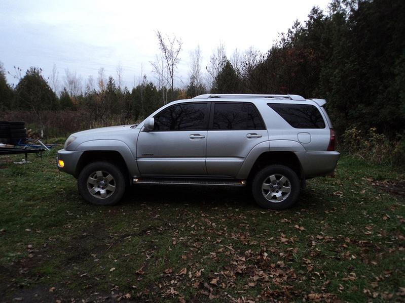

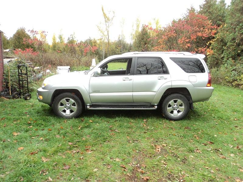

Stock:
Now:
Front Measurements: Stock / Now
Center Hub to Fender....... ? / 22.5"
Ground to Fender.... 33.125" / 36.75"
Ground to front skid plate 9" / 12.25"
Rear measures vary with my wonky RAS so I didn't both with them. I currently have it set to about 3/4"-1" rake.

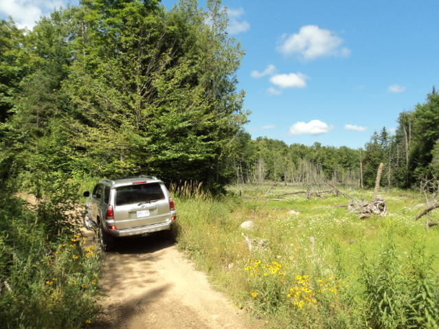

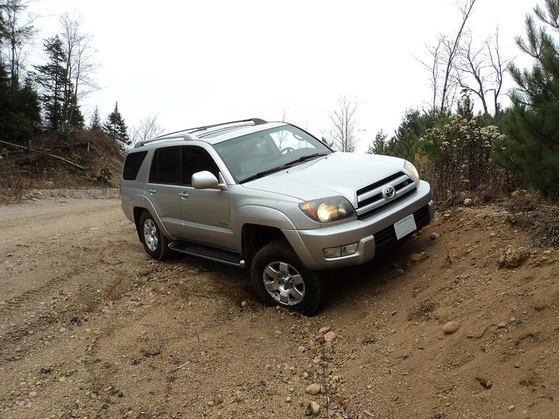

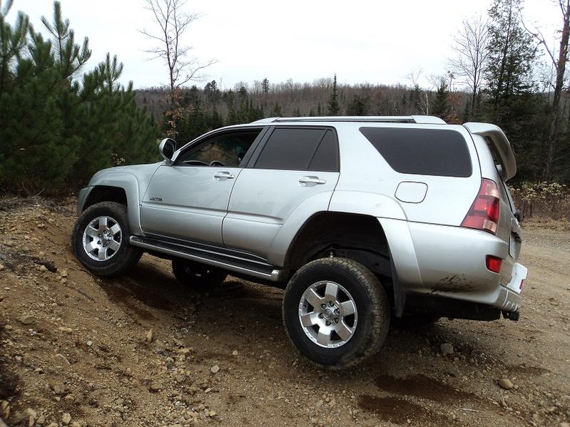

Logging road with some fun spots I like to go to

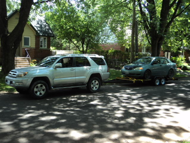

Towing a 2005 Corolla on my 14ft flatbed

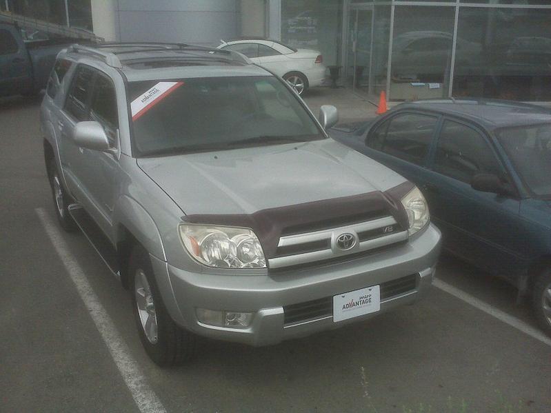

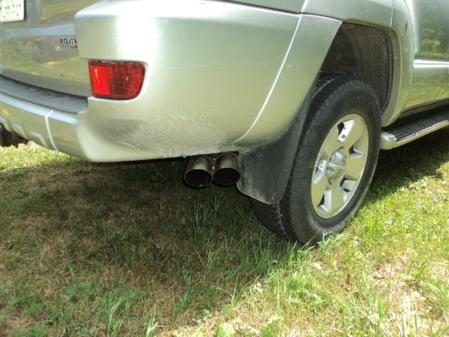

-Dual Exhaust

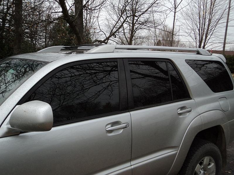

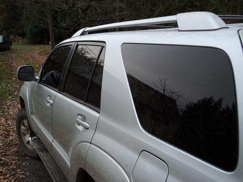

-Tint: 20% Front, 35% over factory tint

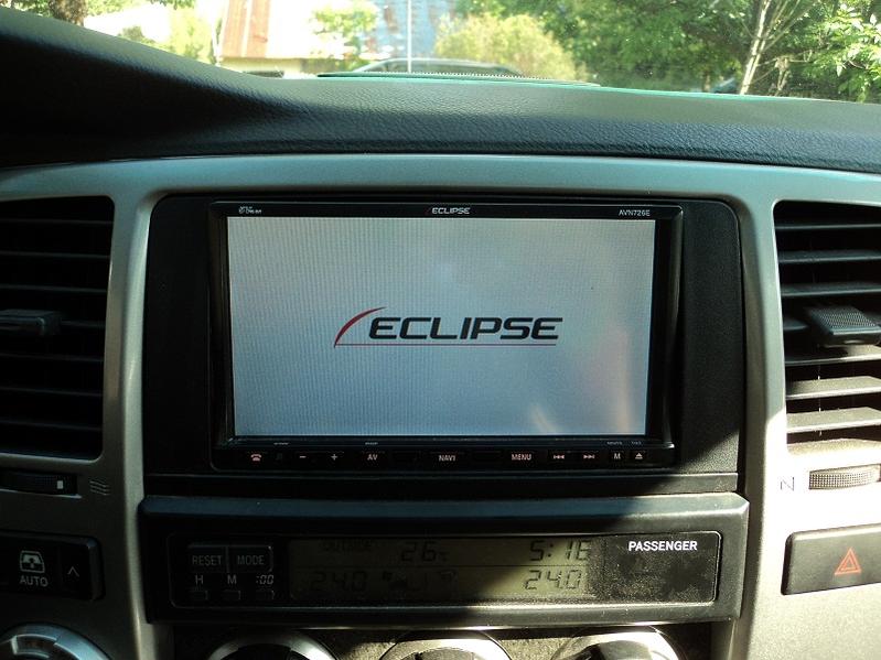

Interior:
-Eclipse Nav

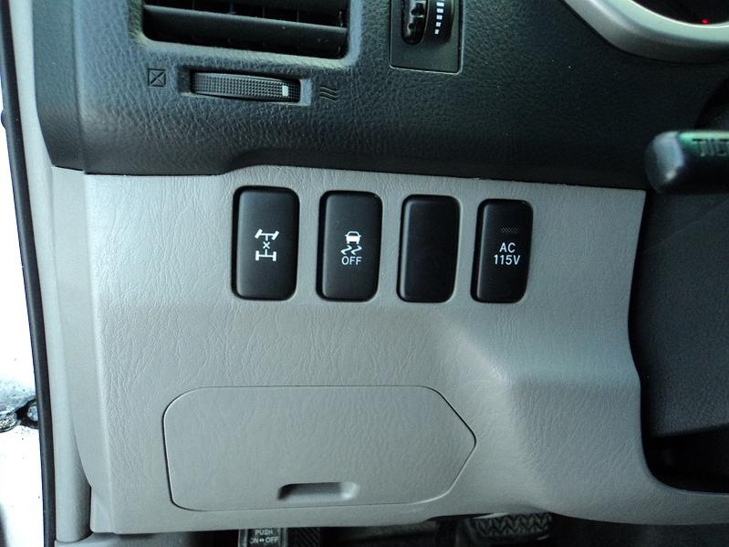

-VSC off mod

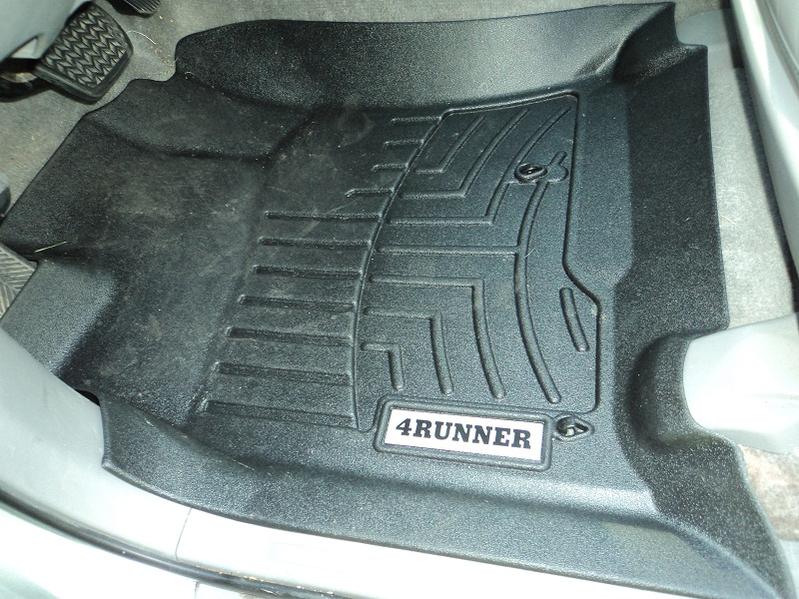

-Modified WeatherTechs

http://www.toyota-4runner.org/perfo...rs-more/103962-klivs-vsc-off-mod-v8s-too.html

Looks good! What percent tint do you have?
In the front its 20%. The back its 35% ontop of the factory 20% which makes it fairly dark and hard for others to see what you have in the back.
I like it but the 20% in the front is alittle too dark for the :police:. Everyone around here has it tho so I'm testing my luck.

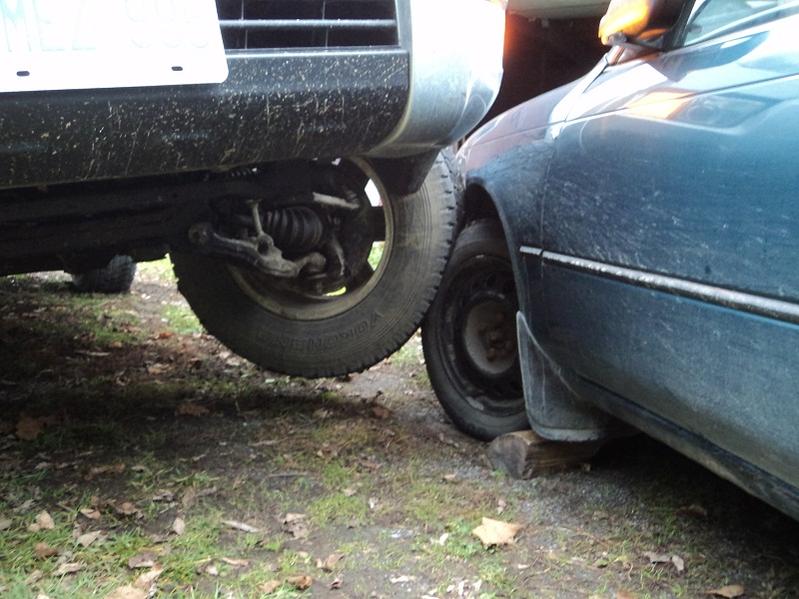

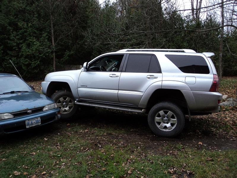

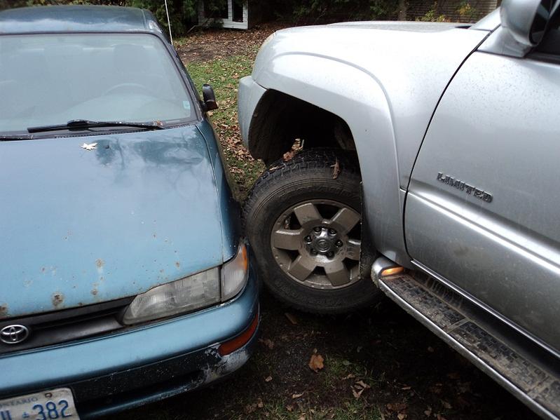

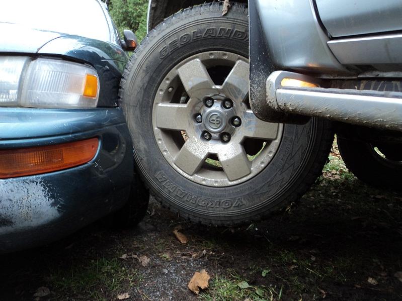

I'm not gonna lie though, it'd really spice it up if you had pics of it crawled up and flexed out on someone's tire.
LOL, well it just so happens I almost ran over a Corolla the other day :D
