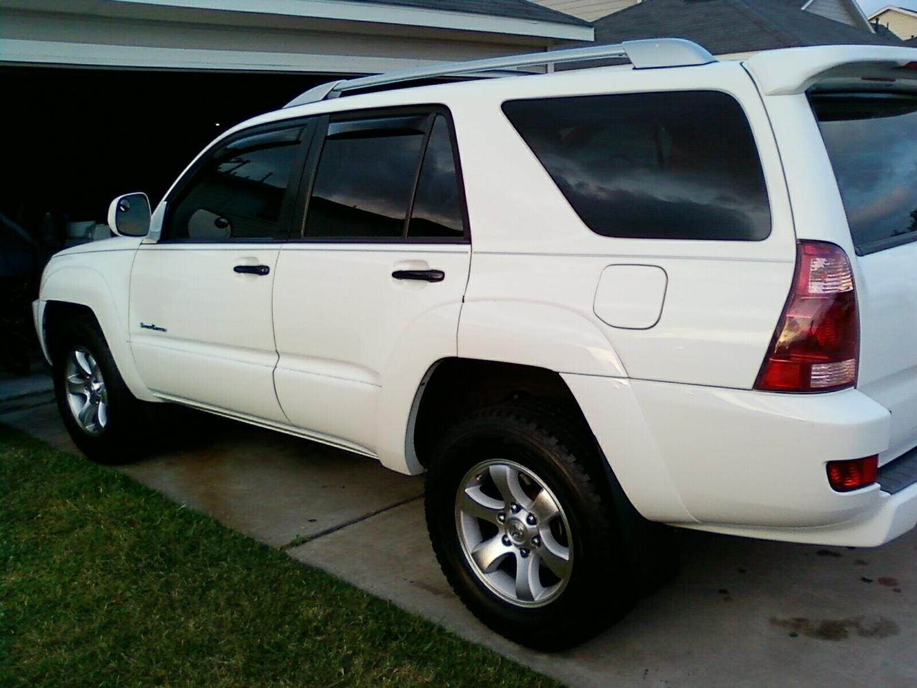

Hey, how did you go about painting your door handles? I think they look awesome painted black and I want to do this on my white 4runner, just can't think of an easy way to do it. If you could tell me your technique it would be greatly appreciated.
i removed them off of the doors, that way i could paint all of it. it was fairly easy. the front driver and pass handles come off with just a few screws. and the rears you have to take the door panel off and remove them from inside the door.
as for paint i used krylon fusion satin black, and then a simple clear coat.
if you choose to go the route of removing them before painting i can make a how to video if needed. some people just mask off the areas and paint them while still on the truck. i just dont trust overspray so i dont do it that way.
Cool, thanks for the info. I will prob try it sometime this week, sounds easy enough. So you can take of the front door handles w/o removing the inner door panel?
the front driver and passanger yes. the rear driver and pass the inside door panel has to be removed to get to the bolt. here are the links i followed to do it.
first How To: Swapping black door handles for color matched versions (info & pics) - Toyota Nation Forum : Toyota Car and Truck Forums
and since thats on a tacoma, theres an addition here
http://www.toyota-4runner.org/4th-gen-t4rs/47513-removing-exterior-door-handles.html#post399767
also, i made a video on how to remove the rear door panels, so here that is for the heck of it.
Awesome! Thanks for the info!
And good vid btw, I've taken the door panels off plenty of times to do speaker work, but I could never get the door handle cables detached so I always had to hang the panel on something close to the door and it was extremely obnoxious lol. Know I can remove it all the way next time I'm messin' around down there
Finally got around to painting the handles and I love how they look! Thanks for the help!
