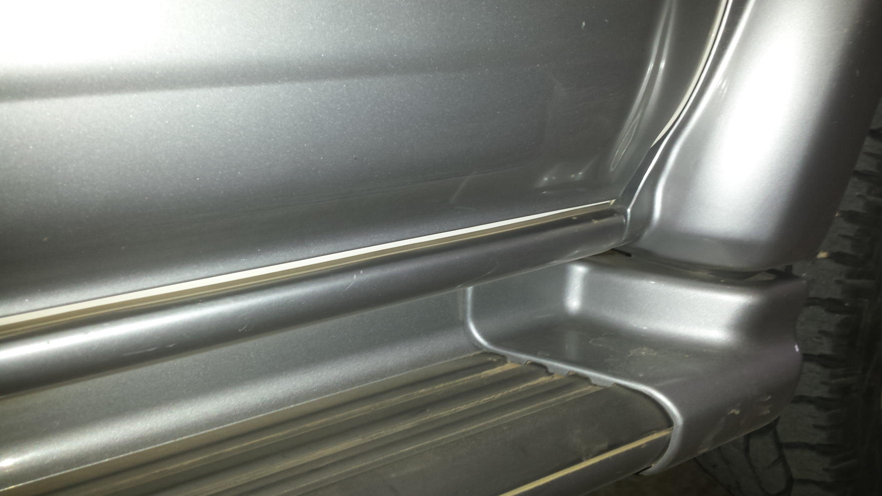

Anyone know the toyota part # for the clips that hold the rocker panel cladding on a 96 limited? Been looking at parts diagrams but most aren't very clear.It's the one right above the running board on the pass side 20181105_152430.jpg

I saw that diagram but these are for the piece that runs the whole length under the doors right above the running board.
has anyone removed the cladding on the rocker panel? I'm planning to remove the cladding to inspect for rust and also to replace the moulding that has already degraded. I'd like to know which parts have a good chance of breaking and need back-up parts.
[MENTION=198376]4Runner4Leon[/MENTION] I've read through that write up a couple times, but don't recall ever seeing him describe how to take off the rocker panel cover below the door sill. I think it's just a bolt at each end and trim screws underneath. Any help here?
Edit: Nevermind. I found it after rereading it again. I was looking for pictures. Oops!
"On to the rocker panel. The easy panel. On the bottom it has 7 plastic screw rivets. Lefty loosey righty tighty. The rocker has two exterior mounted bolts one mounted vertically near he rear door and one mounter horizontally under the front door. Unscrew them. Be prepared to break clips here. Start from the font of the vehicle and pry the rocker guard OUT from the vehicle and slightly down. The plastic rivets on the bottom will give you hell but trust me. Your goal is to get the rocker out and of the guide bracket."
