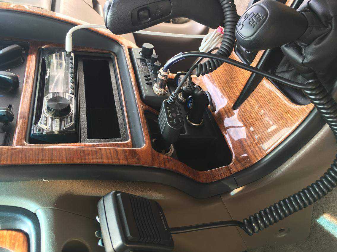

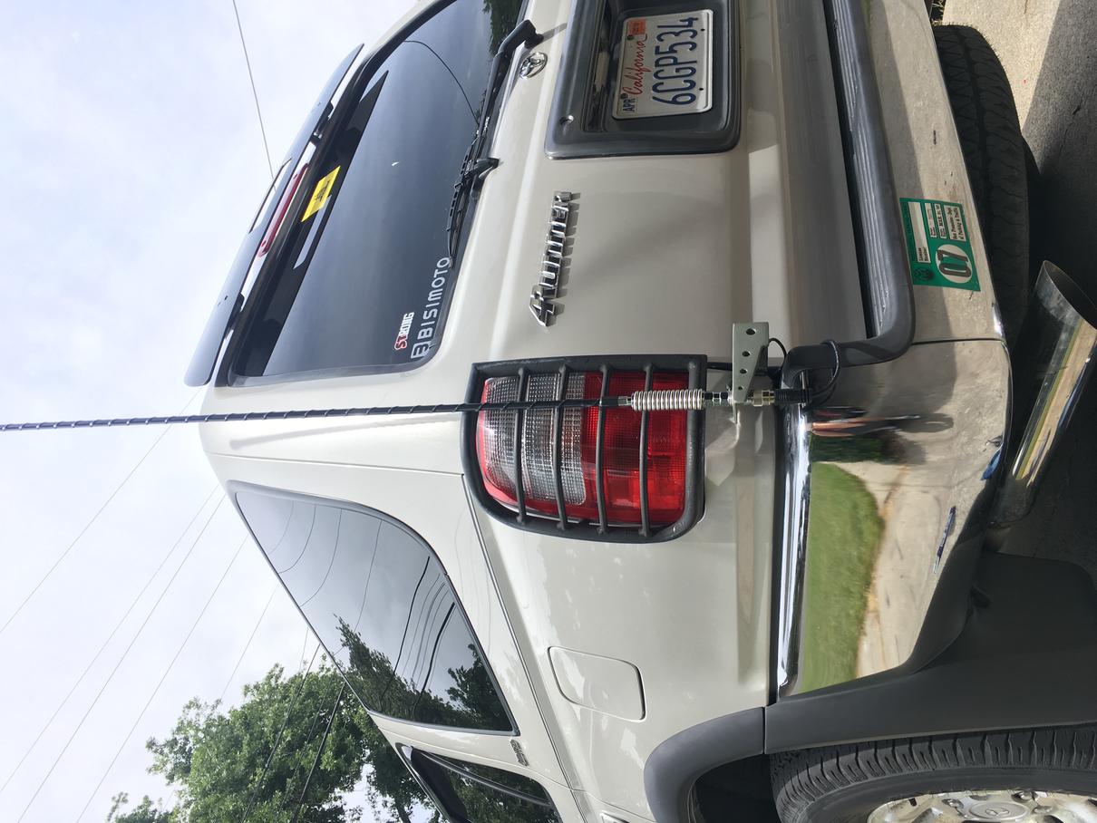

Got my windows tinted as well. 15% in the back (+ factory) and 50% in the front. Also installed my CB an antenna, just have to tune it. Might have to redesign my mount as I think it has a little to much horizontal play.
